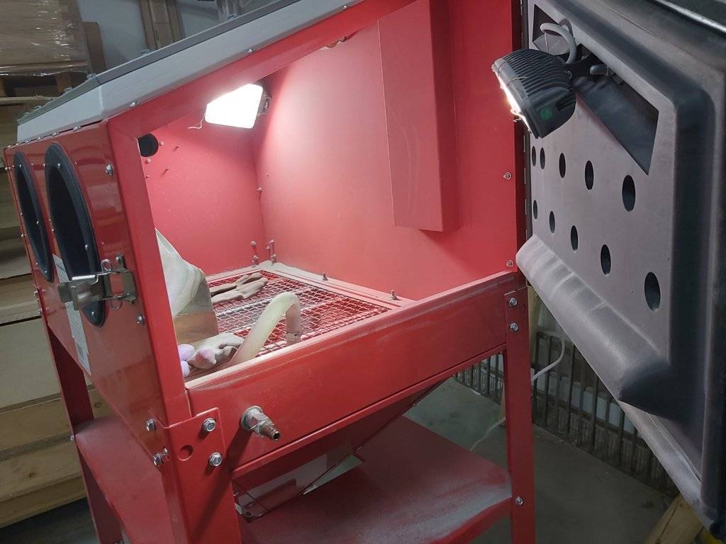

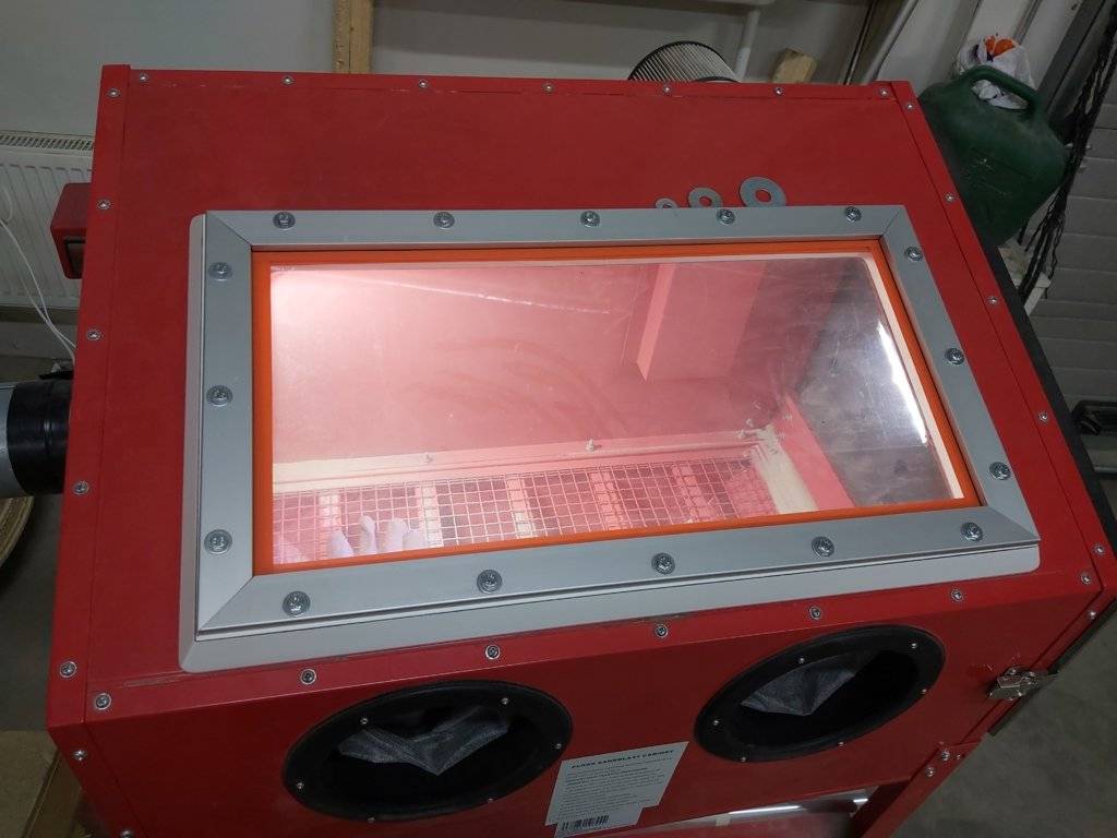

Got this one from a friend for a 100 euros.

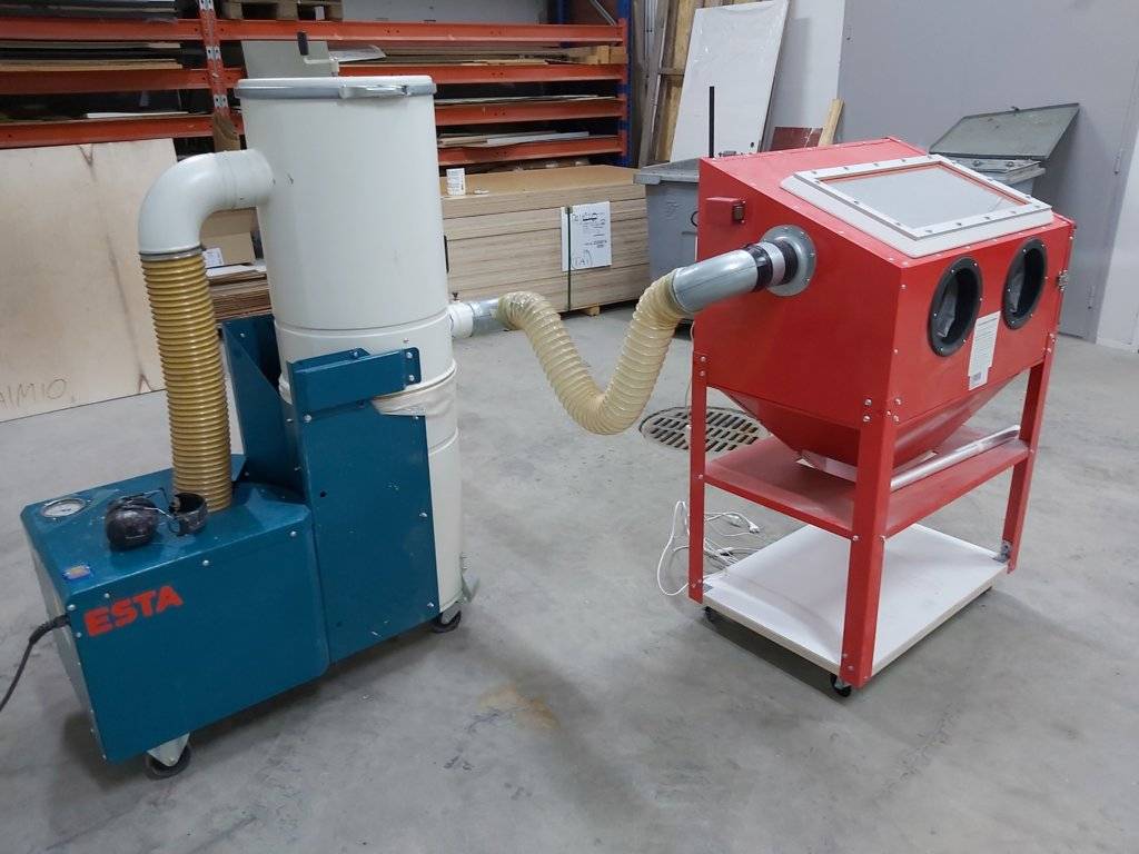

First thing to do was a new window frame out of thick birch plywood, new working lights, connections for filter unit, make it movable with a casters...and so on.

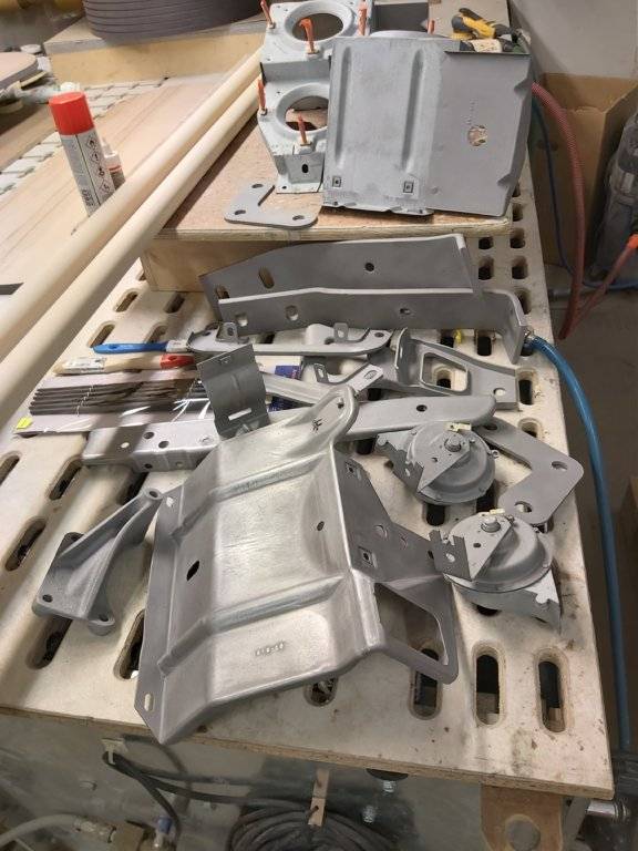

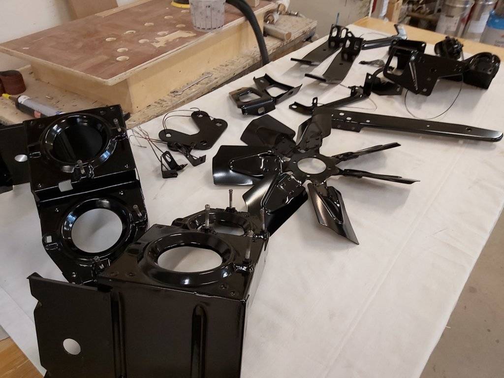

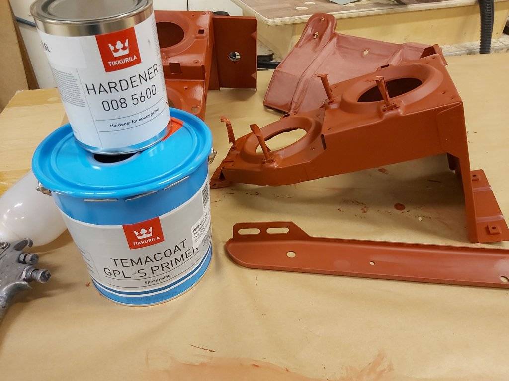

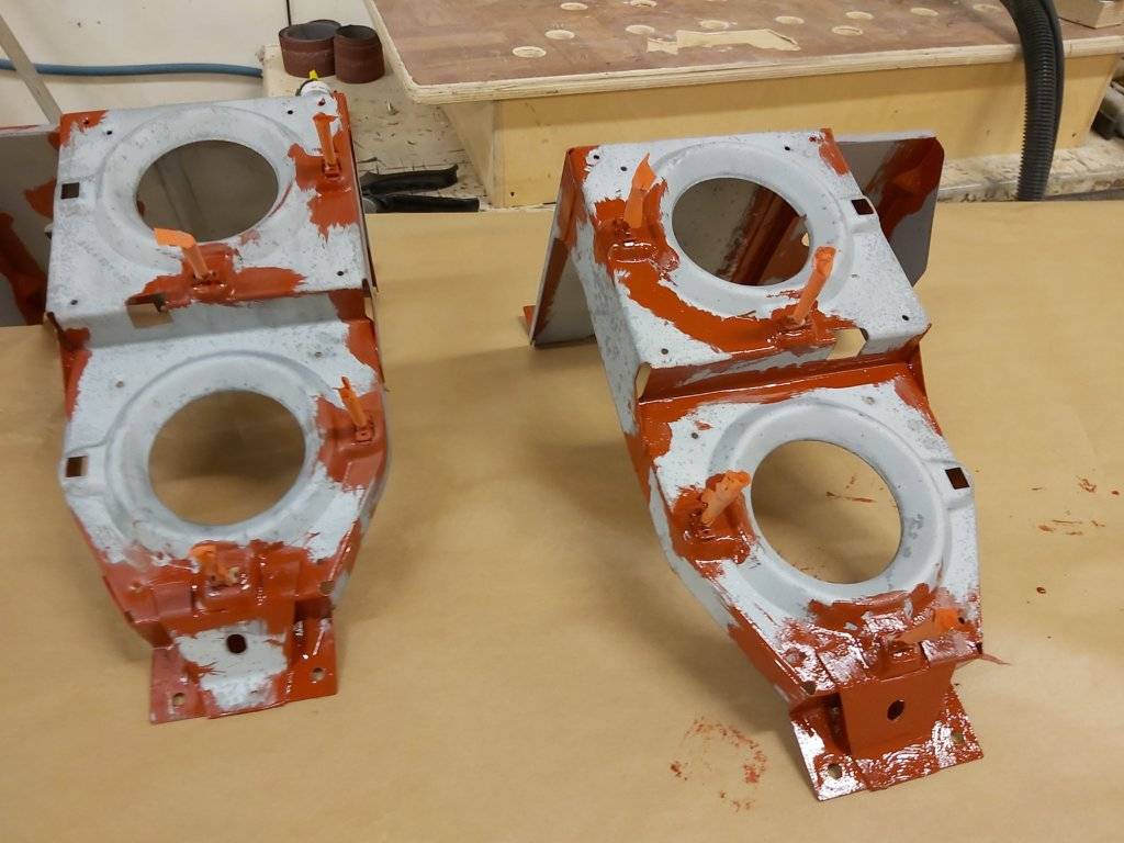

But now it's working just fine! I blasted some parts for Baron, painted them with epoxy primer and with a semi gloss 2k PU-paint. I paint them first whit a red epoxy ( no gray primer on sandblasted metal ,all corners and difficult spots first whit a brush..) and then with a black, now I know that there's good layer of primer everywhere and then top coat.
Luckily I had that filter unit already. Regards,
Mika View attachment 336830

Mika View attachment 336830 View attachment 336836 View attachment 336839 View attachment 336840 View attachment 336841 View attachment 336843 View attachment 336845
Wow! For a cheap cabinet, that one sure looks nice. Looks like the filter unit probably cost more than the blast cabinet.
This is what I did with mine. The two you-tube videos outline some cheap improvements... Making the floor a little deeper was one, but the big one was the adding the metering valve at the bottom of the cabinet. I only use a couple cups of media in the blaster now. Makes it a LOT easier to change.

Thanks John, good ideas! I need to add that metering valve to my system too.
Mika
I would also be looking at a finer / sturdier floor screen also. Small studs and sharp corners have a tendency to get stuck in the floor.
