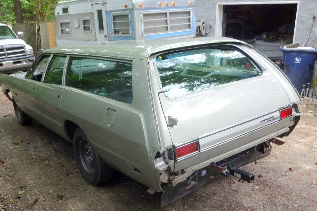

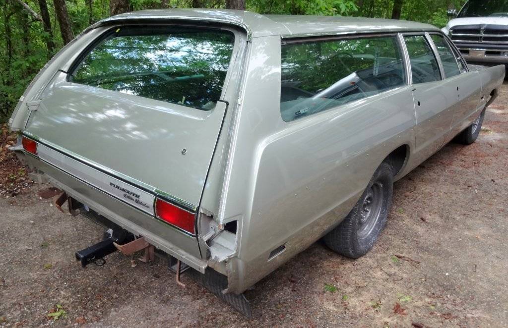

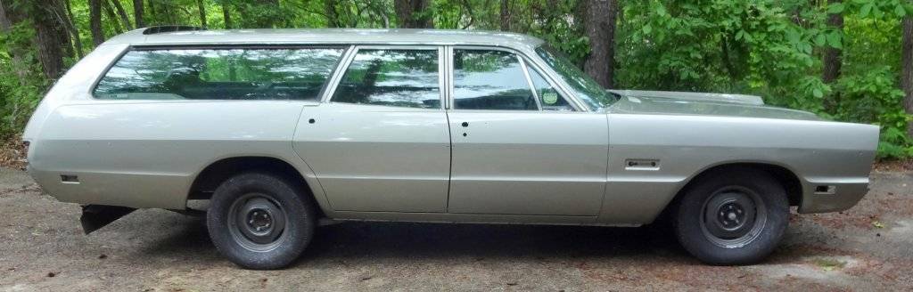

The Admiral is home with a new coat of paint. He looks great. There are a couple of minor flaws that will probably go away when he's cut & buffed in a couple of months. But I came in under 4K for the job including materials.
Very happy. NOW........ I have to detail & reassemble in time to hit the road on the 14th

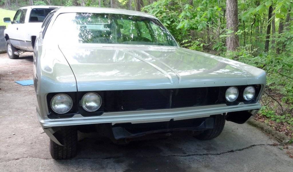

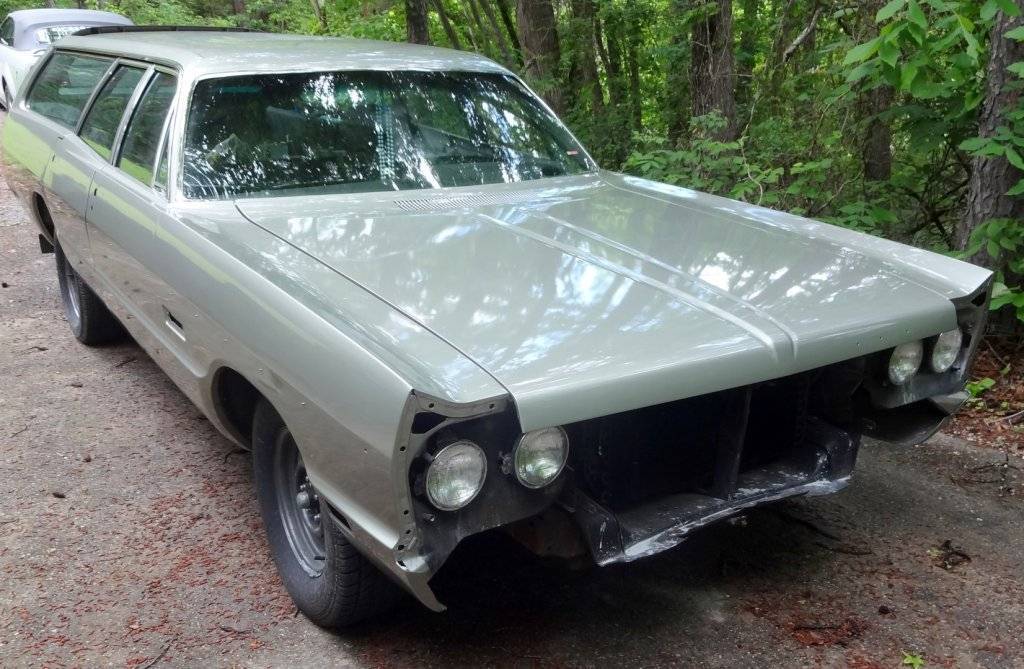

This was suppost to be a "work on the camper" day. But I couldn't resist installing a couple of pieces on the Admiral.....
Looks great Will! My favorite part of restoring the car is putting all the trim back on, after painting. I believe I got work done early every day until it was all back on. Can't wait to see the trim all back on.
I stripped the trim and did most of the prep work. The painter took care of a couple of minor dents and final prep and paint. It's a great way to keep cost down.
