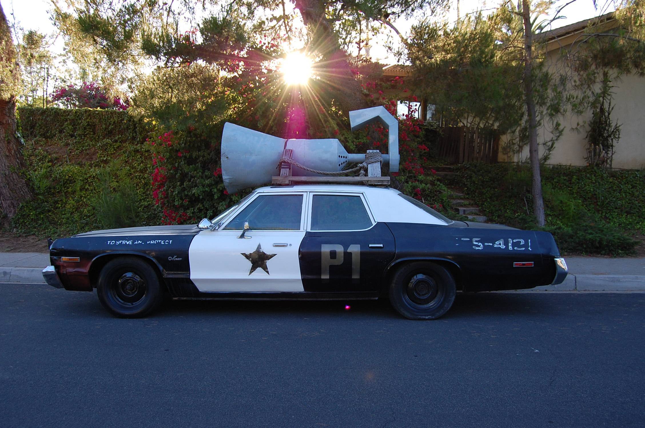

I've been enjoying this one as well. Here's the one I did a few years ago.
Very nice! What color paint did you use for the P1's on the rear doors? They look great! I had a hard time finding a "correct" looking color, the last time I did them.

It was a decorator color in spray paint,purchased at Home Depot-bronze something or other? It worked well and held up too.
