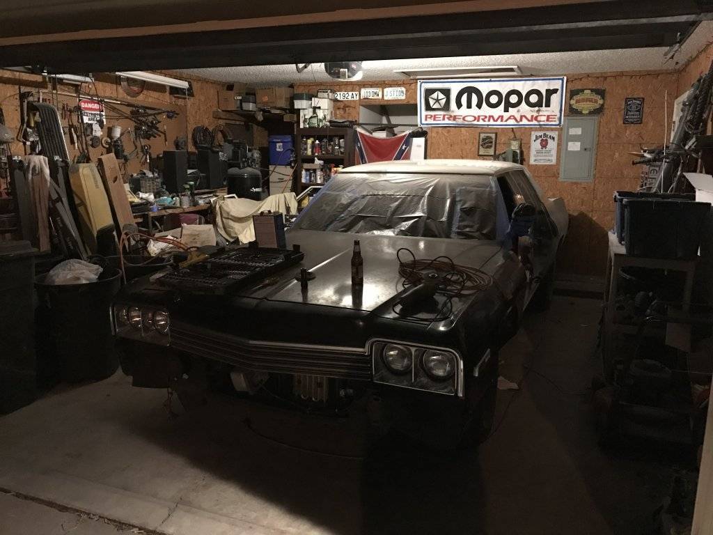

Got the quarter panel extensions cleaned, and painted on the back side. Idk what kind of metal they are.. tried to weld up the trim holes on them, but it wouldn't take. So back to filler.

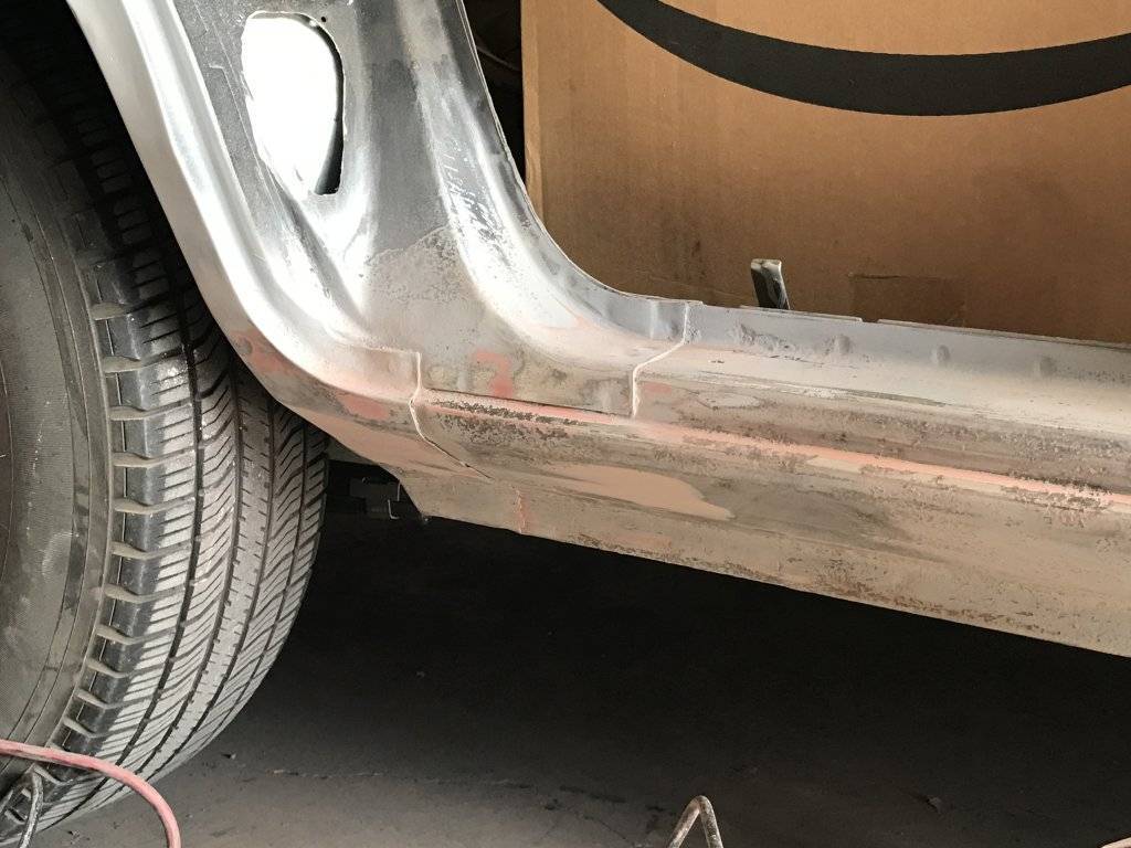

Rocker panels got sanded down, and filler applied. Used up some spot putty on them. They have a bunch of pits... didn't go as crazy with it on the driver side. Again, not looking for perfect, just decent.

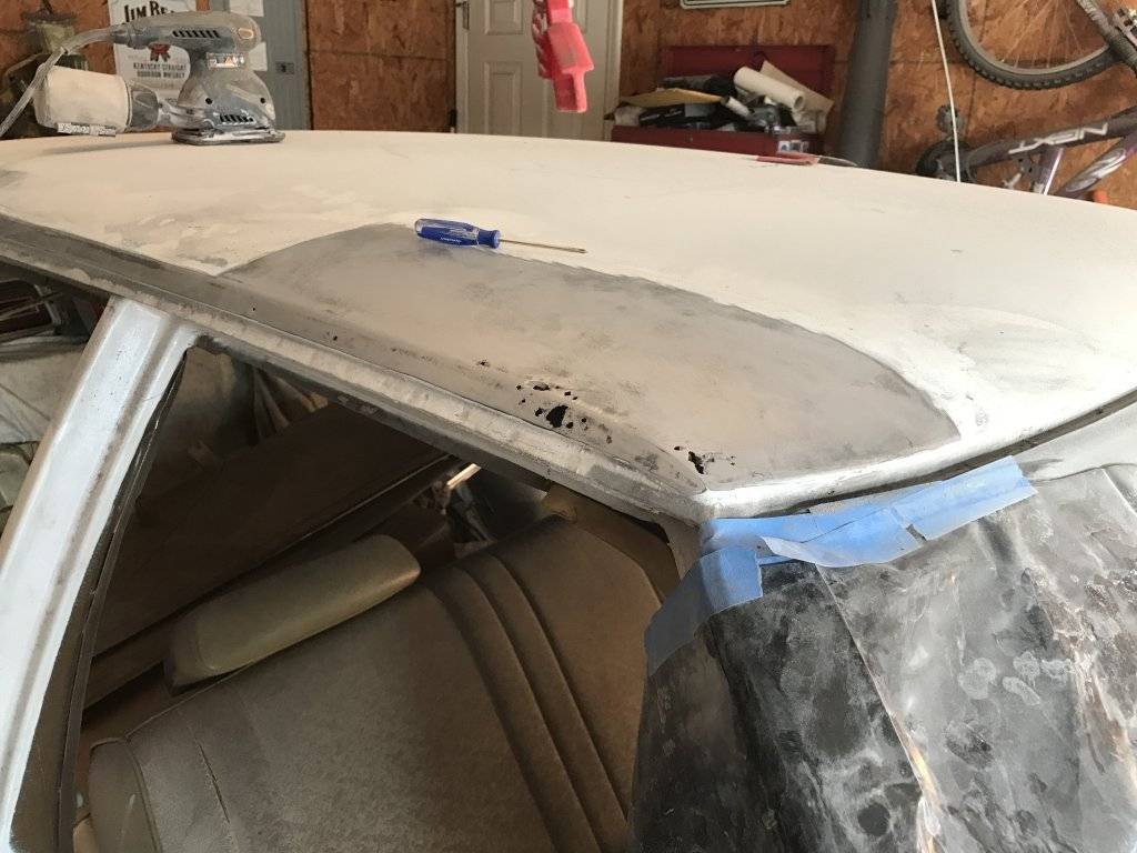

Started on the roof. Got the driver side C pillar stripped, and a new layer of filler applied. Hoping to have the roof done tomorrow.
It's time for a beer!

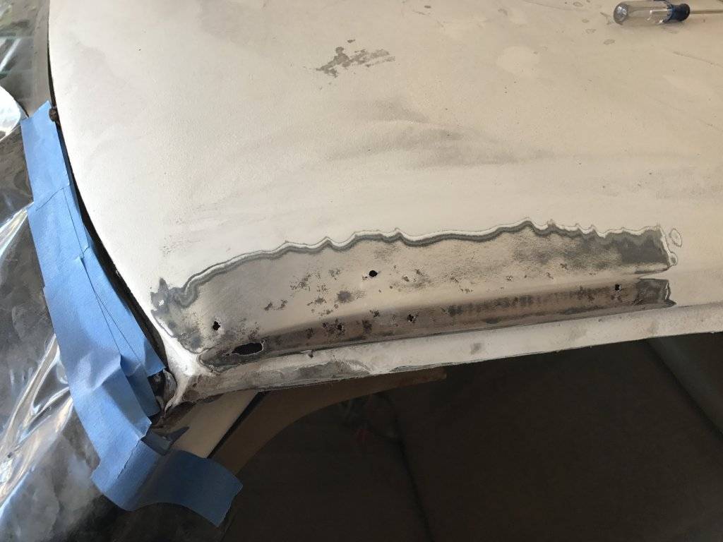

Thank you oh wonderful old vynal top! Sonofa... took the top windshield trim out. Think this is the first time ever since it was put on at the factory. There was still bits of the vynal top hiding underneath it. It made the top driver side corner rot out right under the roof skin. Along with the other small holes on the roof seen.
We all know how hard it is to come by formal glass. I'm not risking it! I spot welded up the pin holes on top, cleaned the area, and filled the hole with some silicone. Hopefully this will hold for a while. A new coat of filler over the corner, and about good to go.
Same thing on the passenger side. Except no rot in the window channel luckily. Just pin holes up top. Ran the welder out of wire.. Think I'll finish it with just filler...
Think I'm doing pretty good though. The first time I did the car up, it used 2 and a half gallons of bondo lol. I've only used about a quart so far this time, and am pretty much done with it.

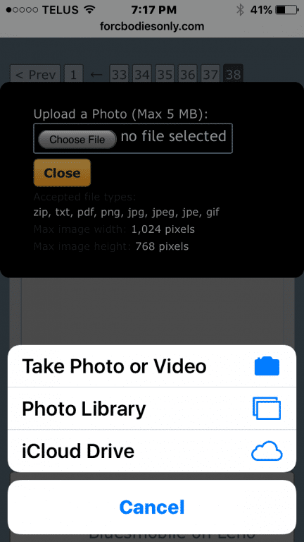

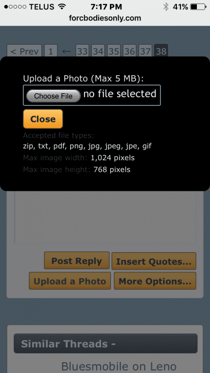

Ok so I click on upload photo
Then this screen pops up
Then I press select file and this pops up
I select Photo Library which takes me to my pictures select what I want once uploaded select insert full image...voila

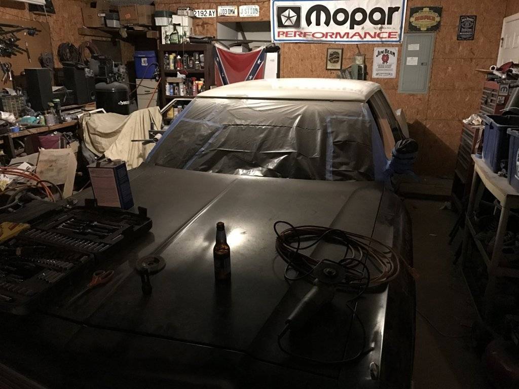

After sitting here with no wire for the welder, I thought to myself. Wait a min.. you have that quart of all metal sitting here.... it's what this stuff is made for right?? Hopefully.. we will see if it'll hold up. Didn't get any pics, but we've all seen filler work before.

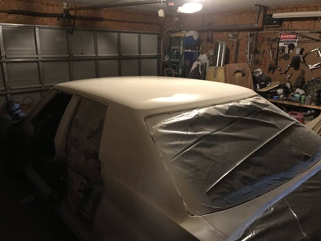

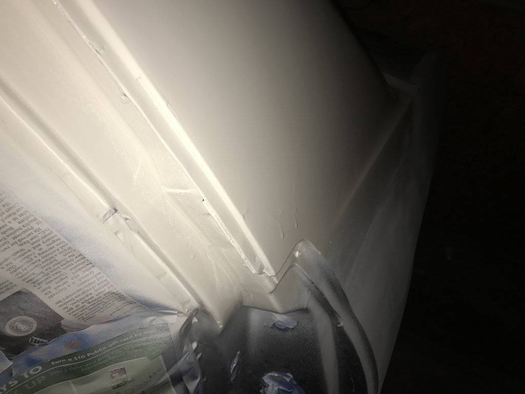

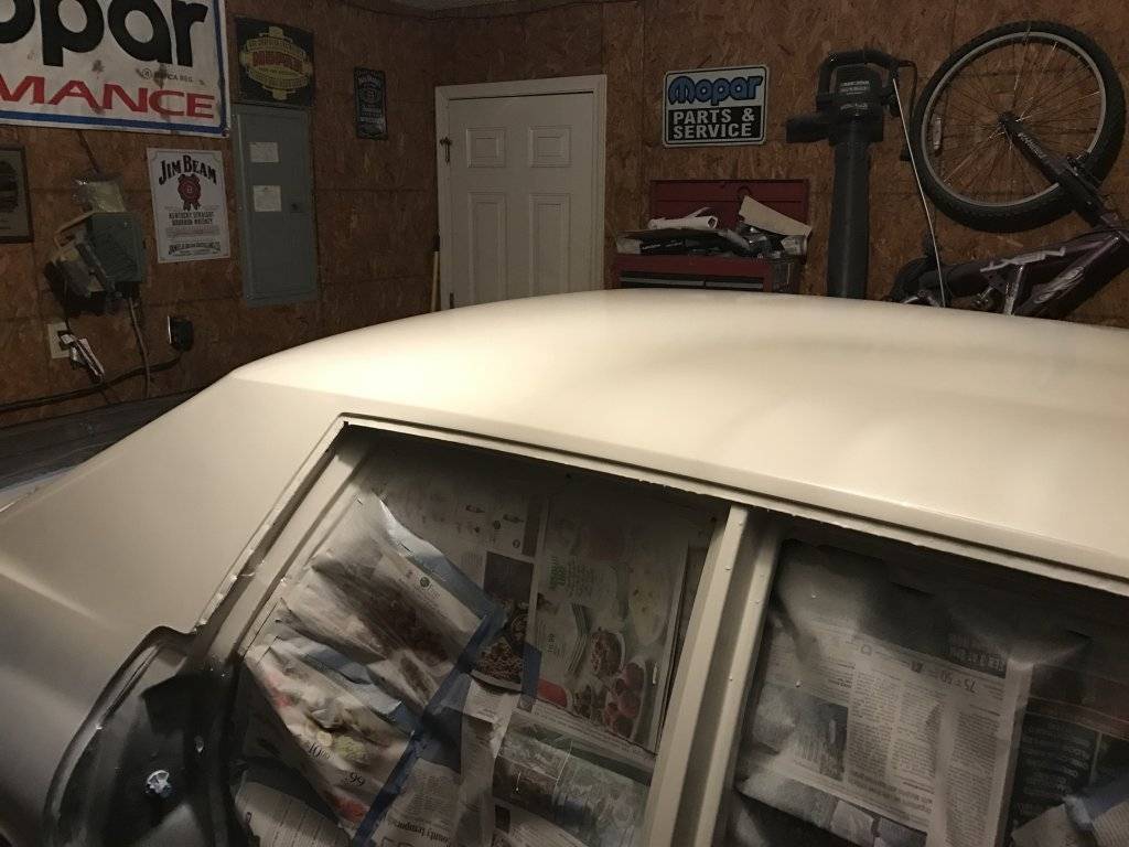

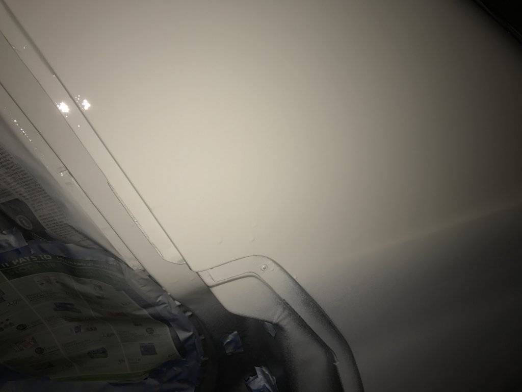

Today masked the car up, and shot on the new Chrysler spinnaker white. I like it! Gives a much more authentic look then the normal gloss white before. A bit more cream colored.
Its got a couple runs here and there. Also the only 3-4 bugs out during winter found the new paint. (ofcoarse)... admittedly it's a little too cold to be painting. During the week is gorgeous. Mid 70s-80s and sunny. Every weekend the last couple months has been in the 60s or lower, with overcast.
Luckily most of the runs will be hidden by trim or doors. Only bad run is in the driver side c pillar. It is the bluesmobile after all though.
I'm not gonna sweat the run much. It will probably just stay there. Cover it up with some dirt or something lol.

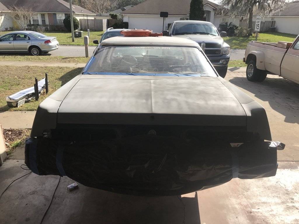

Got a few day light pics. It's looking good!
Can't wait to spray the black, and start putting her back together!

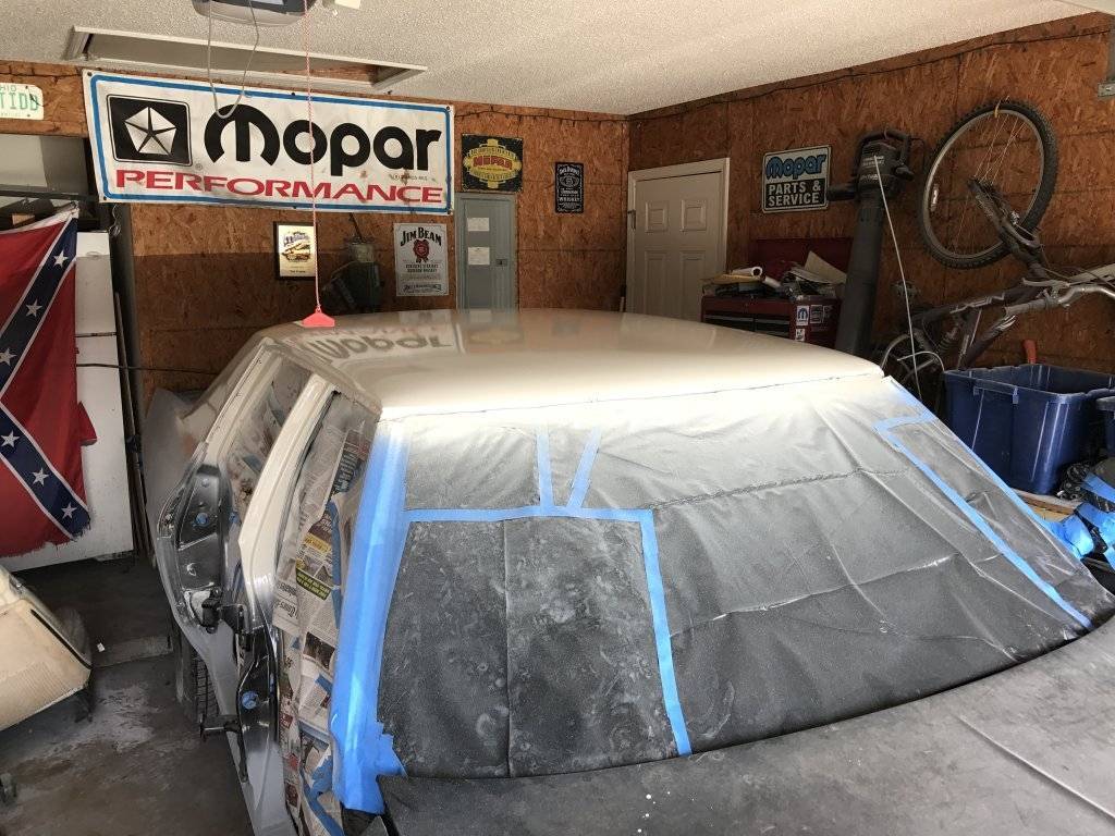

You're a cheap bastard like me. I can't bring myself to buy masking paper when there's a paper recycling bin down the street. lol
Hell yea! Those are the free week old FL news from the gas station lol.
I got fancy, and bought that plastic for masking. It sucks! The tape doesn't want to stick to it. Could get it to work on the windows. But no way it was going to work in the door openings.
