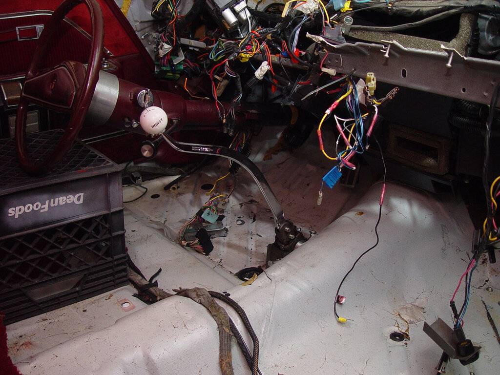

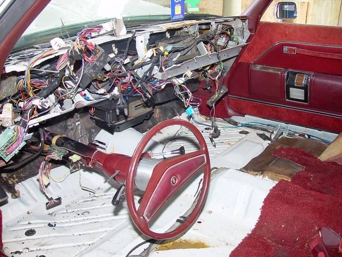

    I searched the dock and couldn't find much, just a few pics. You must have done the thread on Fins, which isn't there anymore. Was that dash the worst part of the job?

    It started back on a very old Mopar site called Mass Mopars. After the owner of the site died, so did the forum. From there, almost all the work was documented on MoparFins in it's own thread.
    The dash was something that made me hate the project.

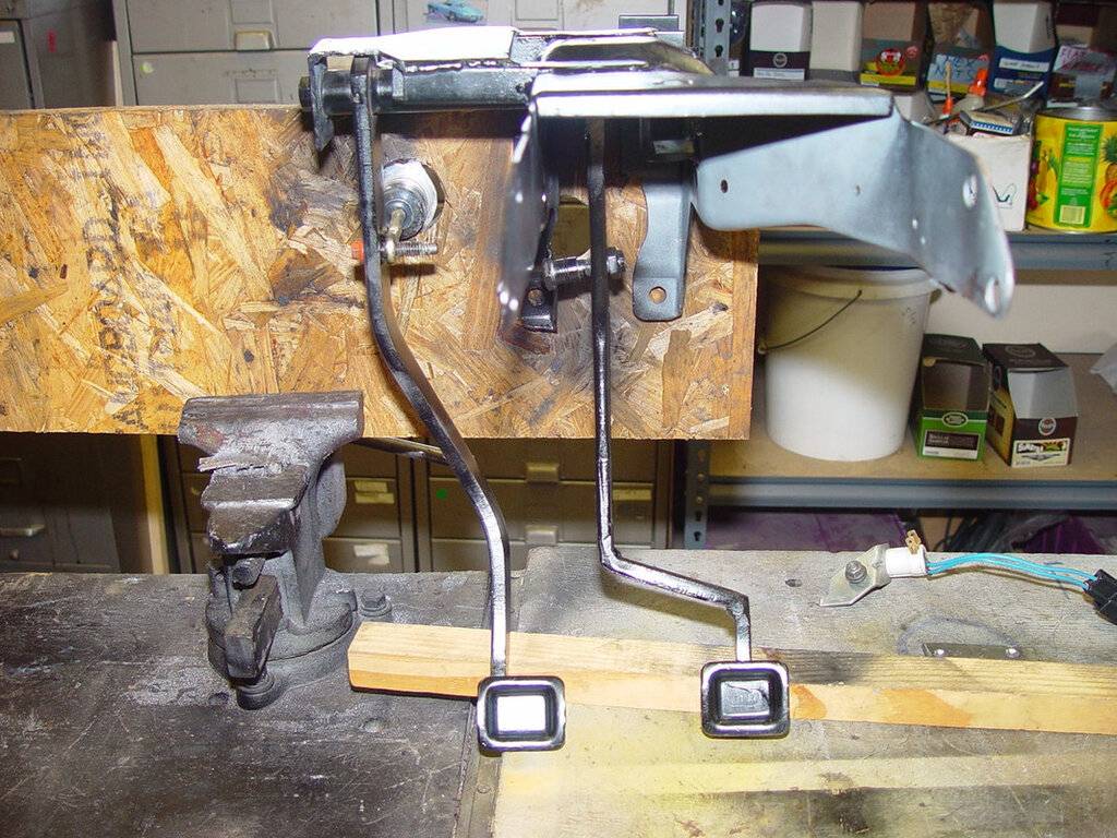

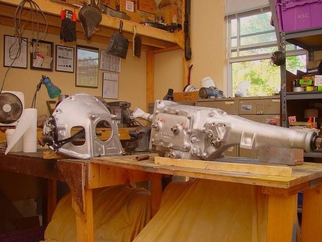

    What transmission did you use? Where did it come from ?
    Where did you source the pedals from ?
    Why did you choose those pedals?

    TRANSMISSION : A883 from a 66 Fury.
    CAME FROM: Steve Hobby, owner of Mopar Fins.
    PEDALS: A Frankenstein hybrid fab of a Formal and Jeep pedals.
    WHY THOSE: I examined as many clutch pedal setups as I could find and the Jeep appeared it would be a good match.
