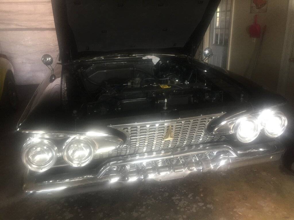

Here are some pictures from the iPhone
Looking good, but I think I'm speaking for all of us when I say you need a different camera.
You're killing us with that thing!:rofl:

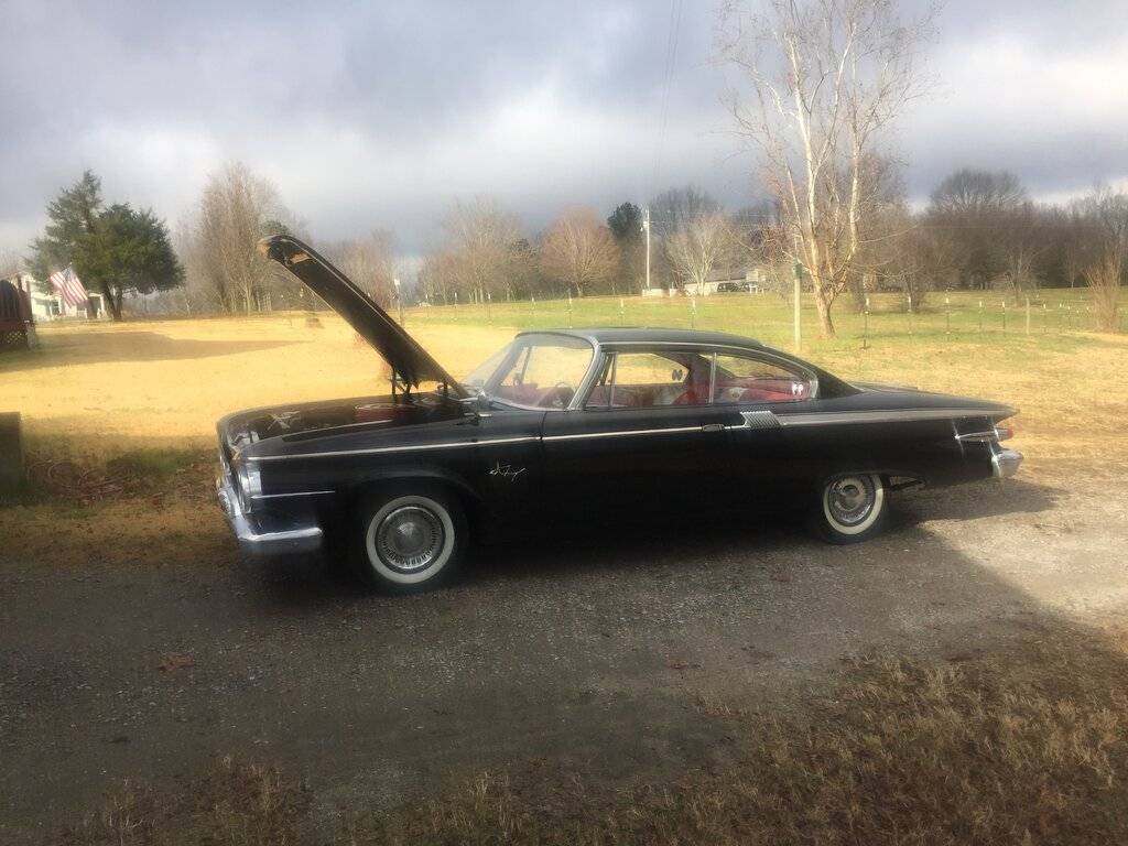

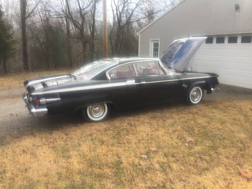

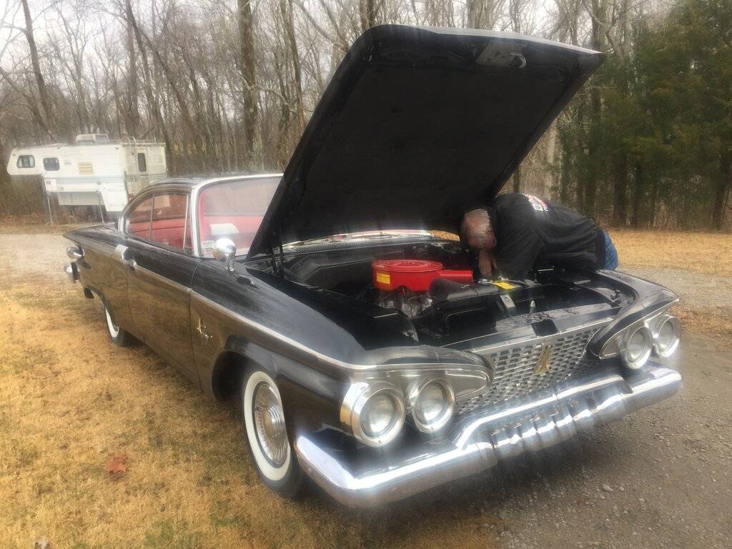

I had a front end alignment done and nitrogen put in the tires now since today is old geezer winter's 1st day the car stays put I will not drive this car during the winter months but it will get started once a month .
I just taken more photos and the car is outside I drove it back from getting an alignment and nitrogen put in the tires. My dad drove it up there and I drove it back but there was some play in the steering wheel so the steering box had to be tightened a little more
When you start it, get it up to operating temperature, pump the brakes a few times, then run it through all of the gears, a few seconds in each one at least. Helps keep the seals wet.
You've been given enough grief about your camera already. It did, however, have a serendipitous effect on the right-side view: to my eyes, it makes it look like you found an old photo and scanned it for uploading. Unintentional, but like it!

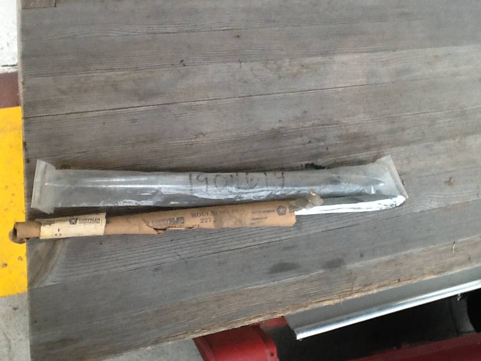

Scored a set of NOS spears recently.
Nice find Ken. You'll need to measure the studs on the spears. The clips come in different sizes. The pins on the hood and side fender script are smaller I believe. I'll need to get some for my NOS spears when the time comes.

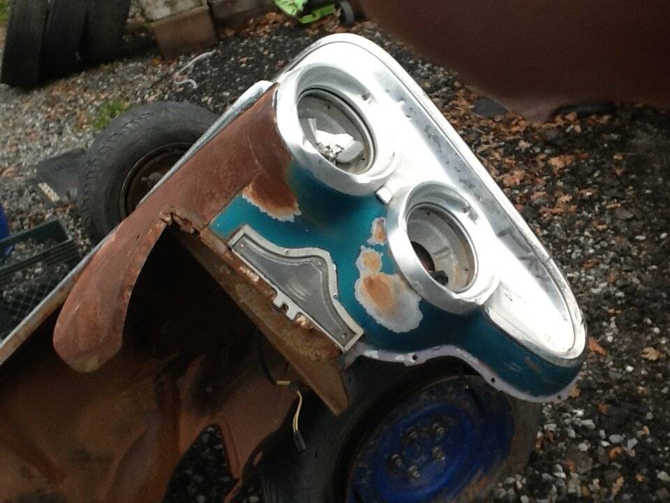

I also picked up this rust free fender with mascara trim. IDK if these are the factory fasteners for spear trim? This what they look like.
What about those square push on fasteners like on hood and rear deck Plymouth emblems?
So far I haven't had very good luck in removing those clips without breaking post.
Would you guys reuse the square clips or look for something else?

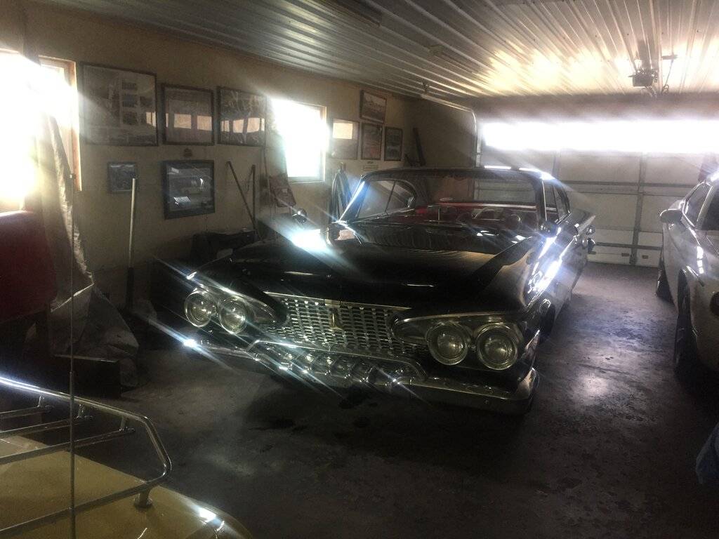

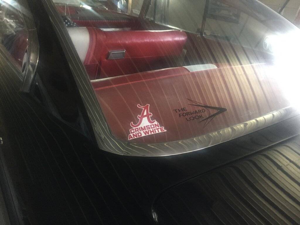

I got the clips thank you here is another photo of it parked in the garage waiting for car show and cruise in season the carburetor is running rich right now I am guessing it’s a bad carburetor when I filled itI out the shell vpower fuel. In the tank but I did put the Lucas ethanol treatment in the tank 1st. I went to a face book page called 1961 Plymouth called crazy people with ugly cars I have seen a photo of my other '61 burned at car port ( photo was taken 2014 ) some one had to make a smart *** comment that it can be buffed out I commented back that the '61 fury in the photo was my car and I would not be making smart *** comments about it and you would be just as pissed off as I was if that was your '61 fury
Calm down Steph. Just bury the dead and be thankful you were able to move on, Who cares what some moron has to say....
Your car is looking great!!!!
