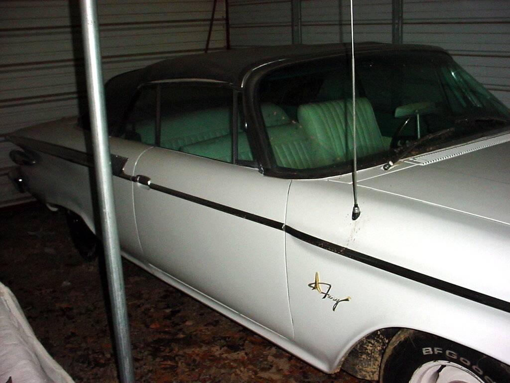

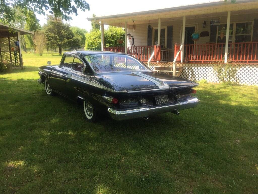

Factory installed Solex tinted glass, It was a green tint. No aftermarket film tint will look right Steph. just forget about tinting or find factory tinted glass.

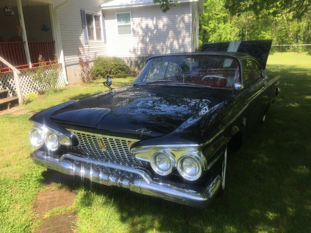

I was wondering if there was green tint available for my car I can put on the windows . On a hot Summer day it is hot with the clear glass but with the tint it will be cooler . I want it to look like factory tint I am going to google this more and do more research.
Here is what the factory tinted glass looks like Steph. This is my car as I found it.
I thought that is what it looked like I found some of this solex tint film on ebay but I hope I can find a shop that has this also . I am looking right now .

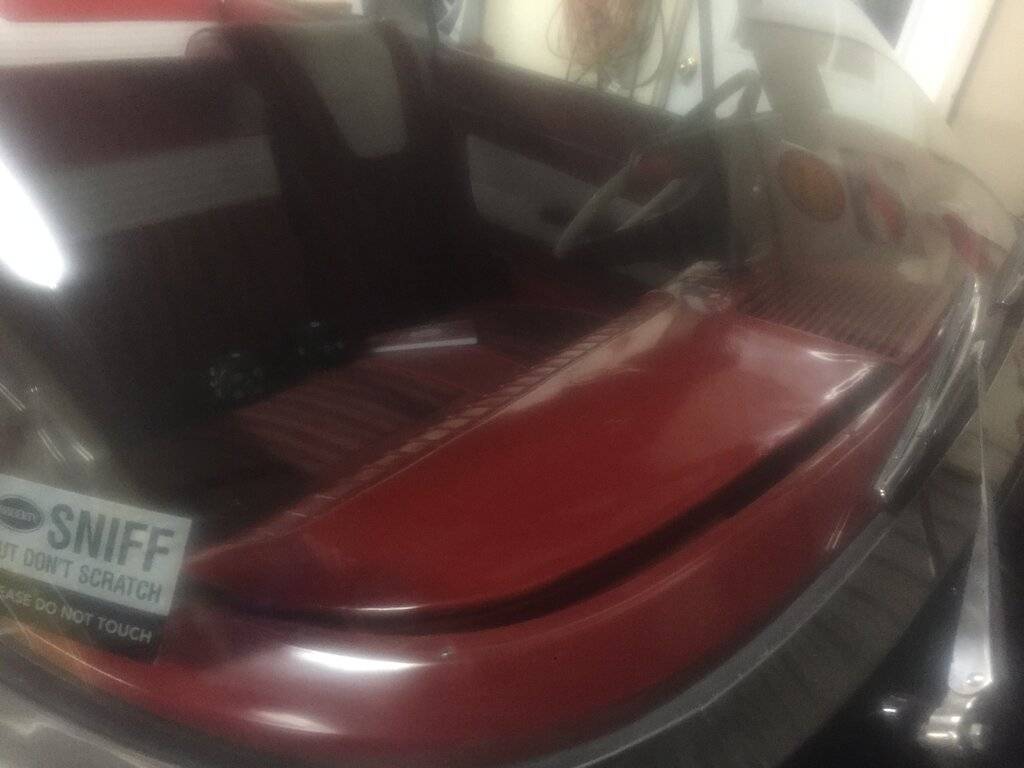

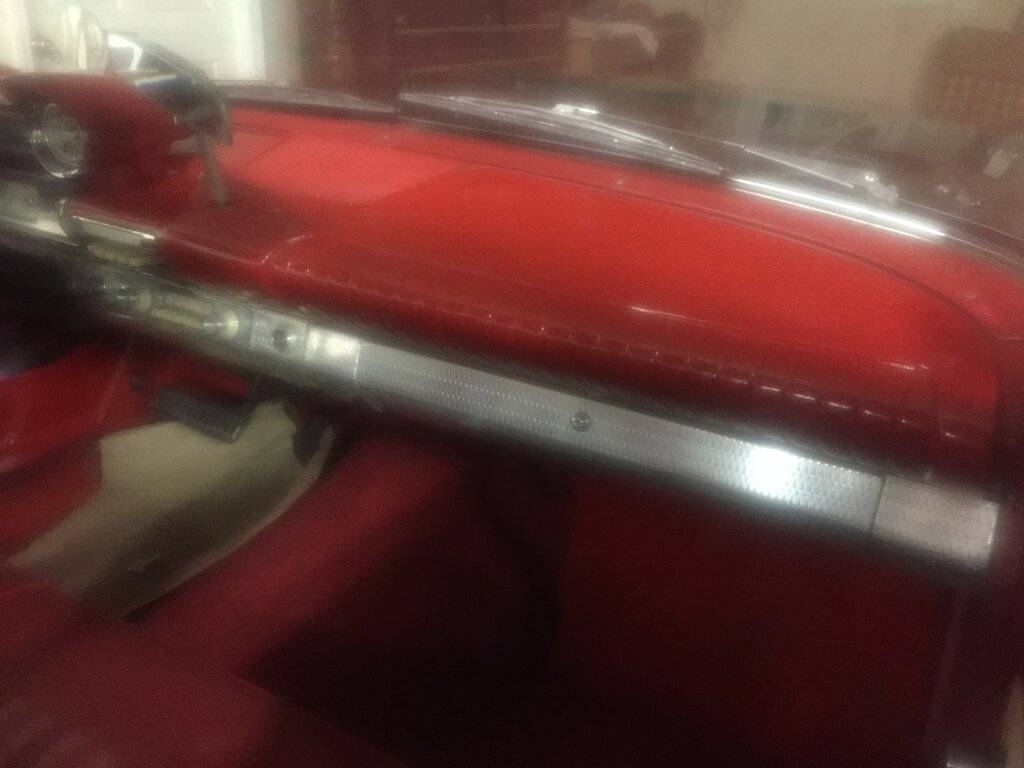

Looks great,been following your build for some time. I might have some solex window glass parts for you. JMO it would be a shame to cover up the red interior with blacked out windows.
The red really pops against the black.

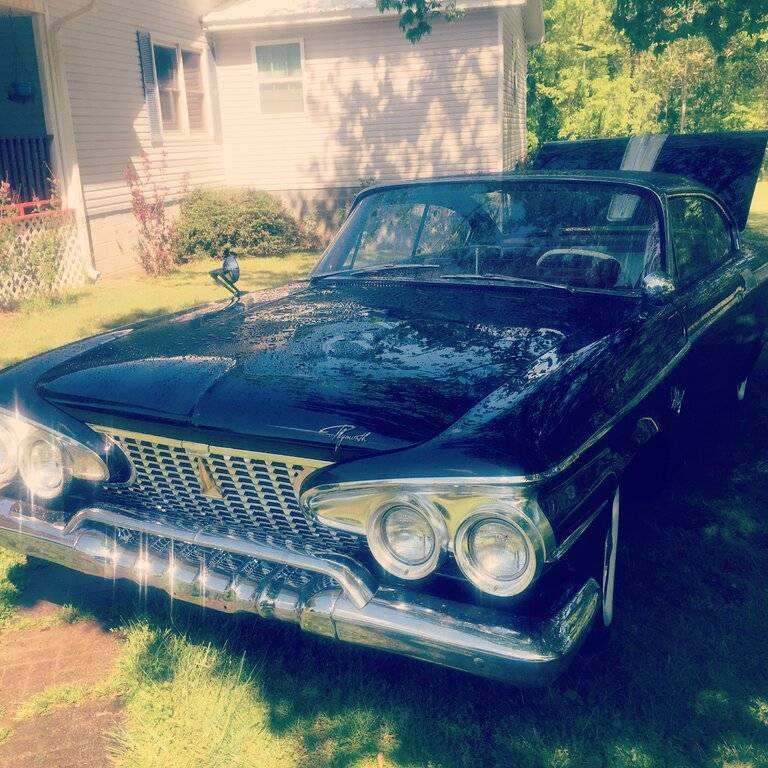

I will bet its the light in the ceiling of the garage but when I take photos of the car out side using the iPhone camera they turn out better plus the ceiling in the garage is metal also . I will bet that is it.
Steph: I think the lens on your camera / phone is either scratched or very dirty. That would cause the light entering the camera to be skewed and scattered resulting in fuzzy out-of-focus pictures. Or maybe there is some camera setting in your phone that is turned on or turned off. Here is a photo I took some time ago with a digital camera with a dirty lens. You can see how washed out and fuzzy it is:
