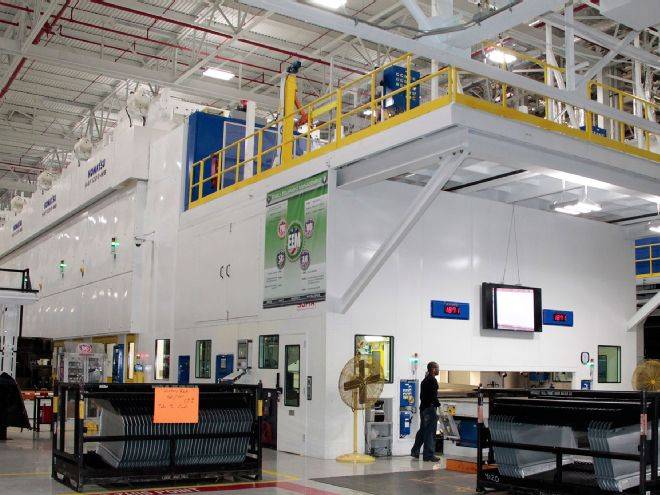

It's based on working in a place that actually makes floor pans for Chrysler products as a younger man. This is what the "machine" looks like:
Note the size of the man walking past. Now all you need to do is build about 5 die sets (each the size of a car, weighing about 25,000 lbs). Granted, AMD and the Chinese take a lot of shortcuts that aren't required for small-scale stamping, but not enough shortcuts to get the >10 sets you might be able to sell down to a reasonable per-unit cost. If you want to make something that comes with a Class-A surface (exterior panels) add some zeros. Only restorations of musclecars will support that cost, not many of those left for $1500-$3000, and those are your competition.

CLean plant.

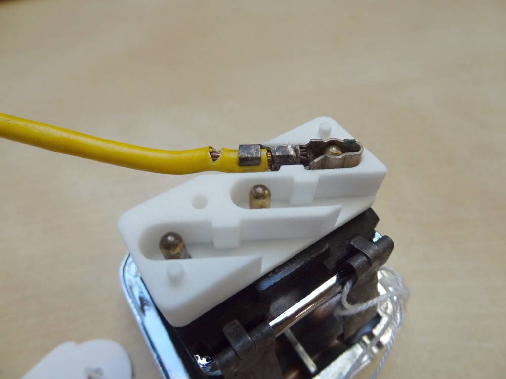

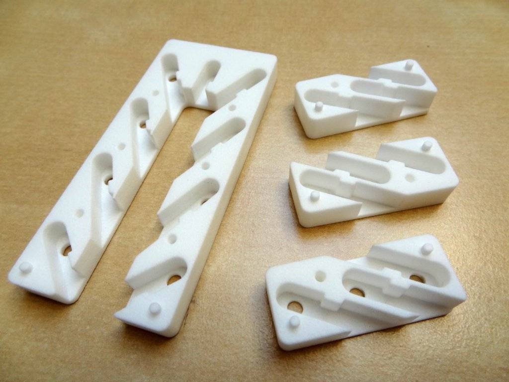

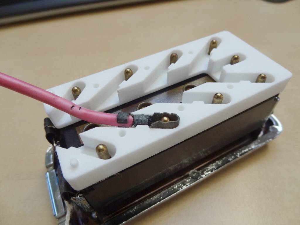

Indeed. I started to reproduce last year power windows plastic connectors for '57-'59 Mopar cars, using 3D laser printing technology.

CLean plant.

Thanks I liked that... in high school I joined a BSA Explorers group for engineering and our sponsor company was Wean United, who built those machines. We did tour the Fisher Body plant in West Mifflin PA one time... they were stamping Fiero floor pans and Monte Carlo doors at the time.
It was cool seeing the QC guys take oiled doors into a room with black/blue lights to spot defects. As it turned out I wasn't ready for college and it wasn't as inspiring as you might think listening to a bunch of middle aged steel plant engineers in Pittsburgh during 1985...
