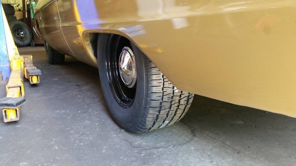

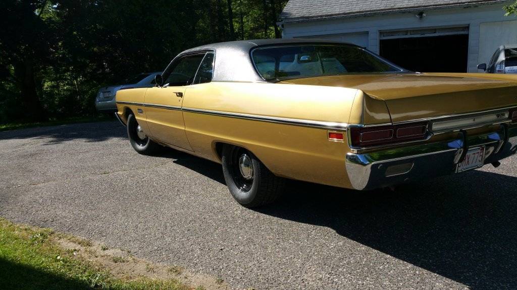

275/60/15 's on the back of my 69 FuryIII . 15/8 wheels with 4 1/2 backspacing.
235/70/15's on the front. There is room for more but I didn't want to get greedy or make it look too much like a Mattel Hot Wheels car.
