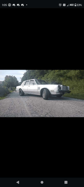

So just wondering on how big I can go for tires on my Fifth Avenue. I've got 15" rims and I'm wondering what I can get away with, without rubbing of course.

I have the original honeycombs that came with the car when I bought it
