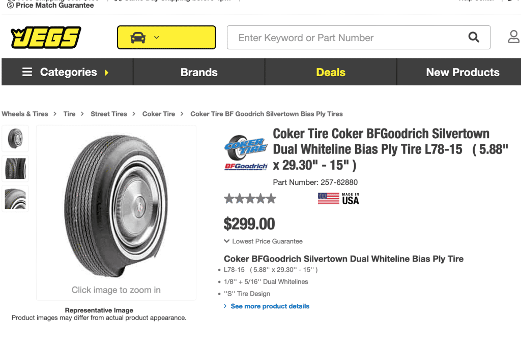

Maybe not the exact size here but Coker makes vintage correct tires.

One of my biggest regrets restoring my '56 Pan - 30 years gone - was putting ugly modern and presumably better tires one it, rather than Cokers.
I would go with the Nexen AH5 white walls. 235/75R15. Heavy weight rating, good looks for an Imperial.
I might be a bit monetarily conservative, sometimes, but paying over $200.00/tire for tires that MIGHT see 3000miles/year is just a bit too rich for my blood. No matter how cosmetically-correct they might be for the vehicle. But I know that everybody has their own sensitivity and affordability issues in this area, too. BTAIM
