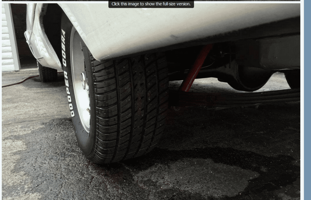

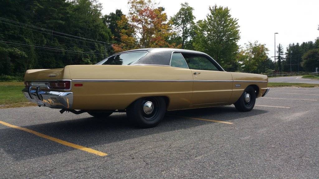

I have 275/15 /60 in the back of my 69 Fury with 4 1/2 back spacing. 15/8 mopar repro wheels. Fronts are 235/70/15. Plenty more room for more with the correct backspacing ,,but no info from me.

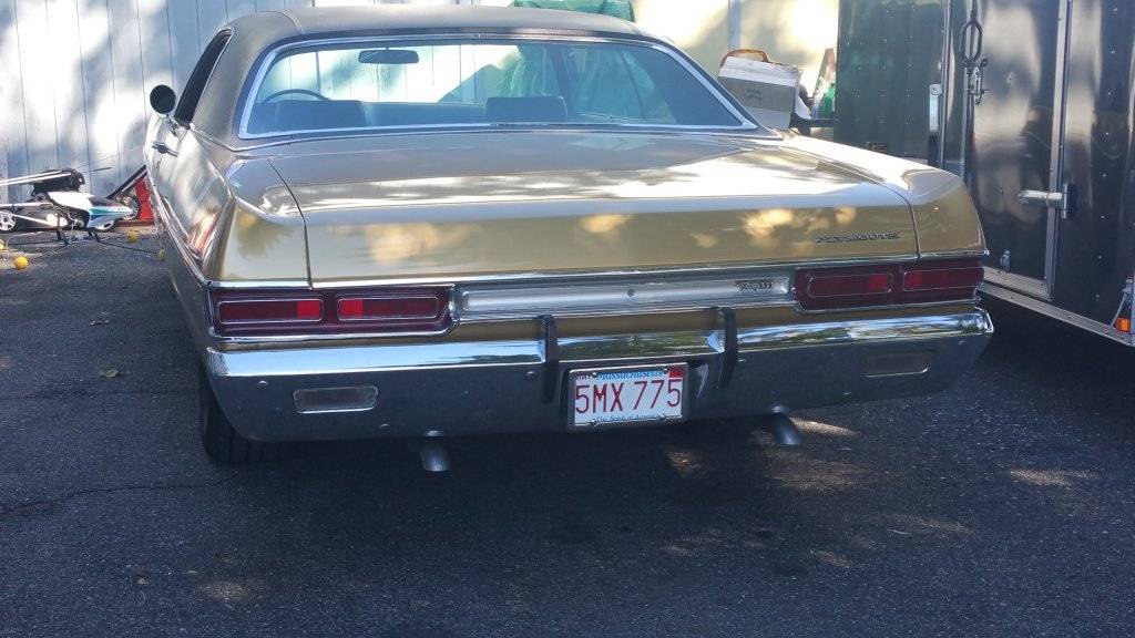

Got rid of the taco belle straw exhaust with dual 2 1/2 inch Still looks small on such a big car.

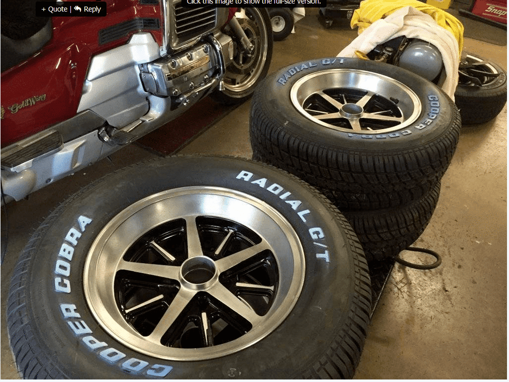

I think the 275/60/15's fills out the rear wheel well nicely.

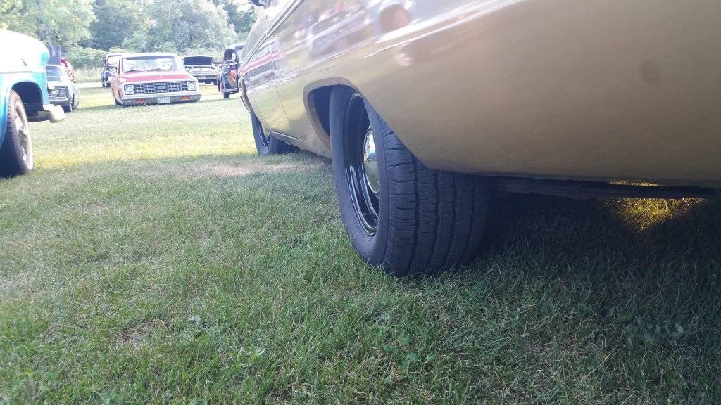

I did the 275 60 15 on rear with 15 x 8 wheel ..front did 235 70 15 on 15 x 7...I ordered acorn style lugs with 60 degree seat not sure if this is what should be used on " cop wheels".
Not sure if they seated the rims down. Was getting late.. any info would be great
