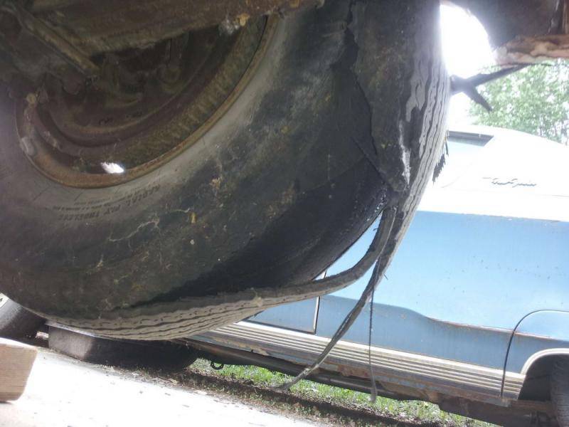

I had an OLD tire that had been expose to sunshine on a car stored for 15 years outside blow up like that, just sitting! Obviously, not a tire that would be street-driven.
Like I said before, how has the tire been taken care of??? THAT matters far more than age.
Notice that the age suggestion subtly moved from ten to six years for replacement??? Maybe that is an indictment of how shitty tires are these days, the tire industry refuses to take responsibility for their crappy products, and this is how they "take care" of the supposed problem? Hmmm???
That one sat outside for 10 years just fine. It wasn't until I put the car up on stands and crawled under it that that tire suddenly blew out a few inches from my head.
