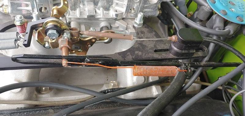

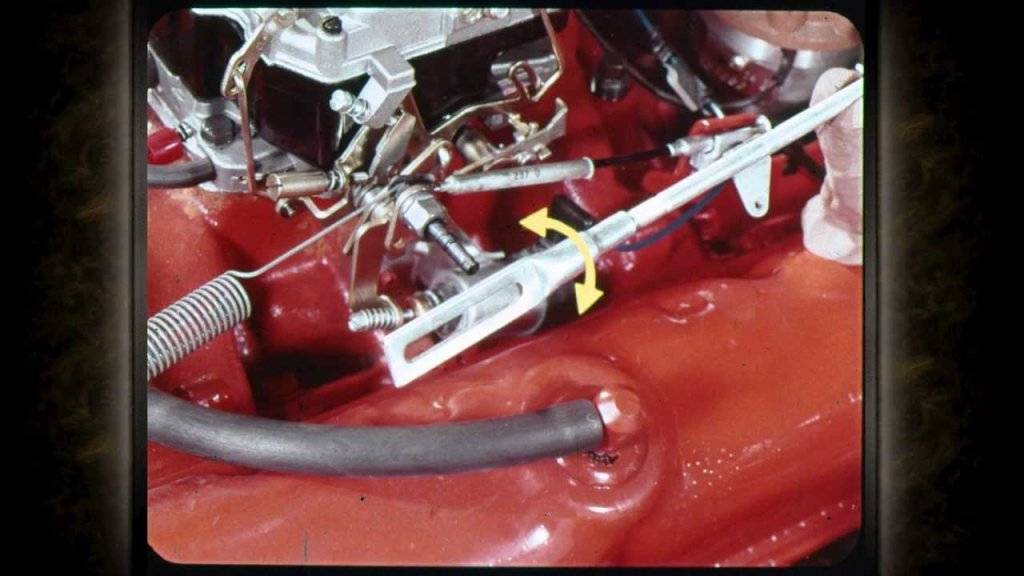

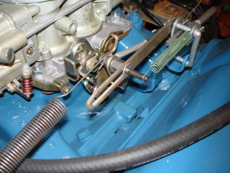

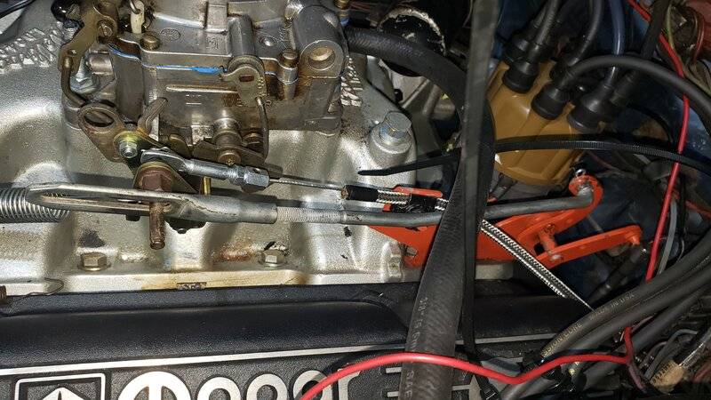

It may not look the same as the OP's but this should be similar. The back of the slot should be just touching the pin on the carb linkage. That's a good place to start. Basically, when the carb is at full throttle the kickdown lever(throttle pressure lever) on the transmission should be wide open. Have someone push the gas pedal to the floor. That may not open the carb all the way and the cable can be adjusted accordingly. Then you follow up with the transmission kickdown adjustment.
This first photo needs a little more adjustment. See the gap at the back of the slot? This transmission will shift early and at slow speeds. It may also slip if left out of adjustment too long.
