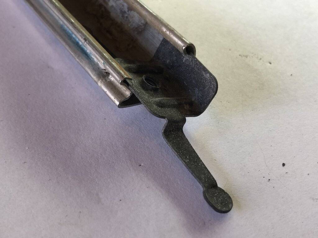

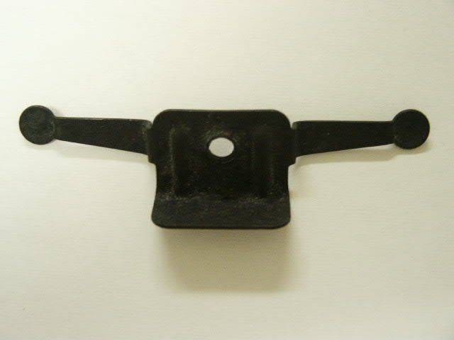

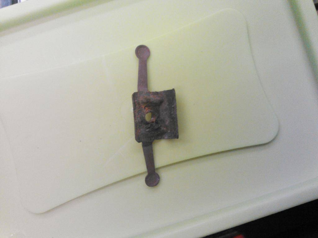

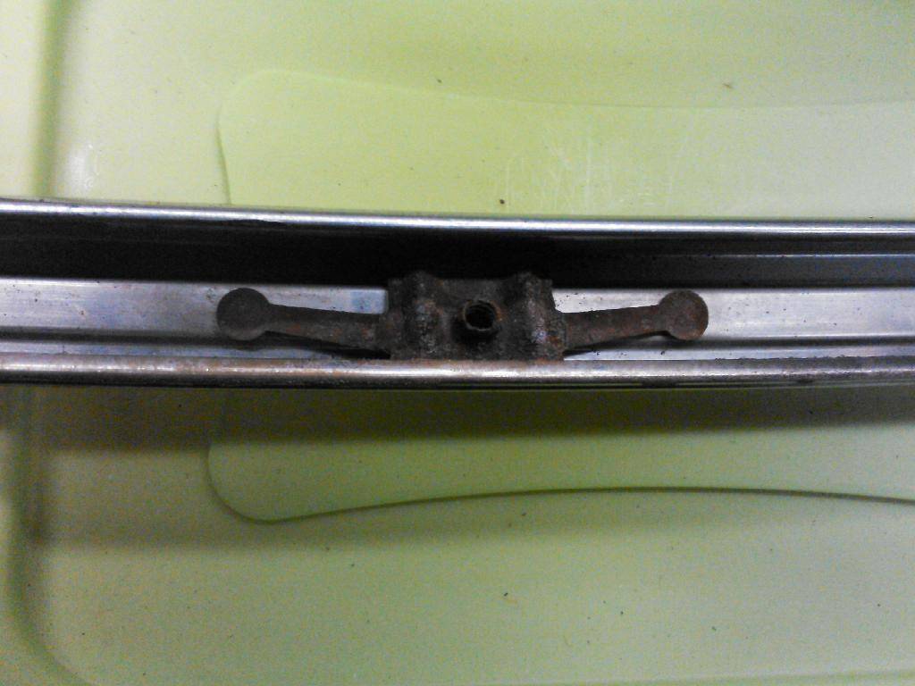

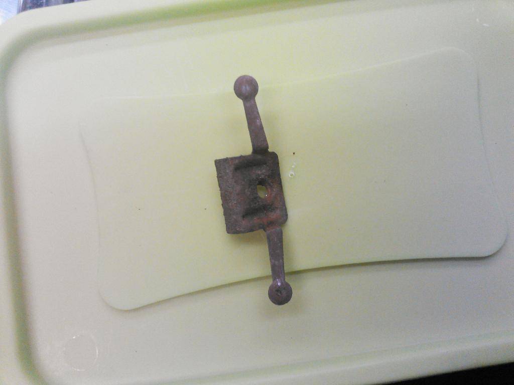

This is from my '69 300 vert. It's a clip that slides into the trim piece then attaches to body. Used to secure the piece that the convertible boot attaches to. Any ideas where I can find this type? Needs to be like this. The screws come in from the underside into this clip. Has to be like this otherwise the convertible top rubs against the backside of the mounting screw head. Thanks!

Any ideas how to remedy? I bought these last night, thinking they would work, but then was thinking about the top rubbing the nuts. I think I'm going to modify these. I will cut off the threaded post, then drill and tap the base plate, then should be able to get a screw up from the underside into these modified clips.
The Chrysler part number for the clip is 6002734
The part number for '70 Cuda convertible clip is 6002976.
So... That's not a great sign that they will work.
Comparing the clips, it looks like the "ears" are bent so they sit higher. But you'd have to see them sitting side by side. If they were a few bucks, I'd say order a few and see if they could be used or bent to work. At $120... I don't know. This may be something I need to look at when I'm at Carlisle. What vendor is this?

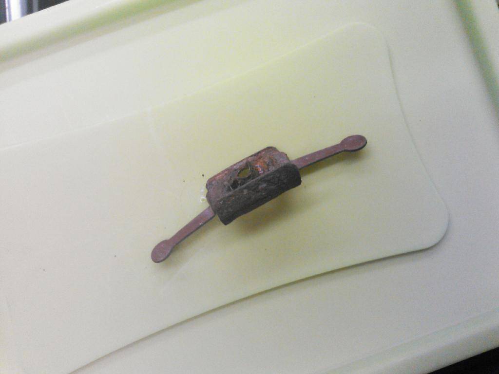

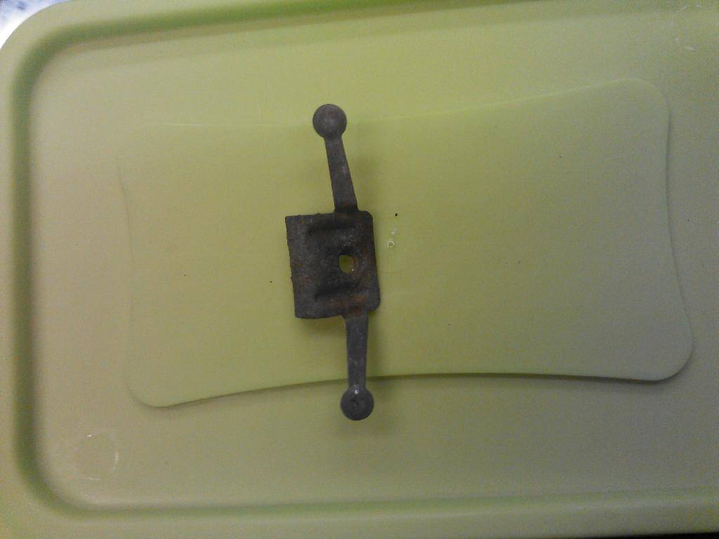

Made of metal. Only have one complete/undamaged clip. You need it to try and mock up some? I'm currently looking for temporary solutions.

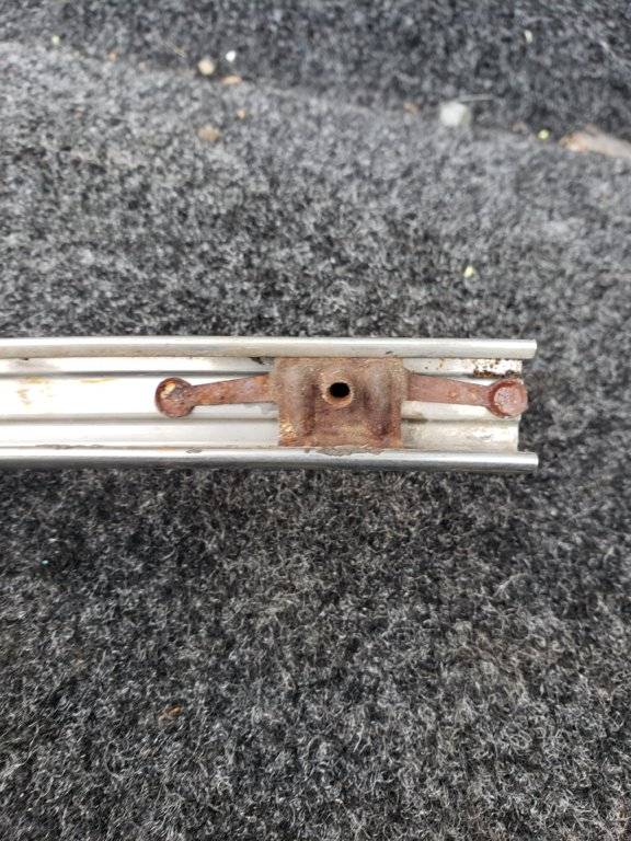

I have a couple that are broken if that helps. There are 10 per car.

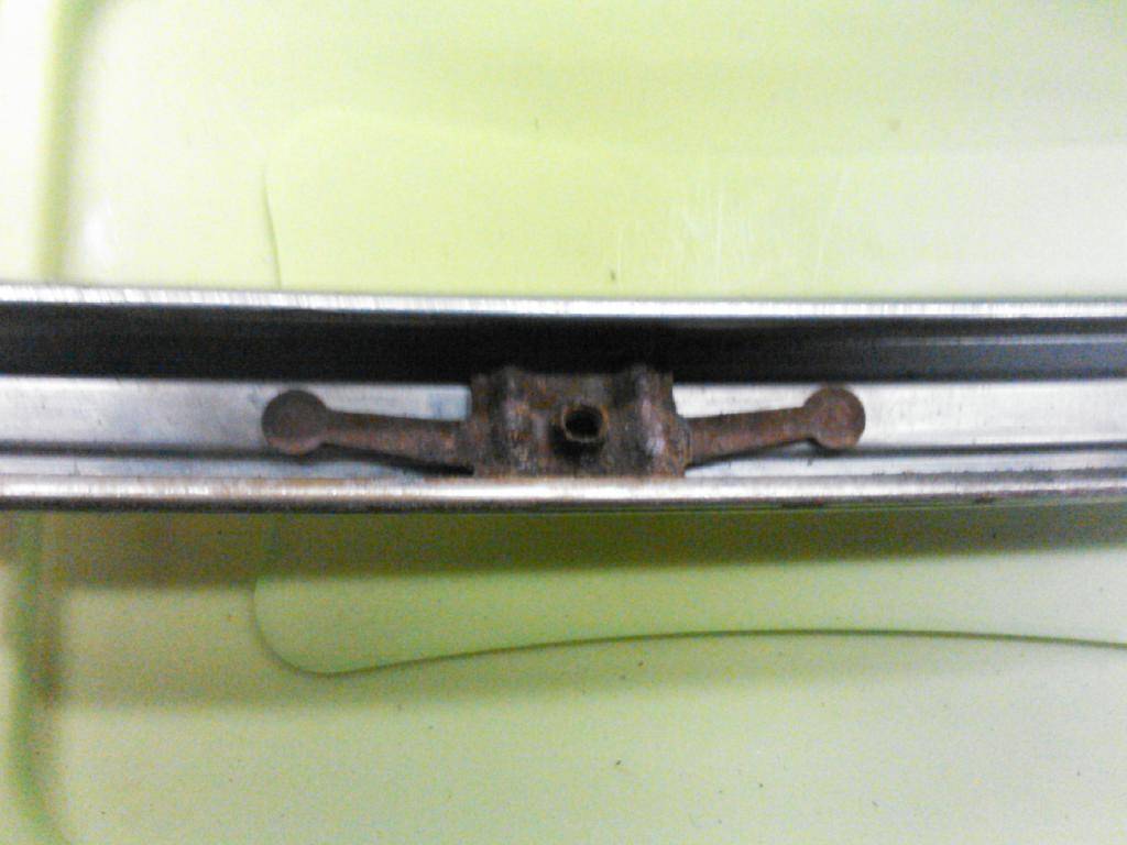

A couple pics of how the molding is on the clip if that helps.

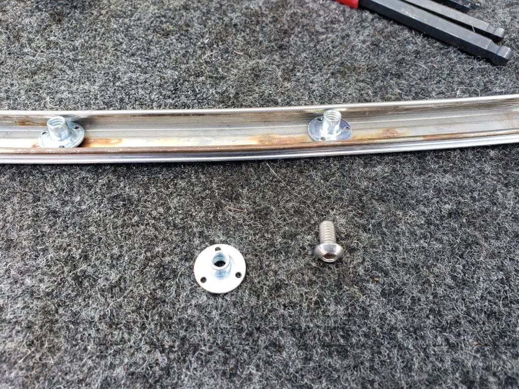

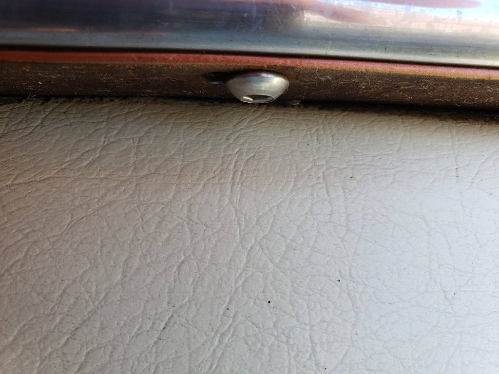

Got it done. Parts I used worked perfect. I used t-nuts, and SS allen heads. 4mm allen wrench. T-nuts just slid in the channel at the correct angle. Had to modify a old 4mm allen to help get a few of the screws started. I know its not OEM, but till I find a OEM part at a reasonable price, this will work. And it works great by the way lol.
Of course I cleaned up all the old yucky stuff seen in pic two once completed.

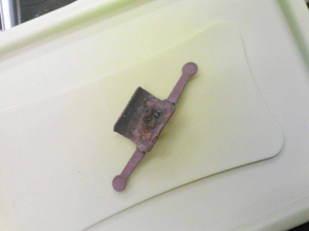

I ordered one of the E-body clips (6002976) and compared it to the C-body clip (6002734) to see if it could work or be made to work.
I feel as-is they will work but I might open them up a little.
If you look at the two there are two differences, 1. The threaded portion isn't as deep, keep in mind that is the entry point for the screw, might take a little effort to get the screw to grab a thread to start. 2. More notably is the flange, the C-body one is taller with a bend in it.
When you insert the C-body shapes to the trim and fits snugly.
With the E-body clip it fits a little looser but does grab both edges with no worry of it popping free.
Once fully inserted the E-Body clip holds itself in place, you may need to bend the wings to add a little pressure.
You can see that the treads are about 3/32" into the trim (it is reduced some as the E-body clip is shorter), not sure how much of an issue that might be.
So for those needing these clips I feel that the E-Body clip is a suitable replacement in lieu of original C-body ones.
