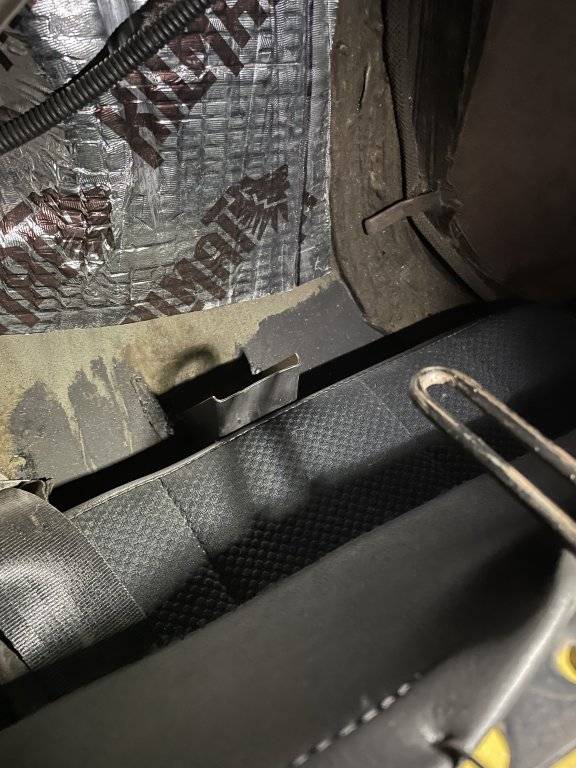

May 2, 2023 #1 72polarbear New Member Joined Jun 22, 2022 Messages 33 Reaction score 4 Location 92570 I already got the lower seat done but Im not sure how the back rest is supposed to go. Does the prong for in front of behind the sheetmetal insert?
May 2, 2023 #2 marko Senior Member FCBO Gold Member Joined Dec 15, 2014 Messages 1,545 Reaction score 2,470 Location Victoria, BC Canada you put the seat back in before the bottom
May 3, 2023 #3 Big_John Illegitimi non carborundum FCBO Gold Member Joined May 21, 2013 Messages 20,619 Reaction score 30,522 Location Marcellus, NY As said, seat back in first, the "prong" (as you call it) goes in front of the floor bracket and is bolted to it. Then the seat bottom goes back in.
