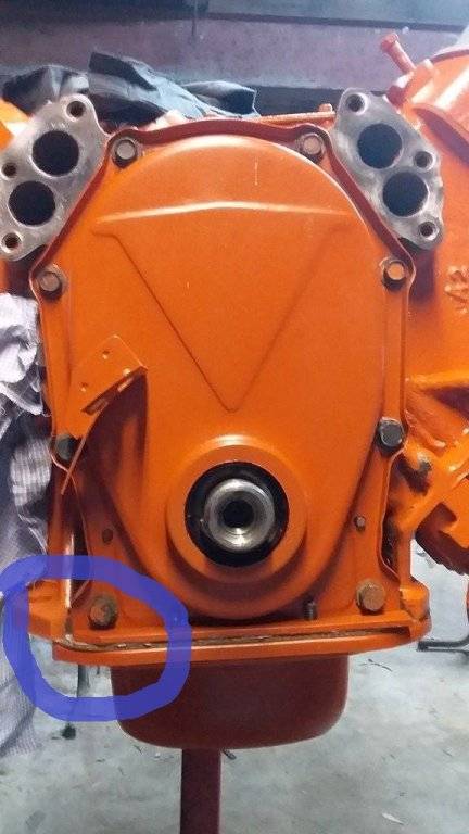

I have tried everything I can think of with my bloody 400 RB engine!, its hosing oil out the passenger side of the engine where the timing cover, sump and block meet right on the corner!
Pic below is not my engine just to show where the issue is.

Its hosing out when its being driven, I think its when the oil rushes forward under breaking its coming out the corner as shown, balancer is dry behind, no oil coming from the crank seal in the timing cover.
No oil leaks when stationary when started, only after its been driven.
Is the sump gasket and timing cover gasket all thats needed to seal where they meet in that area?
Cheers,
Picture of actual engine like just a engine bay shot and if your got the gumption close up of the underside leak would help. Without pics were just Stevie Wondering it.
