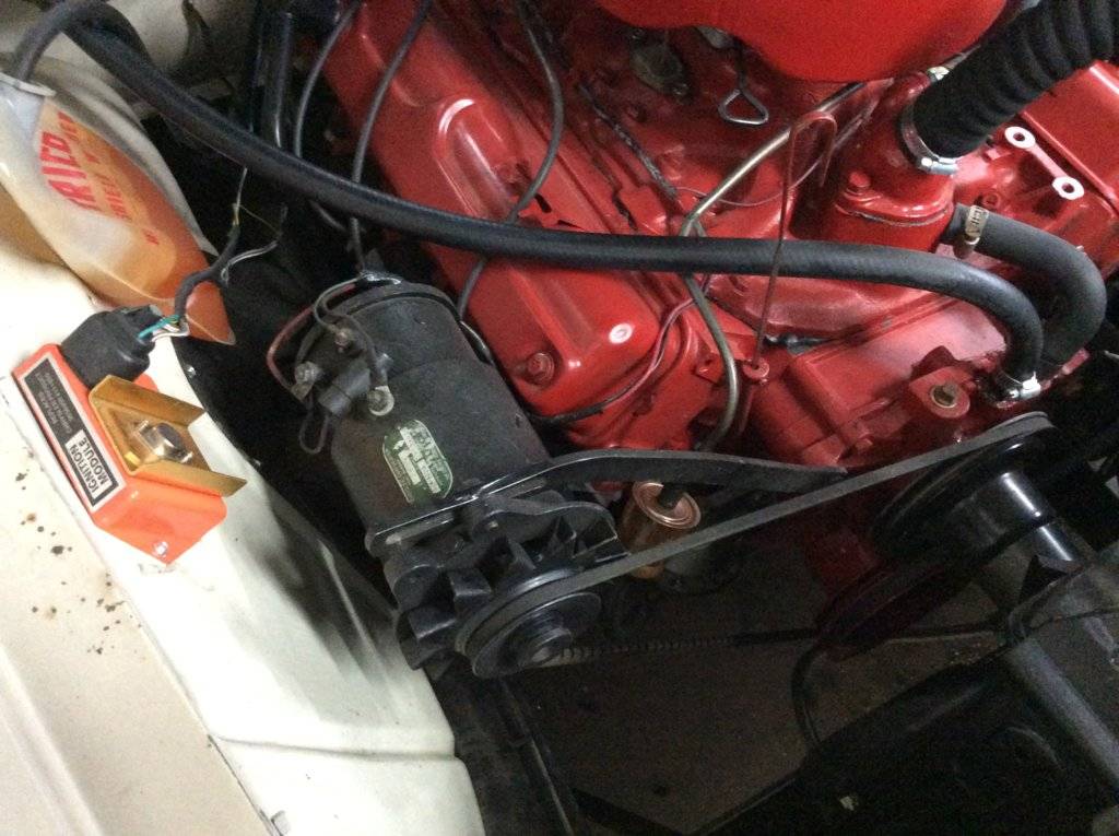

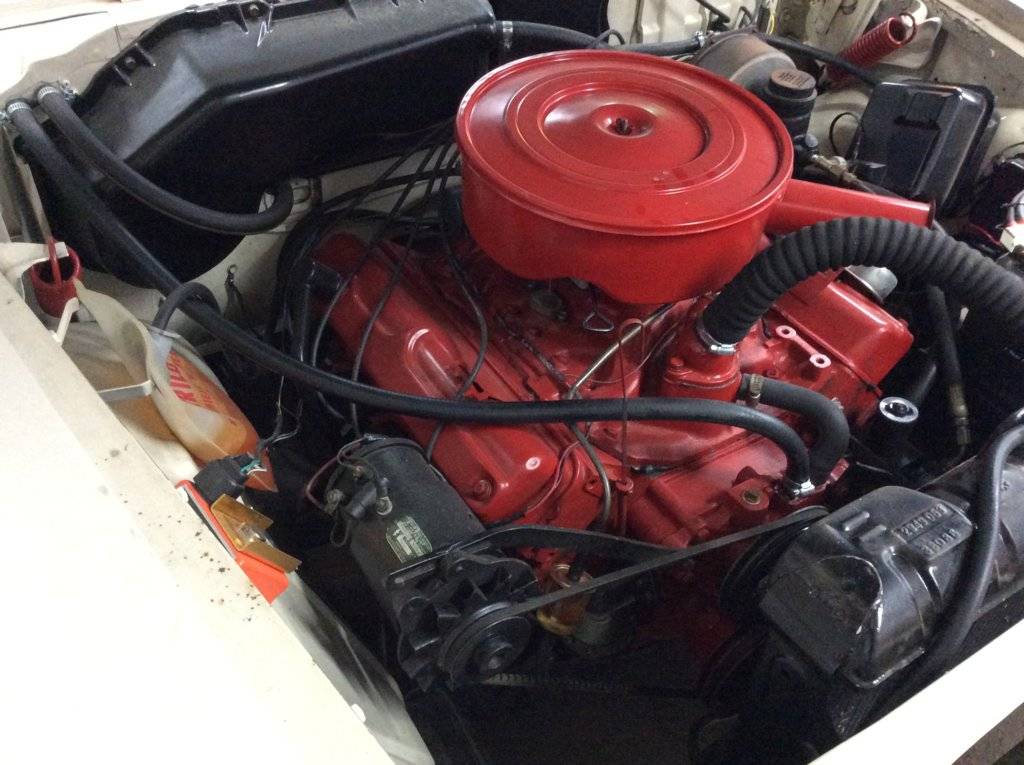

I hoping this is a simple affair and someone here has done it. It is a ‘60 Fury with stock everything 318 poly.
Any thoughts?

Since you have already done the ignition conversion, why not just go to an alternator, pretty simple conversion. Note, you should already have done this as the generator will fry you electronic ignition setup. Be sure to use an alternator with an electronic regulator. They are static suppressed, the generator and mechanical regulator are static generators which are not kind to electronics. Nice clean engine by the way.

You could also change to a Power Master alternator that looks like a generator.

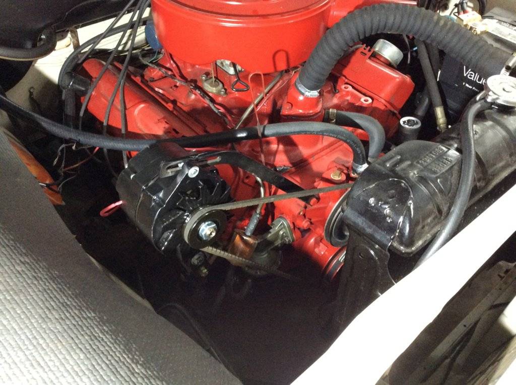

All done. Mopar generator to GM alternator. Needed the widely available adjustable bracket. Had to replace the crap bolts with grade 8’s so I could tighten it enough to hold. Instructions were as simple as I got here and on YouTube. Just have to connect the #2 slot on the alt to the main battery lead and lead to battery from the alt. Horn might not work in this conversion yet because I left the horn relay lead disconnected to power. Was tapped into the regulator. But I’ll get that done. On this car I had a gen light, it’s disconnected. And an ammeter. I disconnected the ammeter gauge because apparently they are not ‘safe’. In doing so out I had to connect the ammeter leads together to get power behind the firewall. Wasn’t in any wiring diagram. Headlights originally didn’t work but that is a completely unrelated issue.
