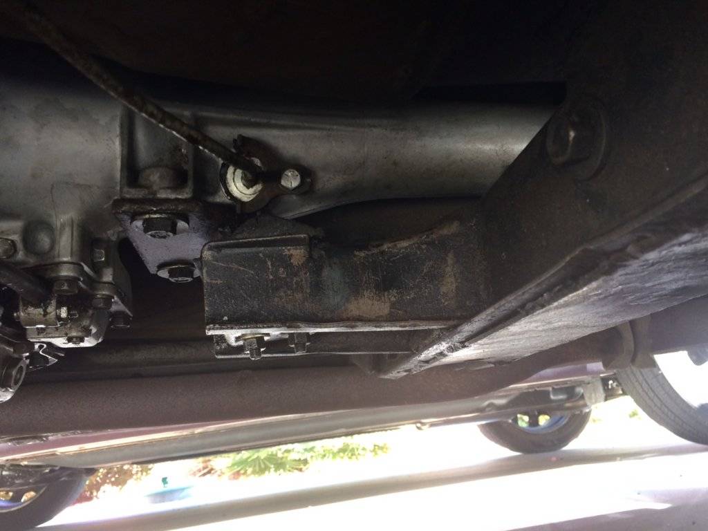

Update: Have all four new rims, new tires, driveshaft was bent and straightened (again, second time???), new universal joints, new axels which corrected 80% of my vibration problems at 3,000 RPM's when driving but still have noticeable vibration. I was told the "transmission mount" needs replacing but shop could not locate one here locally an told me to order and they would install.
If have gone to the internet and there it gets confusing. Some look a little different but the prices run from $6 and change to $150 and change. What am I missing? Any advice, pictures or part number would be very helpful so I order the right part>
Take a pic of the cross member and the mount. I thinkI can help you.
Here is a picture. Sorry this is the best I can do because I can't get under the car.
