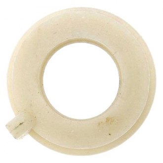

Evening all.. Need revive this old post.. OR! if you guys have some direction for me on another that explains / shows how to replace those plastic Knuckles / Bushings on the wiper arms that connect them all together under the Cowl. I can hear the laughter already!! Lol and you guys saying "Good luck with that one Pal" Lol Right!

Yes sir.. Those would be the little bastards.. One broke that connects the Link Arm to the motor, of course while driving home in the rain.. While attempting to replace the bushing on the one that broke, the other end broke as well. So I purchased a pack of them from EBay. Now I just want to replace all (4) of them. So I searched the forum and came across the old Wiper Arm removal posts. thinking that might address my needs, I was considering removing both the Wiper arms and pulling the posts / wiper links as a whole, replacing the bastard bushings then putting it all back in all connected. BUT! thought I'd reach out the "All Wise" C body crew for guidance first, because I can tend to make a mountain from a mole hill. If you know what I'm say'en.
