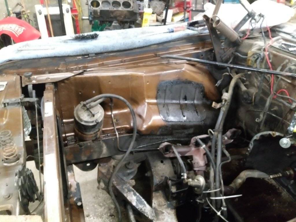

I feel your Ziebart pain! My Fury had so much it looked like it had been dipped. We used a bunch of wedge shaped pieces of wood for scraping and a propane torch to soften the really thick stuff. We used minimal solvents since the garage was not vented. Also had to be very careful with solvents because of the gas fired furnace.
It is like a tar based product --not like a rubberized undercoating.Thank God!

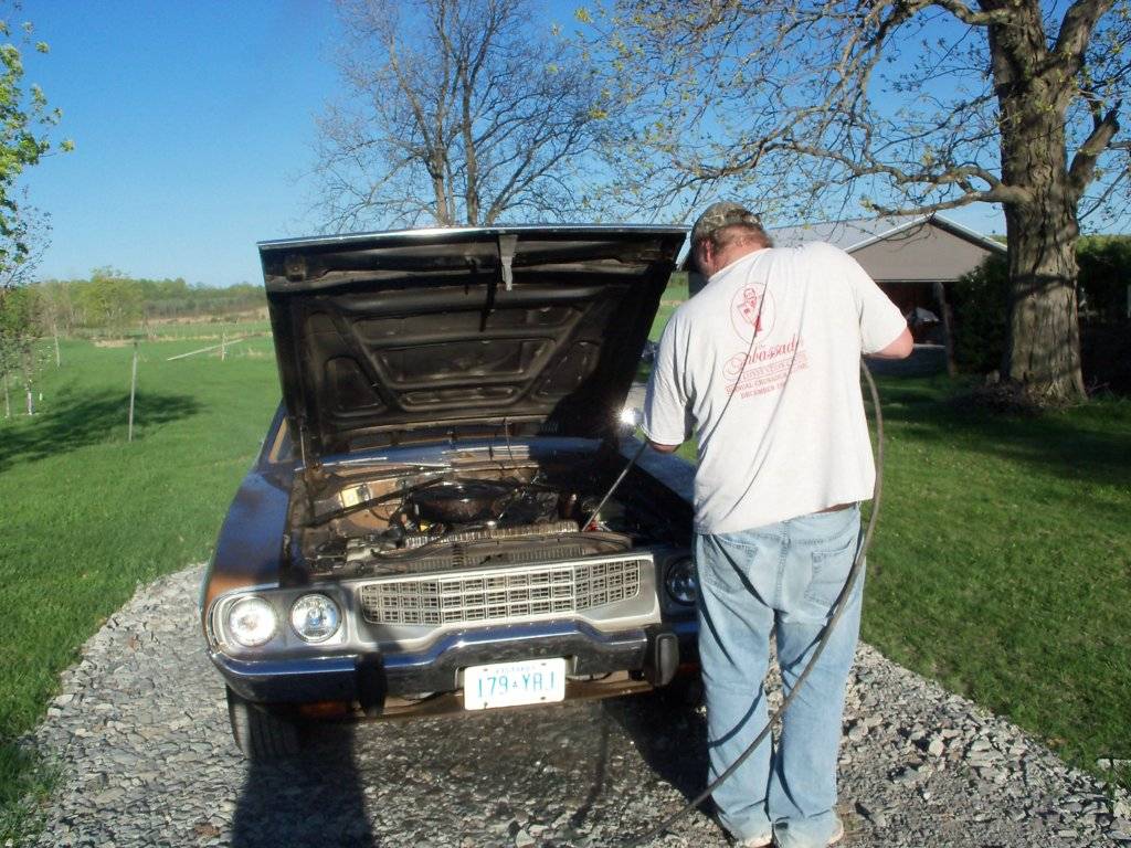

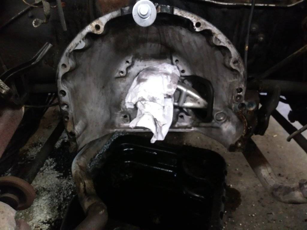

I tried a potentially dangerous method but it worked like a charm. Brake Kleaner followed by a high pressure water wash in small sections.
Not to mention the mess a pressure washer will make!
The paint overall on the wagon is in good shape despite it is a repaint from the late 70's/early 80's.
I have been very cautious not to get any solvents or splash up of the old Ziebart onto the paint.
So it is the hard way by hand.
We did pressure wash the engine bay once before but the old schtuff did not come off!

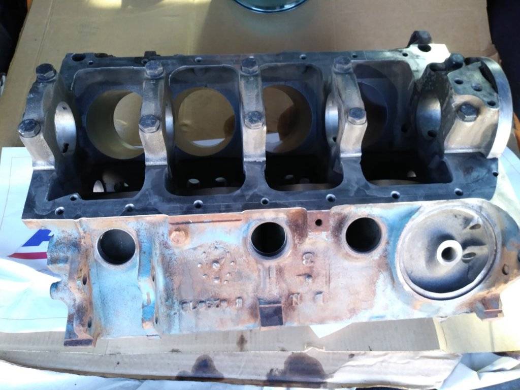

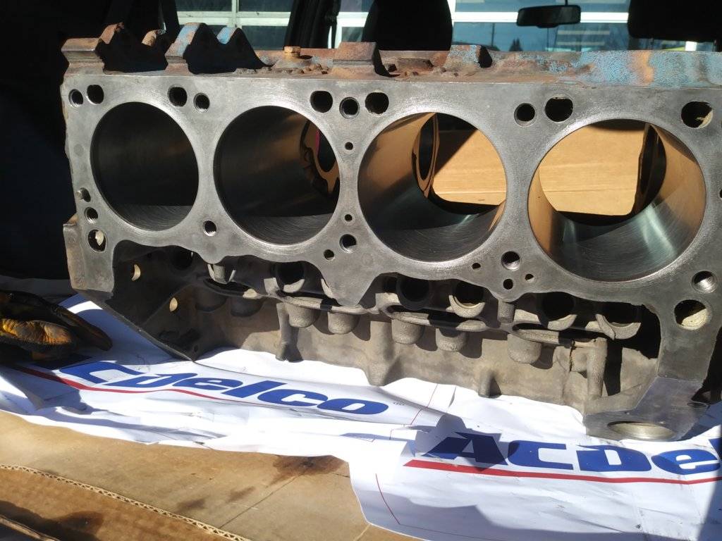

The engine got new cam bearings,test fitted the camshaft and brass freeze plugs installed.
A coat of high heat primer and Chrysler corporate engine blue..

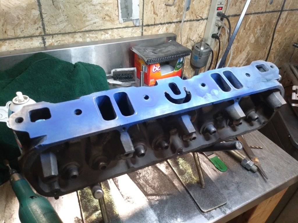

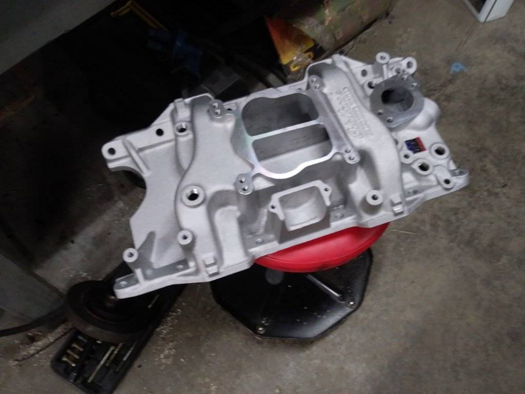

Nice purdy intake will also get some port matching.
I got a choke thermostat for a 78 Dodge p/u with a Thermoquad to fit this intake.
yes,I will be running an 800CFM toilet bowl on the 318!

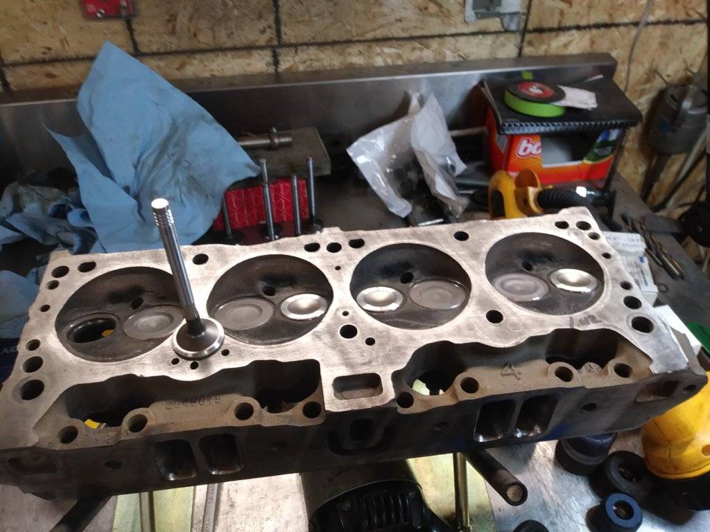

My buddy James did his magic on the heads.
New valves,3 angle grind,340 springs..
