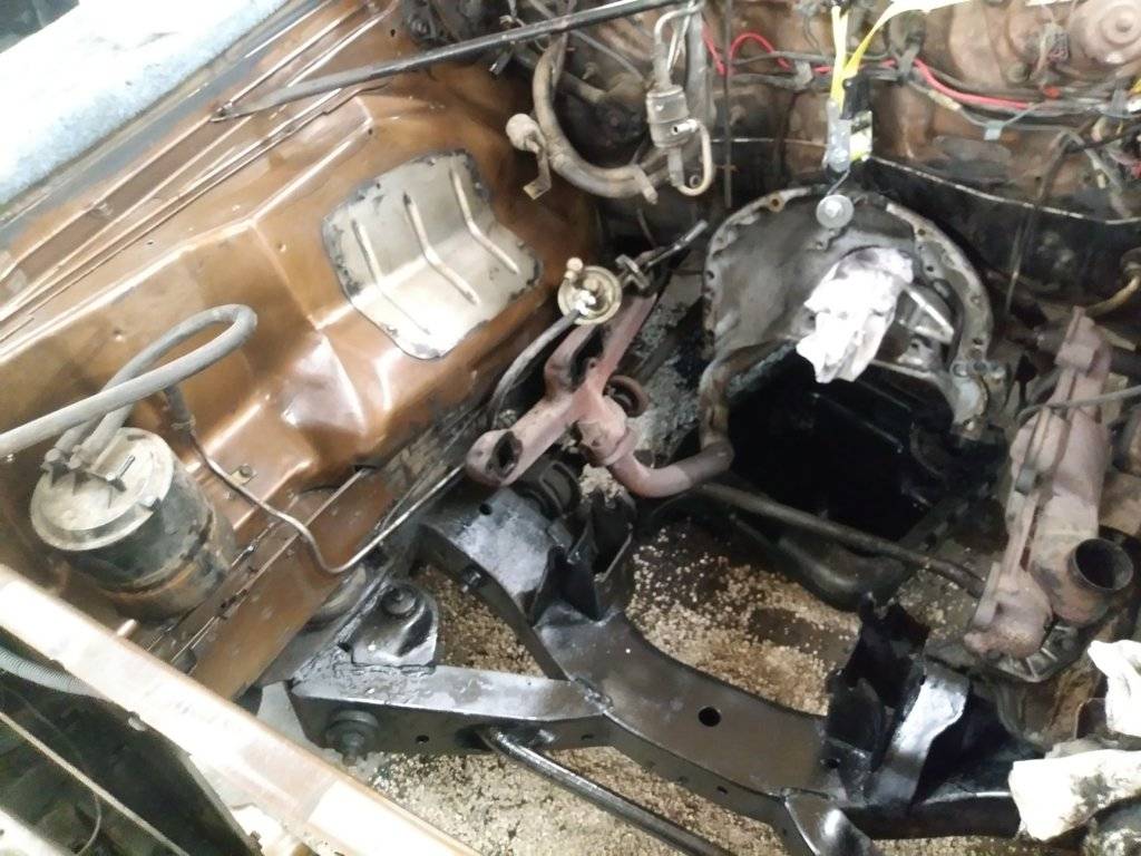

Finished up cleaning the engine bay as much as I could.
I scraped and painted the frame while I was at it.
With no power steering or other accessories,this part of the frame can be seen.
Decided not to do the firewall. Most of it cannot be seen when the motor is in anyways.

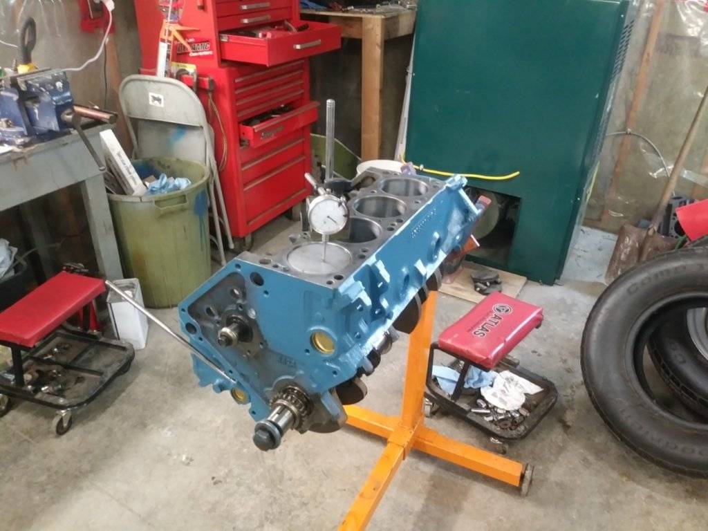

Cam and crankshaft installed. Checked the deck clearance....Typical 70's where the piston sits waaay down the hole..

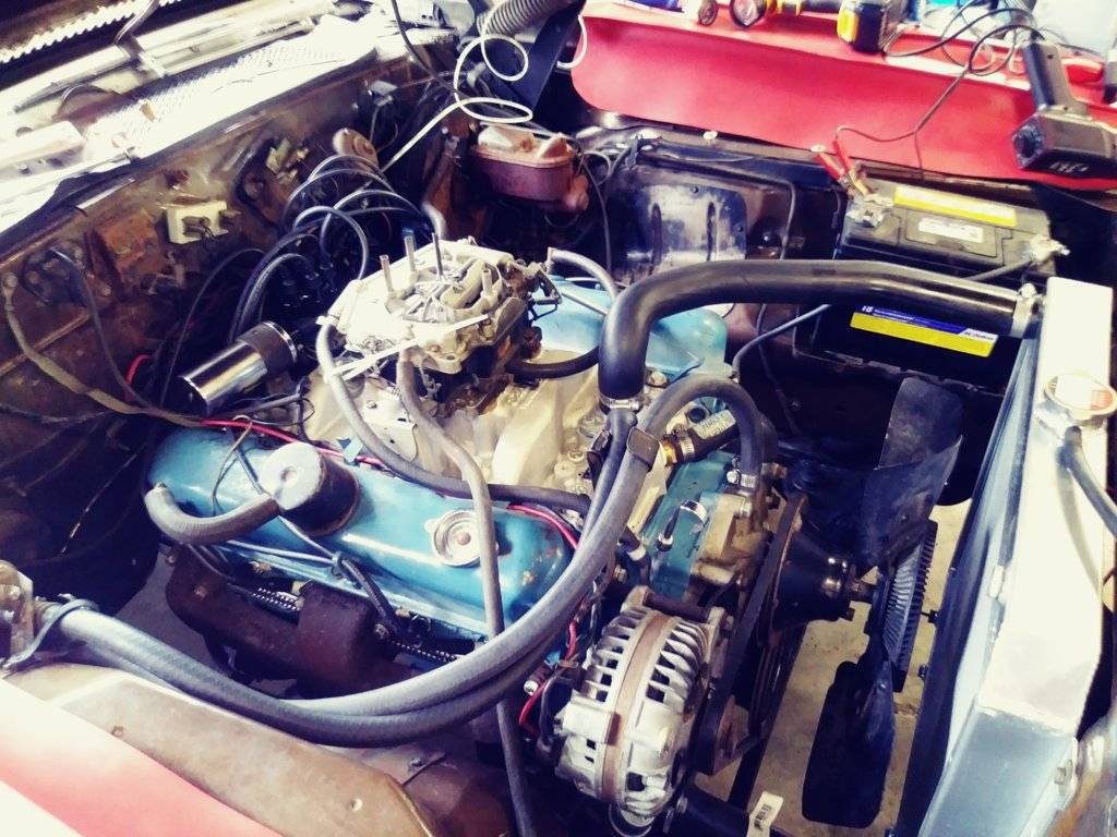

Past couple weeks been spending a few evenings dressing the engine for the initial fire and break-in.
Aluminum rad..had to drill core support to mount it.
Mini-starter...modified the terminals to fit the starter.
The electrical,cooling,and fuel system all in place.
Replaced all the rotted rubber parts,hoses,etc.

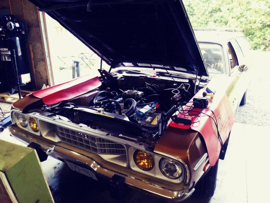

So today we fired her up!!
IT'S ALIVE!!
Tomorrow tack the pipes where they were cut,replace the fan clutch, fine tune the carb and timing.
The fan clutch in there now with the aluminum rad is too far away from the rad and is not pulling enough air.
I have another clutch with a longer shaft that will sit closer to the rad.
It did not overheat today but better safe than sorry since Waygun is my hauler and gets driven in heavy traffic.
The maiden voyage will also determine clutch adjustment.

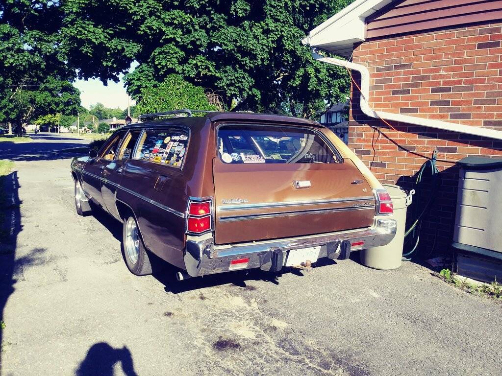

pic from tooting around...
Well it was fun driving the Waygun once again but only for a short time. I put her in winter storage right after this pic was taken...

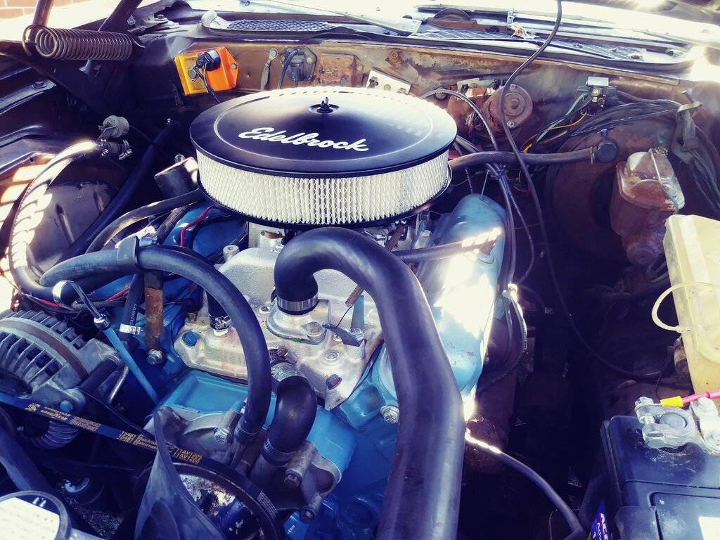

With the carb off Maggie's carb getting a rebuild, time to get the Waygun out.
I had the Thermoquad rebuilt last month.
It was not running 100% due to a dried out leather accelerator pump and dirt in the carb.
Today I jammed the csrb on and drove to my Buddy James place to disl in the 318.
The motor was not happy on the drive and we put in a hotter ECU. Still a flat spot.
Swapped in a recurves distributor.
20 degrees initial and 35 all in at 3 grand. 18 inches of vacuum.
Better but stll flat spot.
It needed more squirt of fuel on part throttle.
That is very important to me since being a standard and no dashpot.
James put in larger squirters from a 340 TQ parts carb.
Accelerator pump adjusted to the max.
Runs 100 % better!!
