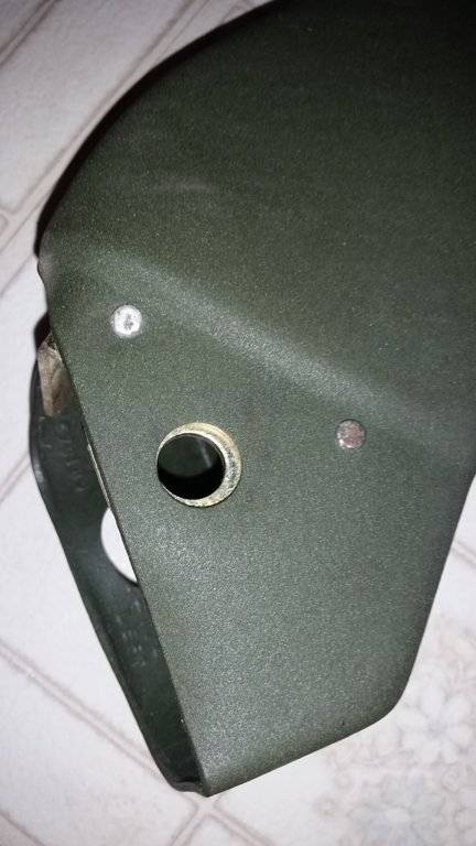

INSTRUCTIONS ON HOW TO FIX
Difficulty : easy
Things you will need:
13/16 socket
Socket extension
Socket wrench
Something thin to pry with (paint scraper)
Needle nose pliers
Oil
How to do:

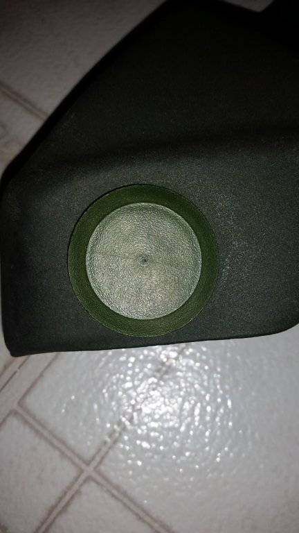

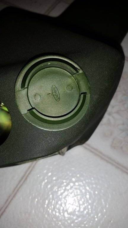

First pry off round cap
next take your socket and undo the bolt holding it on. You need to be tough as nails at this step, but it will come off. Then remove from the car.
Then pry off the two holding pins. I did it underneath with a paint scraper so as not to scratch it up where you can see.

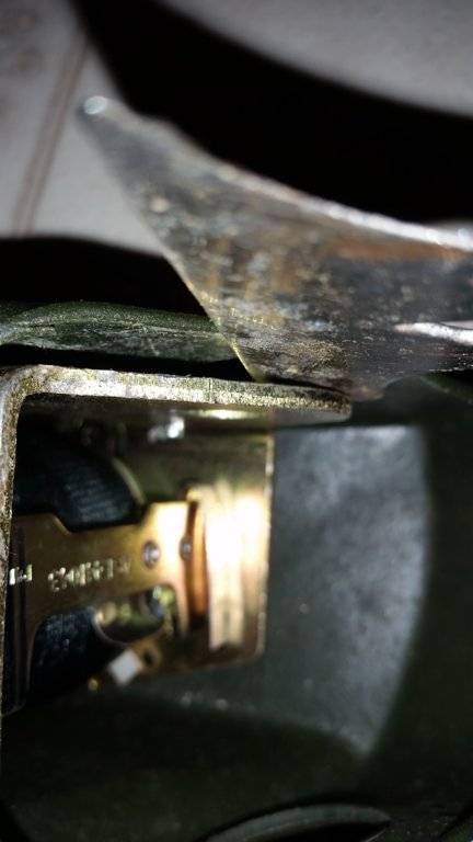

Now pull out the mechanism, don't worry about the seatbelt, let it stay in the plastic sleeve. Now find where the spring end is. It is pointed out in this
Push against the spring with a finger so it doesn't fly out. Then take your needle nose pliers and pull the spring up and work it around once to the same spot. Tightening it one turn. Pull the seatbelt all the way out. Repeat another turn of tightening until the belt won't pull out all the way because the spring is too tight, then undo one turn. Now put some oil on the spring, and both end points. Work the belt a few times to get it moving. Next oil between the plastic and metal pointed out in this picture.
Now work the belt a few times. It should be much better. Now put it back together and you are all set!
