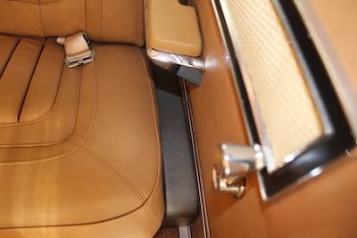

Damn, just put my back seat in again - could have taken a pic while it was accessible.... Okay, the package shelf part goes in, then the side filler strip sits on the outer edge of the package shelf and there's a couple screws holding it to the inside of the door - be sure you install these before the inner door panels 'cause the inner door panels sit on top of the side filler piece. Wait - I have one open and can get a pic. Back later.............
That would be the passenger side rear seat back filler piece.
Here is a pic. of my drivers side installed. Yeah, they are very brittle after all this years.

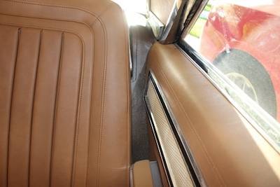

Okay, I forgot the seat's not all the way out.... but I shot a pic or two. Rapid's are better looking by far though. This one kinda shows how the side strip overlaps the package shelf.

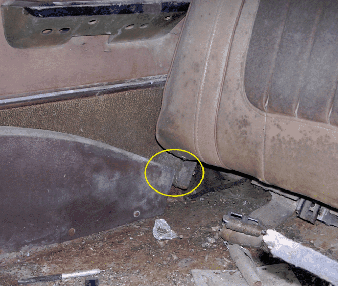

And this one shows how the bottom (in the yellow circle) ends.
Ouch!
If those are in one piece they should clean up o.k. Just handle them with care.

You guys are wonderful. Sent pics to shop. Still would like to know where Rapid got his beautiful looking rattan insert material.
The Rattan you see is original to USA 66 MONACO 500s - not sure if 65s had it too. Rapid likely cleaned and redyed his. It does look great, doesn't it?!
