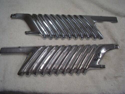

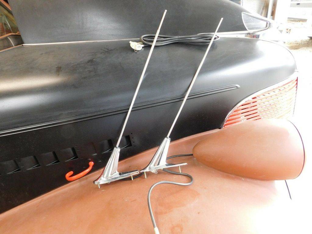

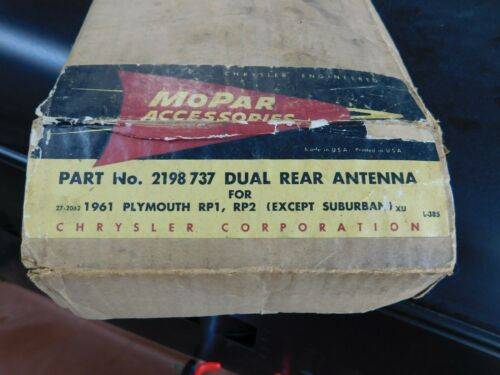

I have scored a couple of extremely hard to find items for Virgil in the past week. In the 7 years I have been collecting parts for him I have never come across either of these items NOS.
A NOS pair of Fury body side chevrons. And a NOS pair of genuine Mopar accessory rear dual antennas for a 61.
Happy me, (And Virgil).
Nice !! I saw those chevrons. Are they for a coupe? or 4dr. Good score on the antennas. I have a 63 300 that has a rear antenna that is broken, but has the long factory lead to the radio if your kit does not have the harness?

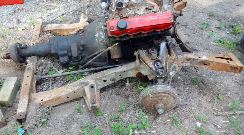

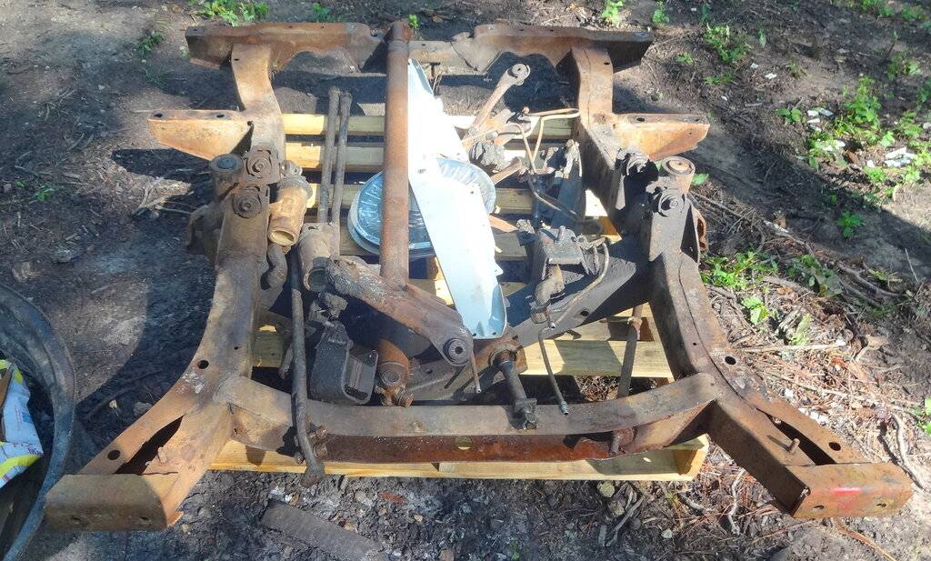

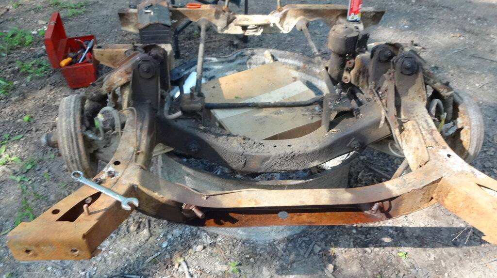

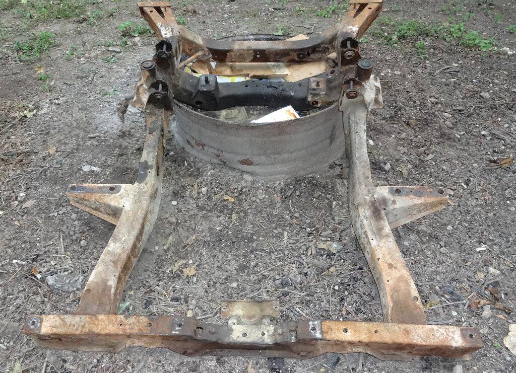

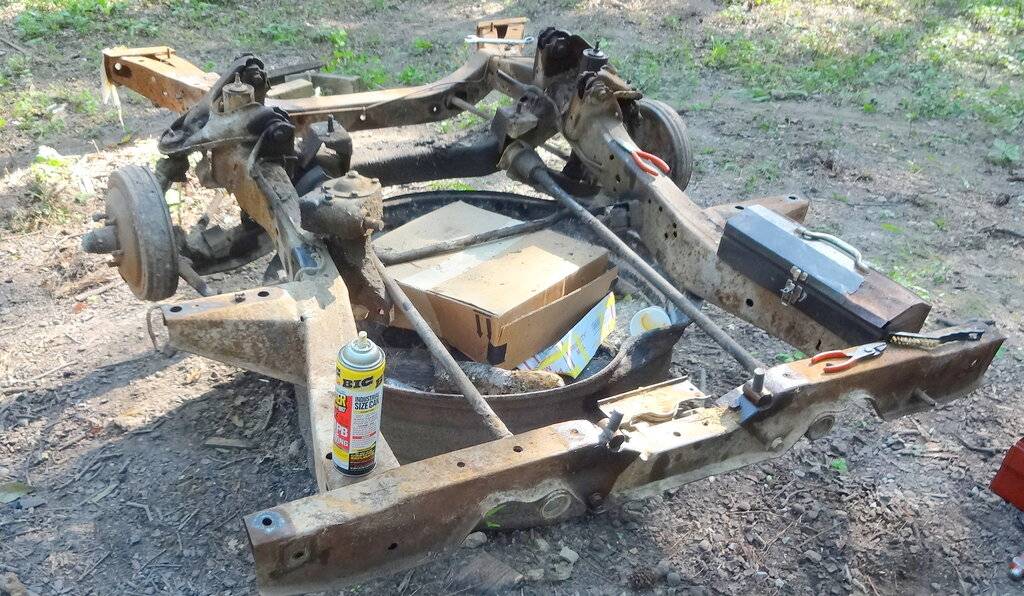

I pulled the near mint condition stub frame out from beneath the donor car and got it disassembled. I'll build it using both stub frames. My original 318 poly and torqueflight will go into this stub.
Virgil got some love this past week. The stub frame and all componants have been stripped and refinished. New control arm bushings, new ball joints, new strut rod bushings.

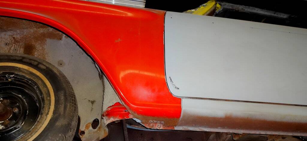

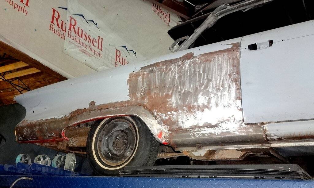

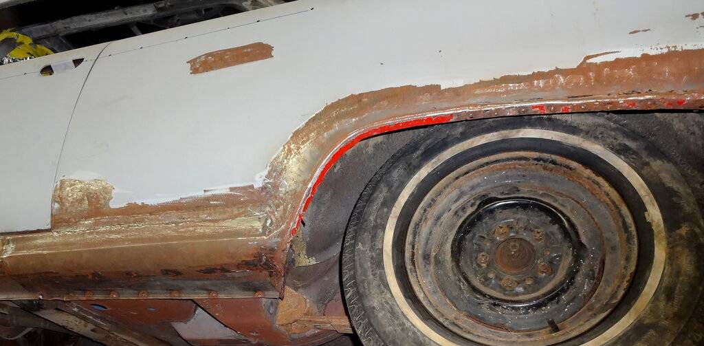

The left side quarter panel has been ruffed in and metal finished. Small patch in the drivers door. We discovered that the 4 door rear body contours are different than the 2 door. This required some panel fabrication, about a 3 foot section formed and welded into the mid section of the quarter panel. The 61 Plymouth has some strange lines. Nothing goes straight. All will be metal finished so that just a thin skin of material will be needed to prep for primer.
I took a bunch of photos but left the camera at the shop. So photos later.
Next week he comes apart and placed back on the rotisserie to finish the floor pans from underneath and sand blast. I'll detail the engine & trans and reassemble the stub frame.
