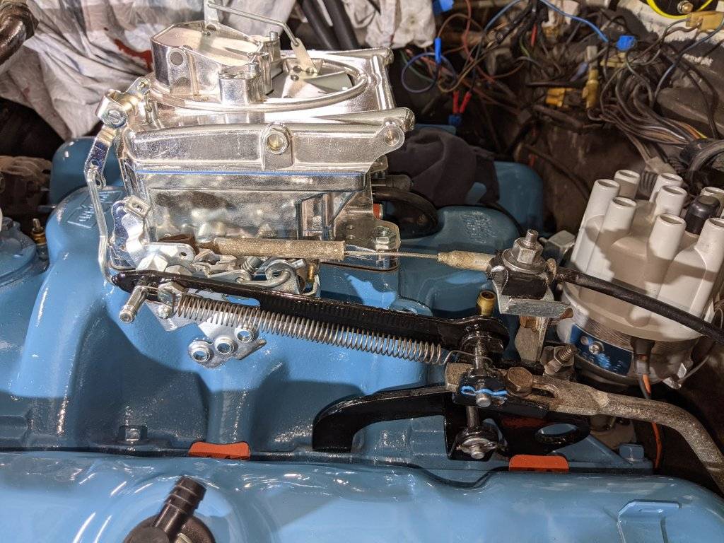

First, check the adjustment of the throttle linkage from the trans to the carb. Follow the service manual for the easy procedure.
Next, as seems to be really common with these transmission leak "diagnosis", chances are it's not coming from where you think. Generally, it's the shifter shaft seal that's leaking and that's not too bad to change.

As Big John suggested, check the throttle linkage from the carb to the trans. Since you say "some shifts" are quite hard, could the linkage be binding, or could the return spring be weak, misplaced or missing? It would be a shame to replace the trans unnecessiarly. Throttle affects shift points and harshness. Just a thought. Lindsay
Yes, thats what I meant. It used to always shift very smoothly so that I'd hardly notice the change of gear. Now some shifts from the first into the second are quite hard.
I also agree with adjusting the rod in the slot. Pull lower rod 1/8 inch forward and see if the shift points change. Probably not off by much since it was right.
