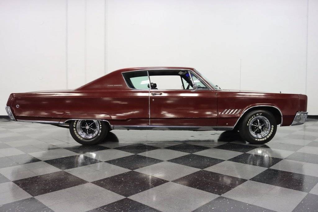

I used monroe HD on the front and monroe load assist, dont remember excactly what they were called, but they did have coil springs around. Road real well. I did have to raise torsion bars little to compensate for rear height difference.
This is what it looked like on level ground.
