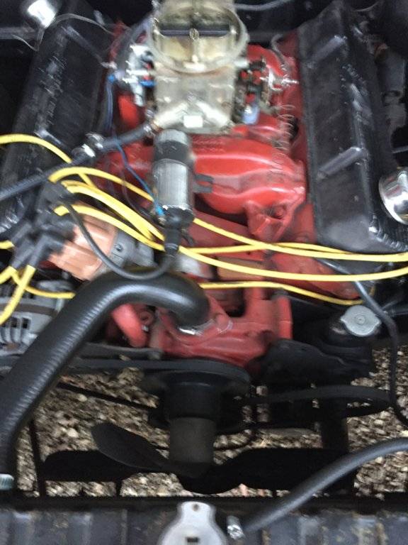

    So clearly I have no idea what I'm doing!
    While we're rebuilding the 66 motor I decided to order a tune up kit from rock auto for the 78 440 that's in the car now. It's running a little rough and I'd like to be able to motor it around to get it sorted mechanically.
    The plug wires are in bad shape so today I started replacing them and realized the distributer cap I purchased isn't going to fit this NAPA distributor????
    Has anyone ever seen one of these? I'm having trouble gathering any info on this unit.....

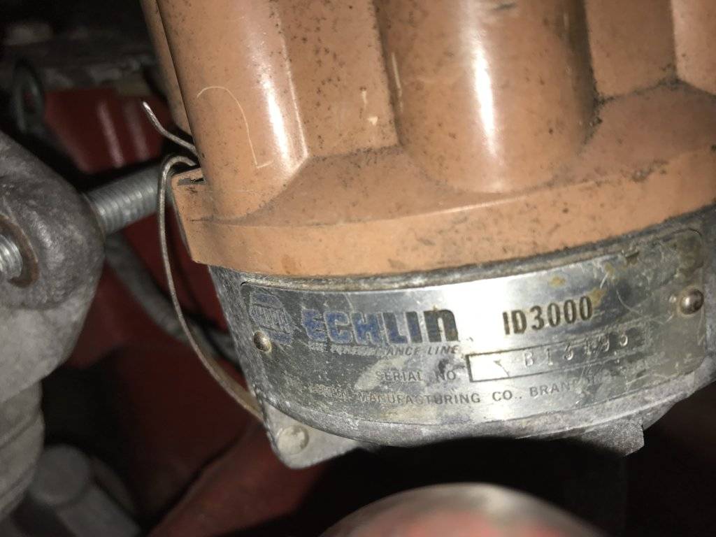

    Aftermarket dual point aluminum distributor. Made by Echlin, a NAPA company that supplied American performance products back in the day.

    As mentioned, Echlin was NAPA's ignition line. The performance end of that was ACCEL, initially. Until ACCEL became it's own entity in about 1970 or so. One of those "hidden secrets", at the time. NEAT find! Congrats!

    It's an aftermarket distributor. Echlin dual point, same as an Accel dual point of that vintage. Echlin owned Accel and some parts were sold under the different names.
    If you are trying to match the cap up to a production Mopar piece, forget it. It's not gonna happen. But, it doesn't surprise me at all that a GM cap would be the replacement. They design and standardize from the breaker plate up, up, then build the rest of the housing and shaft to fit the application. You'll find that cap/rotor/points/ used in all the Accel/Echlin applications. Ford, GM, AMC, Mopar etc.

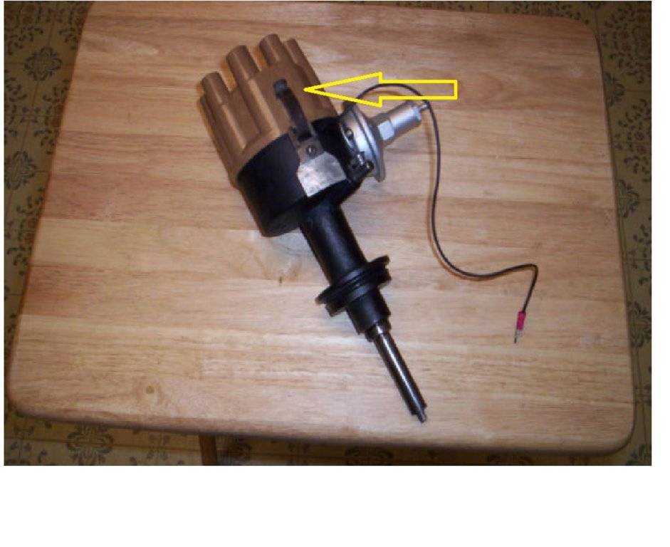

    Yes. but that's NOT a Prestolite distributor.

    A Prestolite cap for a Mopar dual point has the clip snapping in much higher on the distributor cap.
