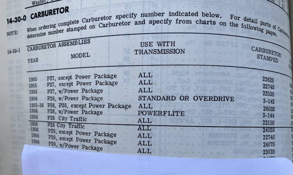

According to the manual, the stock carb was a 2530s. Mine is missing and I'd like to be able to use the stock air filter can. What should I be searching for?

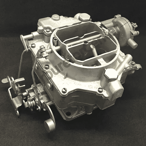

Something like this: 1956-1957 Plymouth Carter WCFB Carburetor
Wow, thanks but too rich for my blood. $800. since I don't have a core? Are there other model #'s that would work other than the 2530? What do those #'s mean?

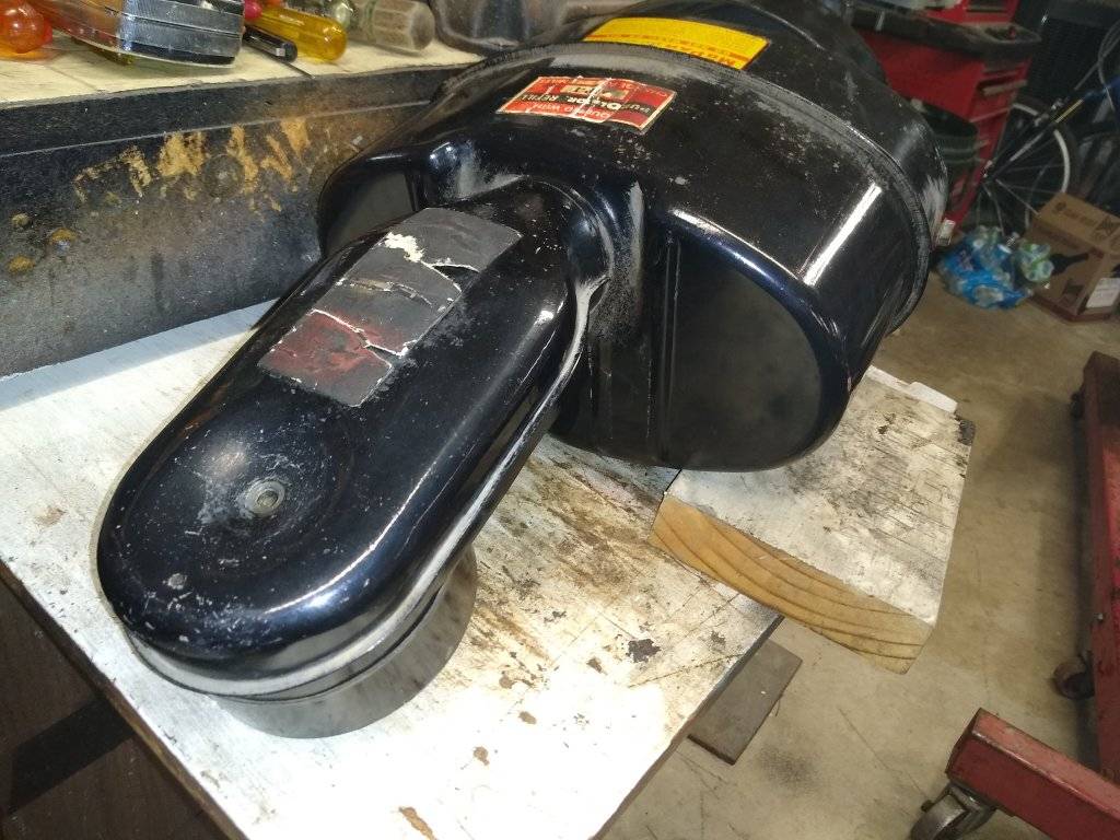

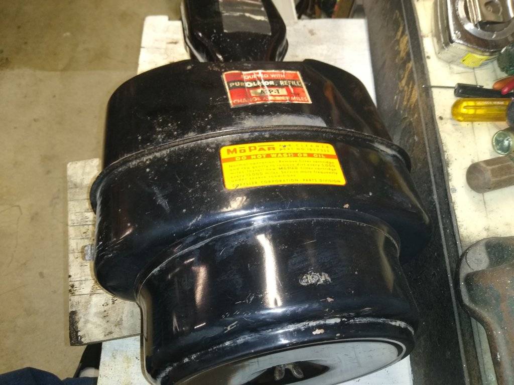

Thanks Cbody, I'm stuck on the bombastic original air filter can. I'm really bored with the same old AFB with the chrome air filter can. To me, it means a lot to see the original filter can on the engine and is sort of like seeing and appreciating the dash board gauges. I'm always disliked the restomods that replaced all the dash gauges with modern ones, what's the point in that?

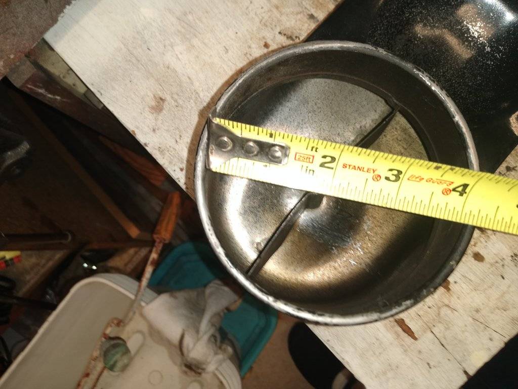

No need to go with a chrome aftermarket air cleaner. Just be looking around for an OEM 4bbl Chrysler air cleaner from the later 1960s or so. Even one of the non-snorkel open elements as some of the '65 Plymouth 4bbls used. Then all you need is the adapter noted. Or a '68 Road Runner air cleaner and no adapter. Swap meet stuff. Does the WCFB use a center stud or does the air cleaner base have a clamp that goes around the carb air horn?

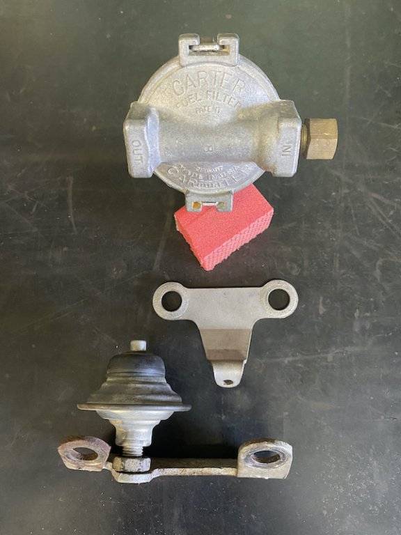

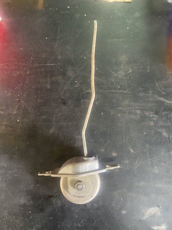

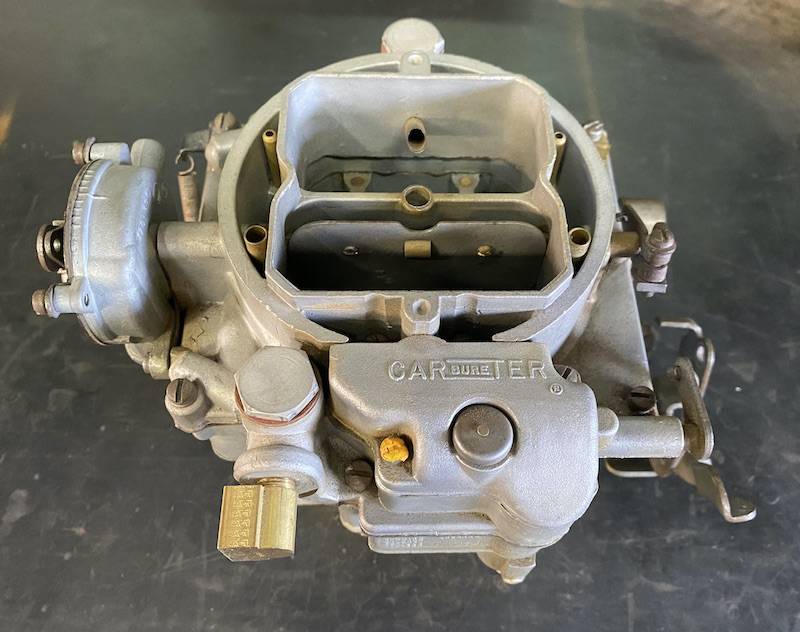

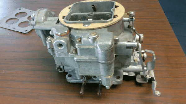

Hey Rusty, I have a rebuilt ready to go "Power Pack" 2302S if'n yer interested.
This was the optional carb for the 301/313 in '56 and would work and accommodate your air cleaner.
Includes the glass filter, return spring bracket, thermostatic choke and Dash pot (throttle stop). $300IMG_4071.jpegIMG_4067 copy.jpgIMG_4065 copy.jpg
