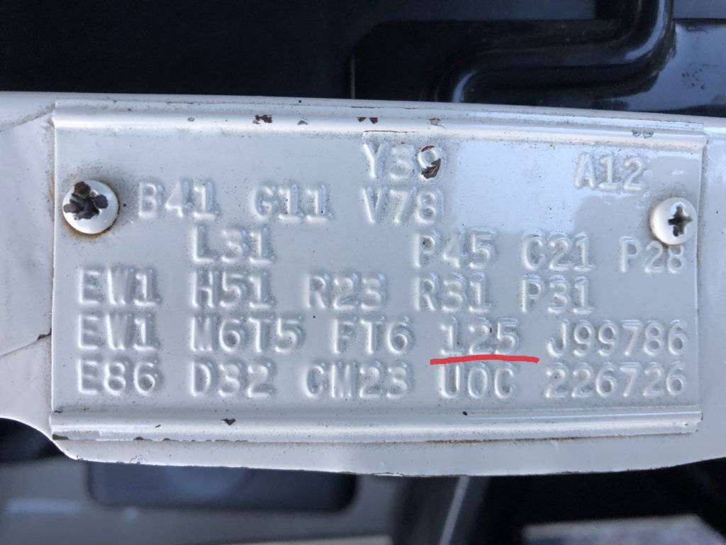

Whoa watch out now, I might have learned something. Trace, I thought the build date was on the very bottom line. It is on the Valiants. Do the different plants do different things on the tags?
I looked at that car at Nelsons and he says he's only interested in bulk purchases. I only would want the one car. Maybe we could get a group together and go in with a car hauler. Although, the supercharged Packard wagon would be cool sitting next to the Imperial in my garage...
I am not an expert on fender tags by any means, but I do know those numbers on my tag are the build or perhaps "target" date...maybe it came off the line in the wee hours of the 26th....dunno. There are a number tag decoder site on the 'net. Not all of them know everything, as the site I used MyMopar - Mopar Forums & Information - 1969-1974 Mopar Fender Tag Decoder didn't correctly list the reason for the A12 code. It thought it was for 1969-only Six Bbl engine, and it's obviously not the case with my 70 Hurst. Everything else was correct, though.

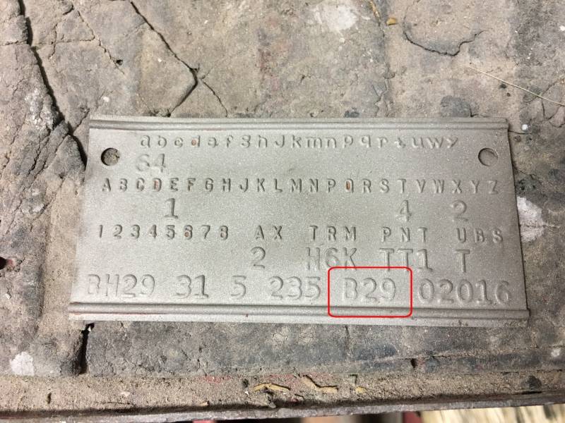

68 and older fender tag the date was on the bottom line.
My GTX and I celebrate the same birthday!! Favorite car, favrit colors! Found it on a road trip on vacation. What are the chances?
My 1996 New Yorker has an SPD of May 6, my sister's birthday. That's good enough for me!
413 that is cool. Did you buy a lottery ticket when you found it? That makes sense about the fender tag, all my Valiants are 68s.

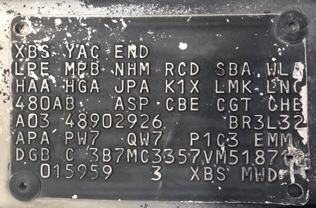

Was walking through the shop and saw this 1997 D3500 on the hoist. Still putting fender tags on them back then much to my surprise....
I’m pretty sure my ‘01 has a tag and I had an ‘02 pickup that definitely had one.
