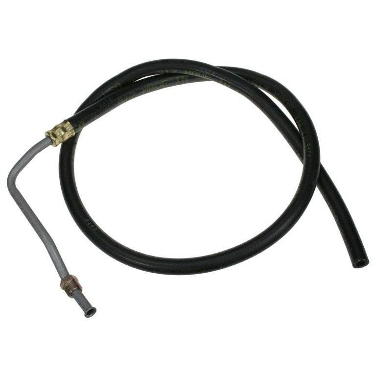

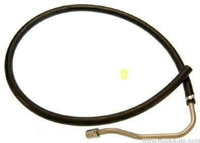

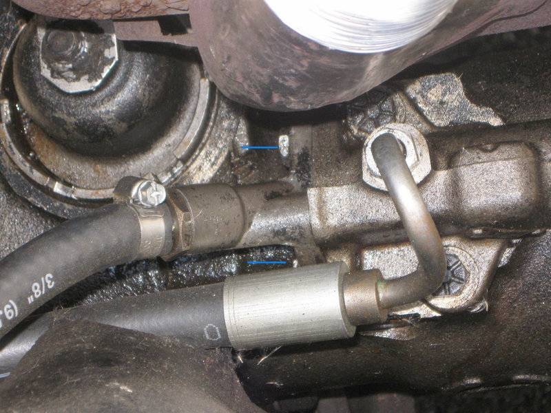

Here is a company still selling a return hose that is guaranteed to fail and I know first hand. Edelmann vs. correct

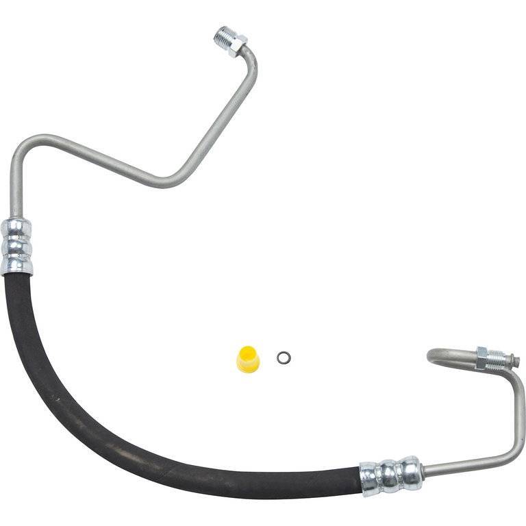

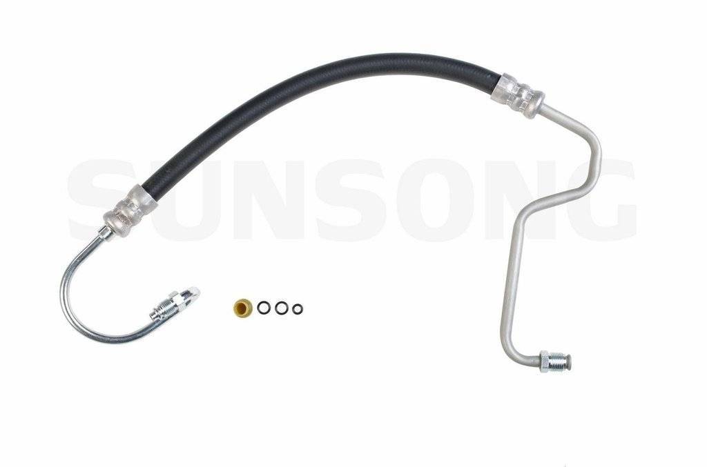

Here is what Gates shows for my car. Does that end look anything like the one I have which is an exact copy? Second one from another company is even worse and these are under 1973 Dodge Polara.

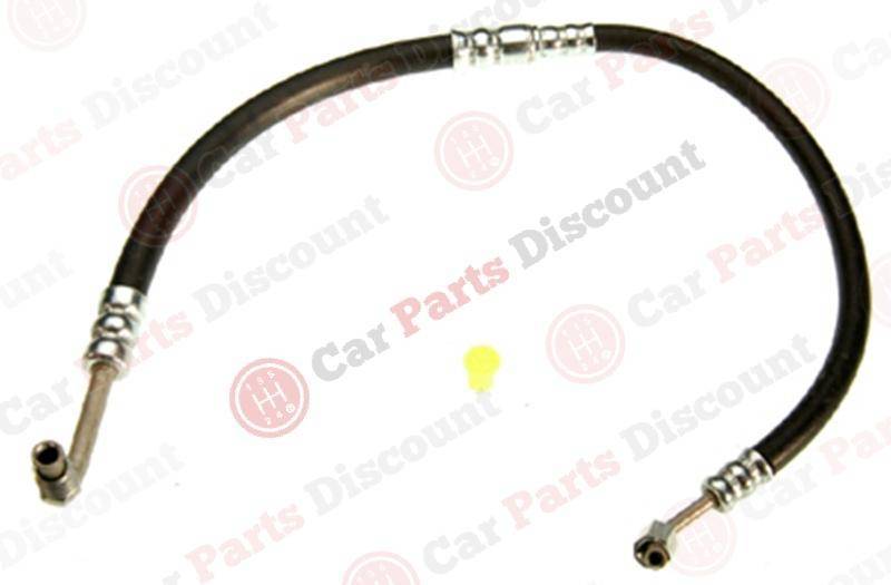

That's horrible.. Well, thanks for taking one for the team! I'm looking at tube and hydraulic hose shops in the NYC area right now.. found a couple that look promising. In the meantime I just ordered the Gates replacement #352700
alternate part #15375337

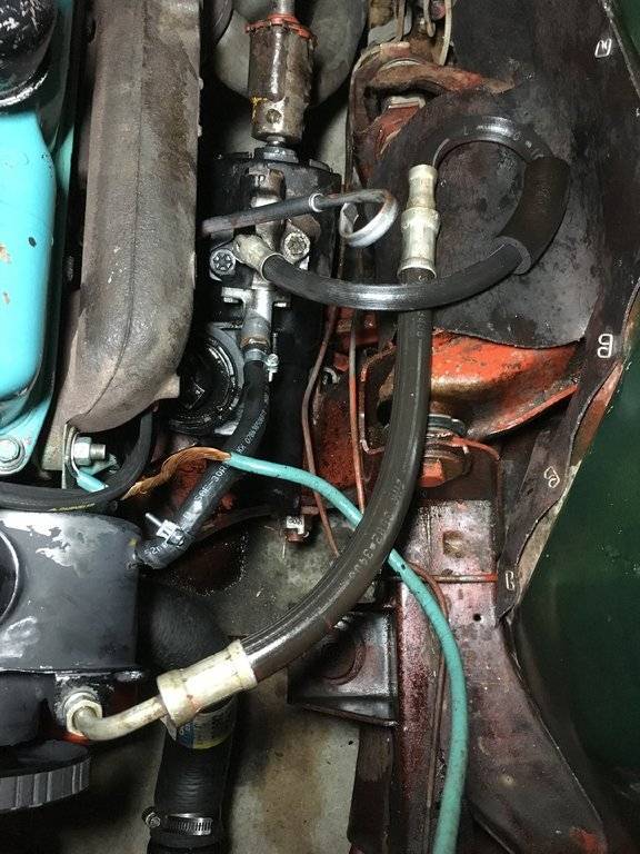

Here's a photo of mine on the car last night right after the spraying mess... and a photo of the Gates unit I just ordered 5 minutes ago. I'll report on how it goes shortly, as I'll be receiving the part by Tuesday and installing Wednesday. It's a bit of a brain twister following the hose bends to see if it will fit.. it seems correct from what I can tell.
The OEM hose from Chrysler, back then, used to all exit the gear and go toward the firewall before gently bending back to the power steering pump, plus a rubber sleeve where it laid near the suspension deflector flap. Plus having the stepped diameter in that bend area, too. What was on our '66 Newport was a little different from what the '67 Newport came with or what my '70 Monaco has on it, so some minor variations in the OEM hose, but the hose will probably fit from '65-'73 or so. Not sure if the pump fitting is the same between the "big" pump and the "Saginaw" pump, though. The only line that will look like or similar to the original will probably be from Chrysler (if available) as the aftermarket vendors have a habit of not always being faithful to the original design. I'd seek out the one with the stepped diameter joint, as that's the way the factory hoses were.
Seems like the Edelman hoses, back then, were "different" in some respects but probably worked fine. Not close enough to the OEMs for me, though. Usually, Gates is a premium brand that works well in other hoses and such, but seek out their "Green Stripe" items, where possible.
