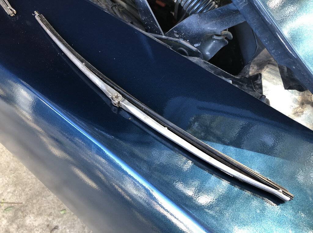

Resurrecting this old thread as Medina and I got caught in a downpours on Monday and the wipers need changing (driver's side does not wipe properly, plus both LHS and RHS are incorrect -- too high, not stainless, don't retract perfectly unless helped manually).
I found this set of Anco 16" repros sold by Classic Industries -- looks good to me, thoughts?

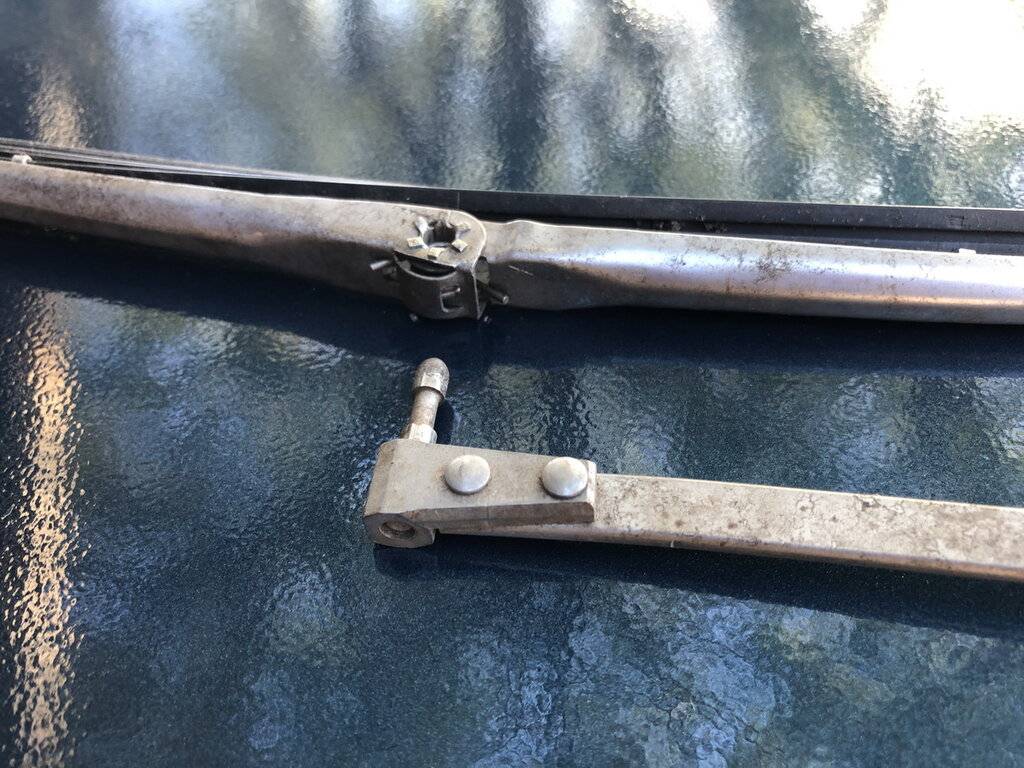

This is what should be on it, this is my 69, the metal frame seen in the first picture should not be replaced, only the part that clips into it.
Alan

On our 69 Fury, I scored an original set of stainless 18 blades from a car in a yard.
I replaced the refills and the wipers do clear the glass nicely and retract properly.
It takes a bit of time and work to make the refills fit the frames but worth the trouble.

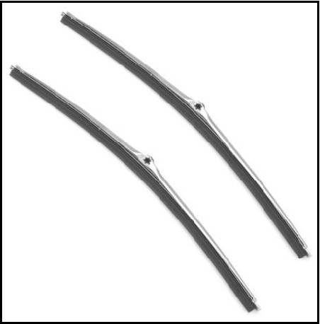

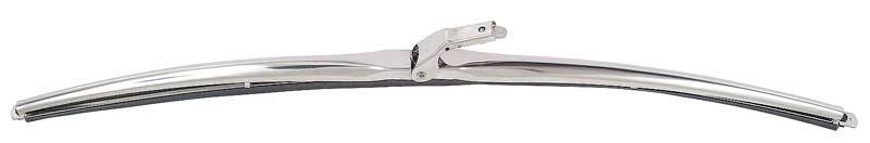

Thank you @MrMoparCHP -- it looks like these are two different blades. MoparMall seems to have the correct reproduction blades:
''Hideaway'' windshield wiper blades for all 1969-71 Plymouth Fury; all 1969-71 Dodge Monaco - Polara; all 1969-71 Chrysler and all 1969-71 Imperial
Edit: I found another FCBO thread with lots of pics after I started searching by the part number (P/N 3431465 ) for 1971 wipers.
Thanks for this! I just ordered new blades and two other items!
