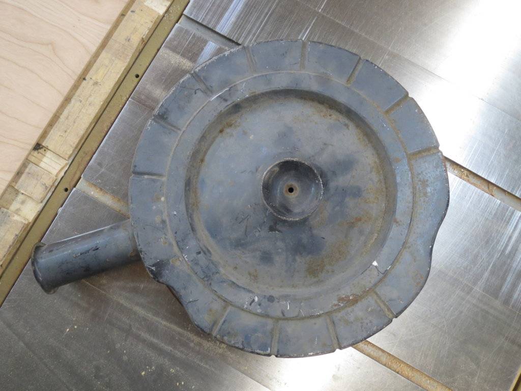

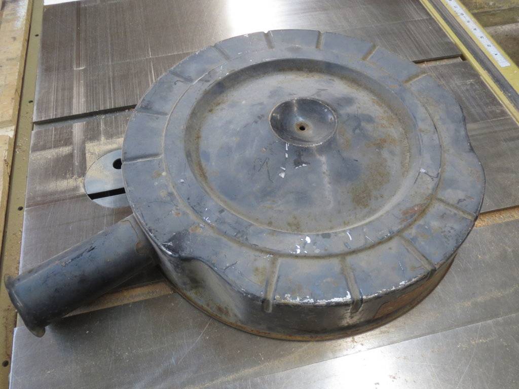

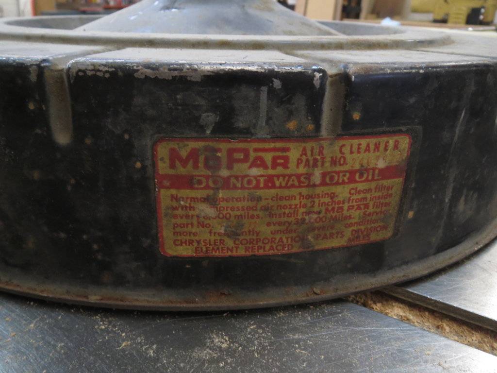

I’ve got this top that I’d part with for $40 + shipping.
View attachment 303968 View attachment 303969 View attachment 303970
For the record, I ran across that basic housing with NO snorkels on it, factory chromed, at a swap meet about 25 years ago. I think I paid about $30.00 for it, then it got rechromed along with some other items a work associate was getting chromed for his race boat (pricing by the batch, rather than individual pieces). No evidence of a snorkel ever having been cut into the stamping. Seems like it was a factory item in the middle '60s on some 413s that also had factory chrome valve covers? I think I saw a picture of that "dress-up package" somewhere. Still have it.
Enjoy!
CBODY67
Pics or I don’t believe you.:lol:
