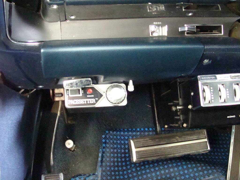

Have you ever seen this after market unit?
