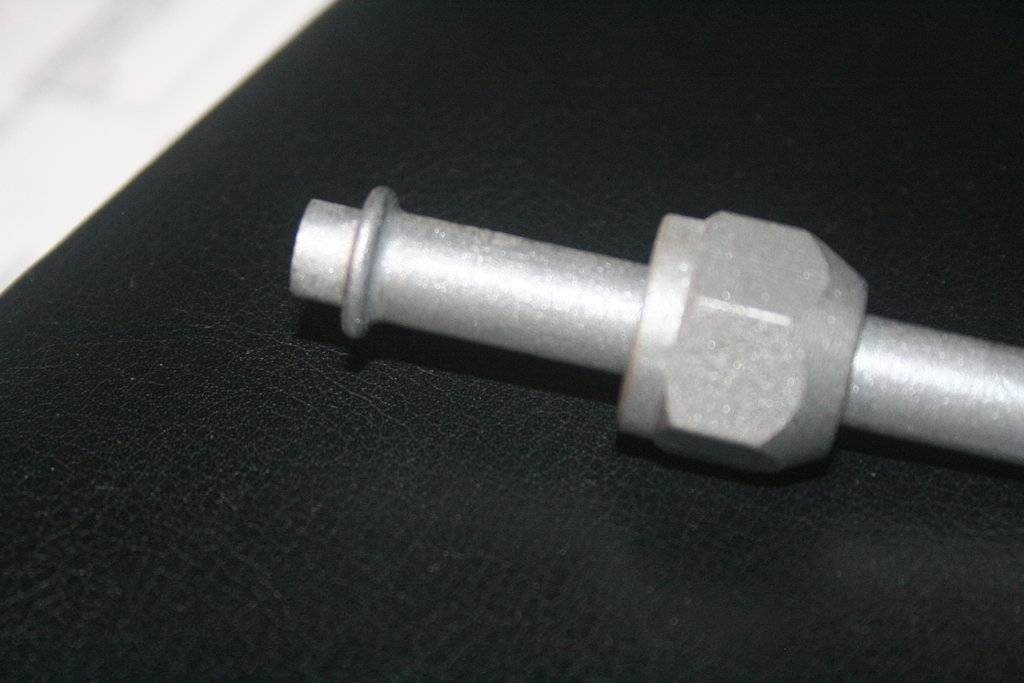

What is the proper name for this type of connection. This is the steel line that runs from the drier up the passenger fender to the firewall. I would like to create some new hard lines when I do the conversion, but I cannot find the nuts. Most likely because I'm not calling them the right thing.

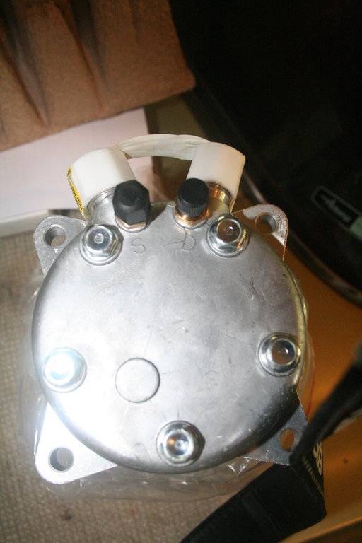

The objective for today is to remove some of the old stuff and start fitting up the new stuff so that I can make brackets and figure out hose sizes, lengths and end orientations. As I looked at the new compressor I have a curious questions.
What are the two ports on the back with the black caps for?
Do they make it unnecessary to have two connections like the ones below?
Thanks for the help.
"Metal debris" in the system, from a failed compressor is not good. Many compressor vendors also want to see the drier and such replaced along with the compressor. There used to be a flush fluid we'd get from NAPA, but the price rose to $50 for the gallon jug, then unobtanium. Some used water or brake cleaner, with mixed results. GM finally came out and said to use an inline filter and change it when it got plugged/restricted with debris. There are/were several configurations of the inline filters. The "pancake" version is quite obvious. Be sure to get the filter without the orifice tube built into it, get the one that is just a filter.
