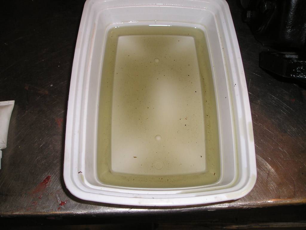

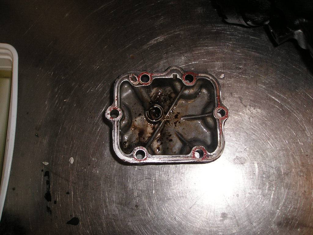

I'll give you my recent experience with (2) Four Seasons compressors.
They come with 3 oz. of PAG oil in them so you will need to drain that out and use mineral oil if you're going to stick with R-12, as I did.
Here is a picture of the oil when I drained it out of the REBUILT Four Seasons compressor.
Suspicious, I pulled the sump and discovered the pan was dirty and the spring was missing for the check valve.
I called Summit, complained and they sent me another one.. Second verse, same as the first.
Dirt in the oil and no spring.
I'm going to clean it up, pinch the spring out of my old compressor and use it, but I'll never buy a Four Seasons item again.
Absolutely outstanding information, thank you. Any info on the EPR? I guess I can begin to disassemble and clean my 4 Seasons now, in prep for the whole system job in a few weeks (when the weather cools just a bit!). I've heard tell that the remanu's are basically a new seal and a new paint job. Your pics kinda back that story, huh?

Suspicious, I pulled the sump and discovered the pan was dirty and the spring was missing for the check valve. View attachment 209087 View attachment 209088

My 4 Seasons unit DID NOT come with an EPR valve, cuz I pulled the port cover off for a look and it's not there. So, cannibalize your existing EPR, soak it in lacquer thinner or AC flush in a closed glass jar and try to "back flush" it to get any junk out of the tiny holes in the valve guts. Compressed air is fine, too, but NOT brake kleeeener, as this leaves a residue, believe it or not. (This from Classic Air). Note regarding the EPR: It's raw steel and will corrode very easily due to humidity. No fingerprints, always have oil on it once it's clean, and keep it in a ziplock when it's not soaking the thinner or going back in the compressor (all nice and oily). As has been discussed, the EPR prevents evap freeze-up with 12, but isn't needed with 134. (Again, advice from Classic)
My 4 Seasons unit DID NOT come with oil pump check-ball and spring. I don't understand this. Does the re-manufacturing work include some flow restriction orifice that negates the need for some back pressure on the system? I don't see anything up the check hole. Regardless, I'll be cannibalizing that item from my existing RV-2, too.
By pulling the sump (fortunately, the reman gasket came apart easily and will be reused), the 3 ounces of PAG prefill oil is now gone, which I wanted it to be. It had no metal bits (neo-magnet search!) and the bottom of the sump was clean. I'll be using pure, no-paraffin refrigerant mineral oil with my R-12 redo and not any of the 12/134 compatible PAG ester oils. Not that there's anything wrong with the modern "compatibles" at all (according to Classic), it's just that there's no need to do that if you're sticking with 12.
