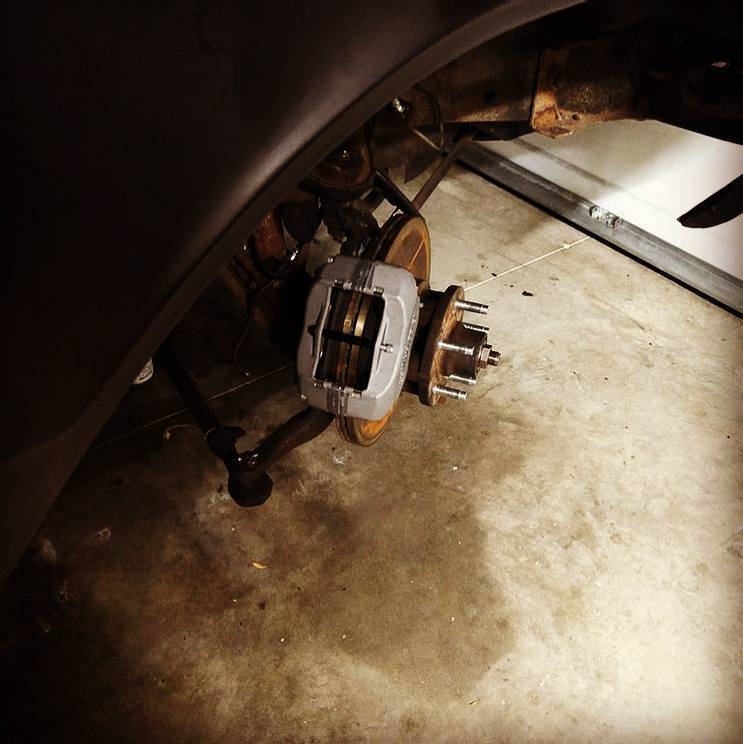

Yeah I converted to Wildwood from BUDD. But I'm also using 2014 Lincoln MKZ rotors. So there's a bit involved. If your rotors are good then the swap should be fairly easy. Should just need to make a caliper bracket.
The BUDD bolt spacing is 6"and 7/8s. The Wildwoods I used had 3.5" bolt hole spacing. But the MKZ rotors meant a 5/8" offset in my bracket. Factory may not require any offset.
Also I'd add, if you're going to go the Wilwood route, down grade to Drum spindles and ball joints then purchase the full kit.
