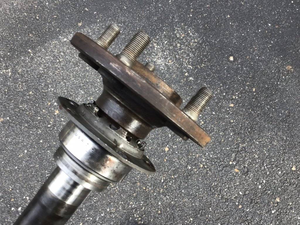

The lug studs and flange are one piece, they don’t come apart. That tool won’t be pulling the drum, it doesn’t attach To the drum on your car.

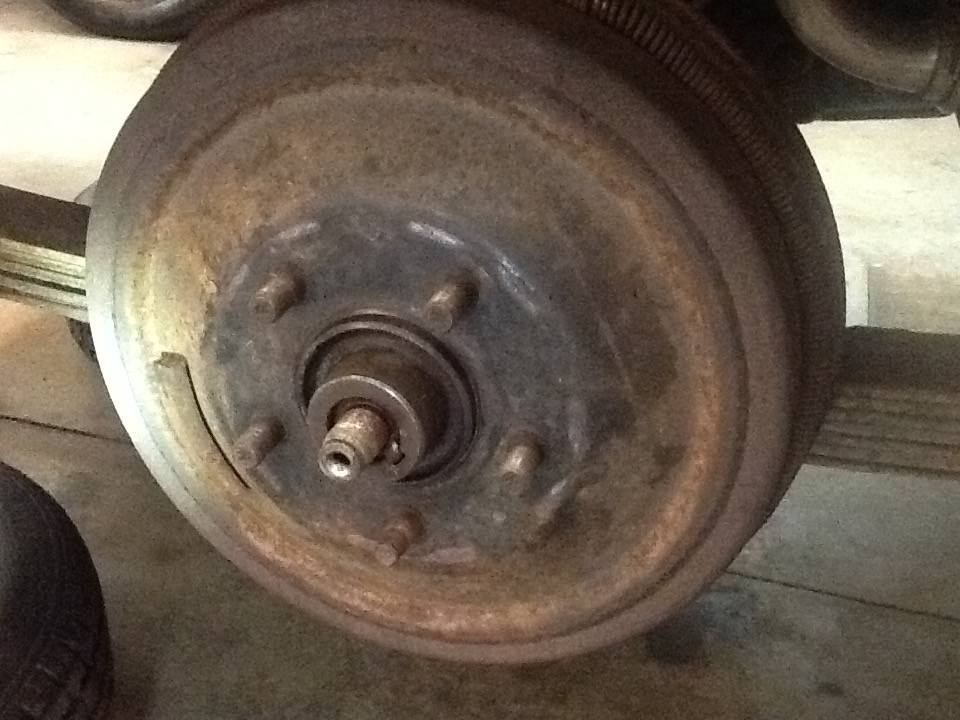

If you pull your back tire and you're seeing this, it's the older type that uses that tool;

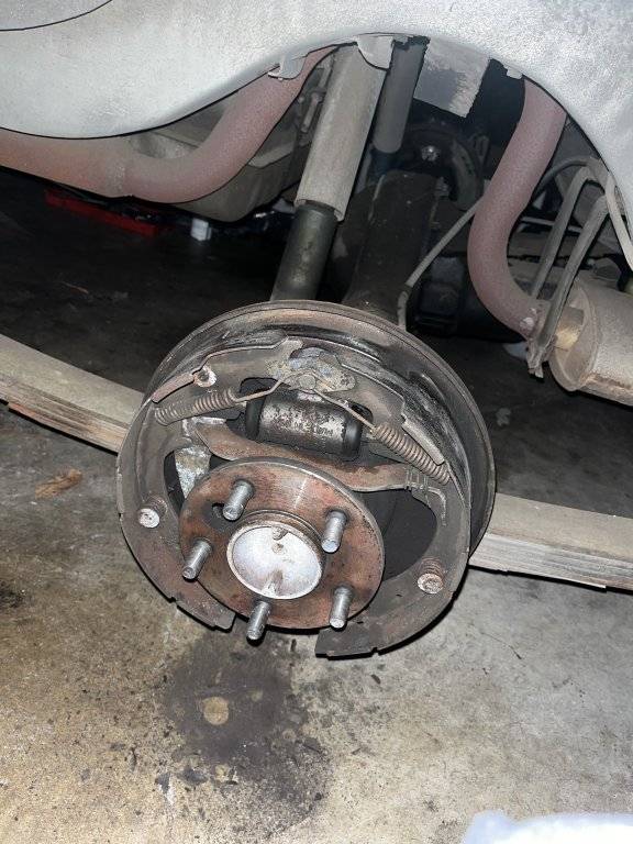

You should see this type on your '66 (or any '65 and later). Note the pic is after drum removal;
