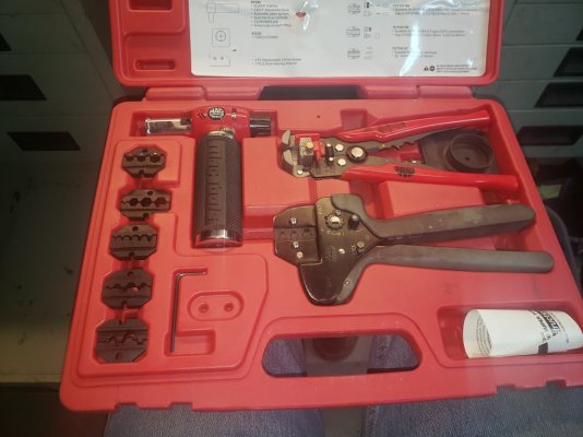

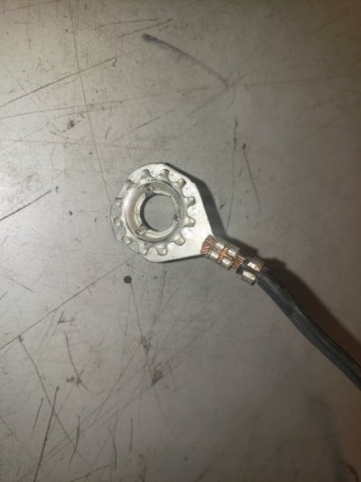

I bought this set from the tool truck years ago, it does the double crimp like oem . Terminals are a little hard to. come by not impossible .
That is the ticket.....and necessary if you want to use the plastic connector blocks, and new terminals. I am using the one I got from the painless folks.....works, but not easy. The biggest problem may be with the different types of terminals. The thin china crap is way different than the better quality stuff made here....much heavier and I think easier to deal with. BUT, there are many sizes of the dies for this type crimp, and as Mike said, you need to practice on the size wire and fitting you are using before the real thing. My main problem so far is that every wire is different size on the one connector, and I am losing hair....and have a long way to go on the new harness. Waiting on the new WireFy that is similar to the kit above.
