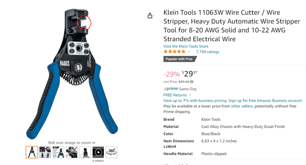

Here's a pic of the one @Big_John mentioned. Looks like a more automatic/updated of an older spring-loaded style from 15-20 years ago that somewhat resembled this.
I did not find the older version to work that well, as you had to get the wire in the correct-size die for a proper cut - all the thing really did was pull the cut insulation off for you.
But this one looks like it has more functionality, and I would trust @Big_John's endorsement.

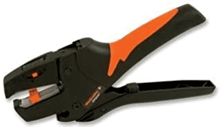

At my latest job where they have an electronics shop and do a lot of hand-assembly, they have these.
I had never seen such a type before, and was amazed at how well it works. They are ~$120, though.

It seems Klein still makes the older type of stripper.
I circled in red the dedicated die cuts for various wire gauges.
Put the wire in too-big die - it shaves the insulation.
Put in too-small - it can cut some conductors.
And for every strip, you must have your hand all the way open.
The Weidmuller I showed is much more ergonomic than this Klein type.

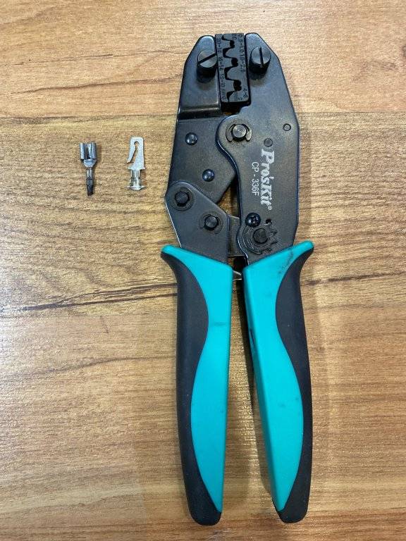

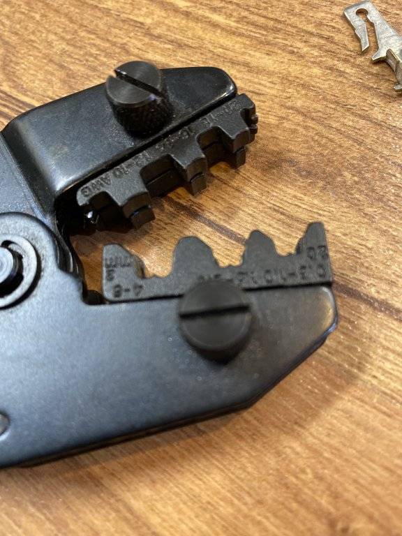

A little late to the party. But along time ago @commando1 put a link to these on a thread. I don’t have the link anymore but here they are. The brand I got is: Pro’s kit CP-336F. They have w double step to crimp the wire and the insulation for 10-20 gauge wire and terminals.

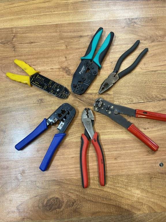

I have re-wired a few things and have the tools to prove it. (Missing my coax cutter and crimper).
I have one that looks just like this one and I can say it's an absolute PAIN to work with. While it crimps the terminals okay the big problem is that you're crimping between the handles and the pivot point. If you're crimping in any sort of tight place of haven't got at least a foot of wire sticking out it's going to be very difficult. Also, the stripper does look nice but is not built to last. Although that might just be on my cheap one so ymmv.
