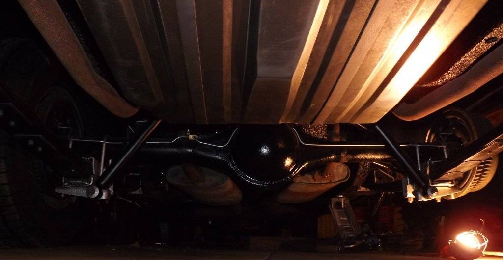

Just when Dereck shows pics of his new exhaust system in place i can report I just finished refitting mine this evening.

The exhaust looks like it takes the factory route. Very nice.
Yes it still uses all the original factory mounts too which I am pleased about, the only thing is doesn't have is the balance tube in the system. Not sure if I should go to an exhaust shop and have one put in or not yet.

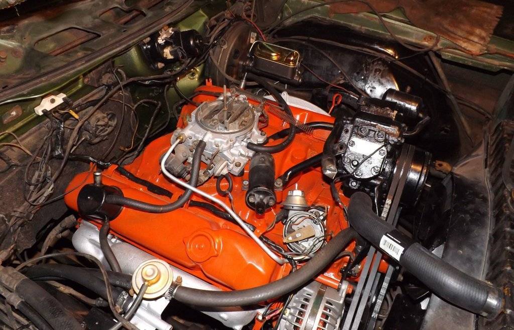

More progress, wiring, plumbing, fan belts, vacuum hosing etc. Doesn't look like it but there is hours of work there.

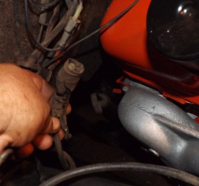

Okay, I put all the thin vacuum hose in its right place and it is all accounted for, then I find this, two vacuum hoses taped together at the end with a white connector slightly hanging out, where the heck does this go? I haven't a clue, can anyone let me know? Also, what colors are the wires for the negative and positive terminals on the coil?
Two guesses on the vacuum. One is the accumulator on the inner fender and the other is the time delay relay mounted on the heater box. That's below the ballast resistor.
Dark Blue to positive on the coil. Runs from the ballast resistor to coil.
No idea on the color of the negative wire going to the distributor.
The accumulator on the fender is all connected up, but i will double check the delay relay again.
