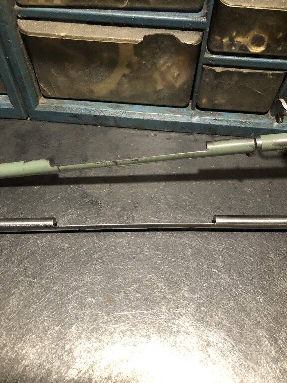

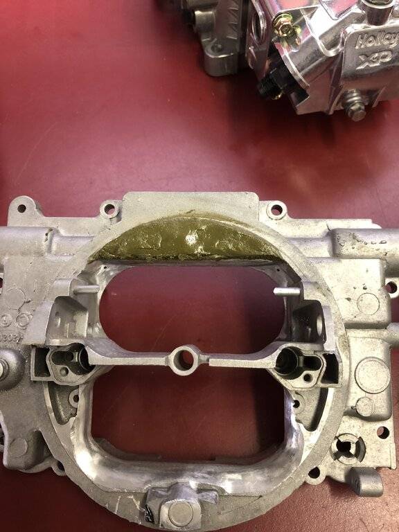

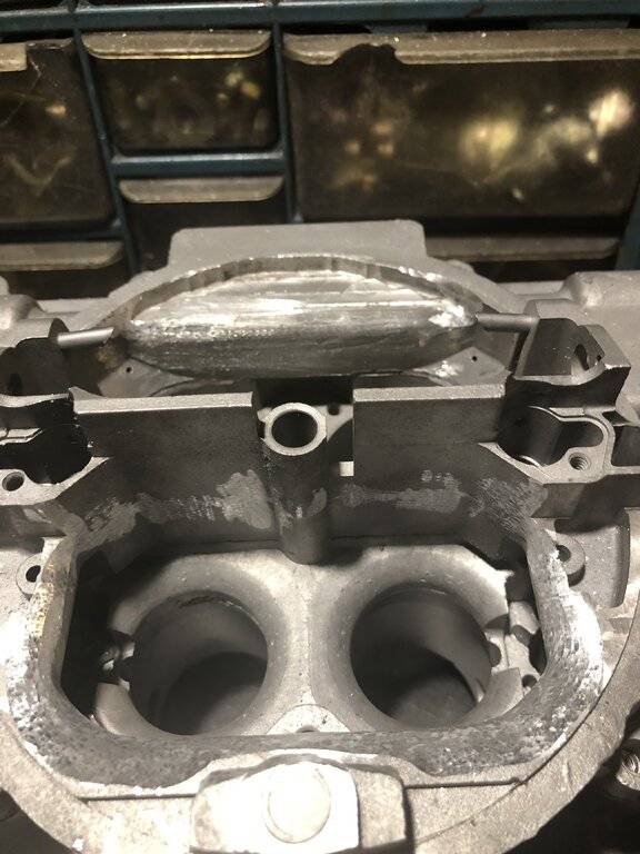

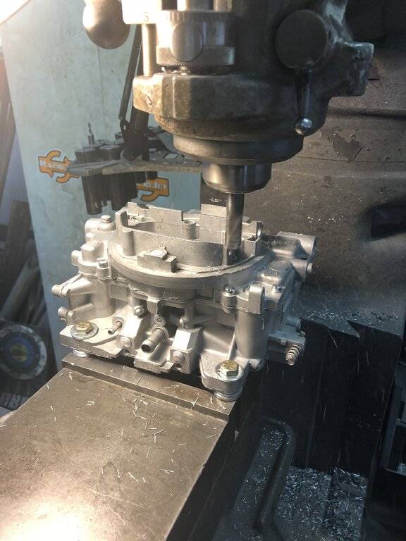

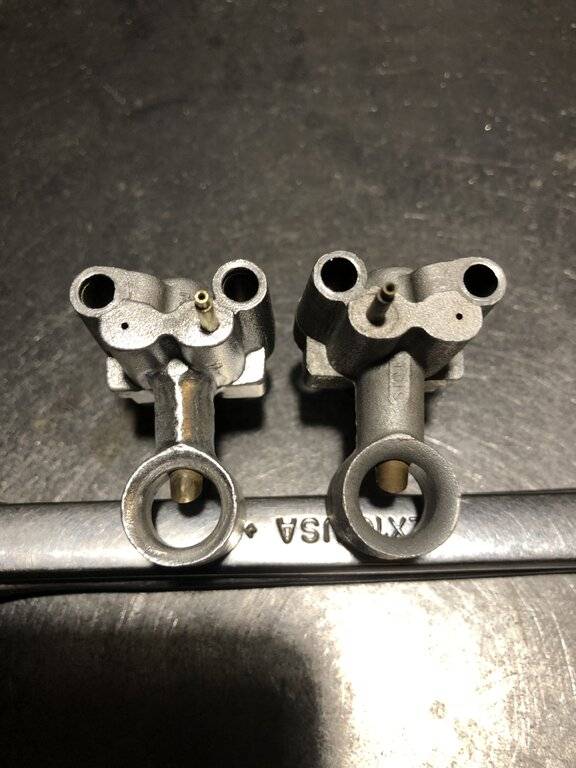

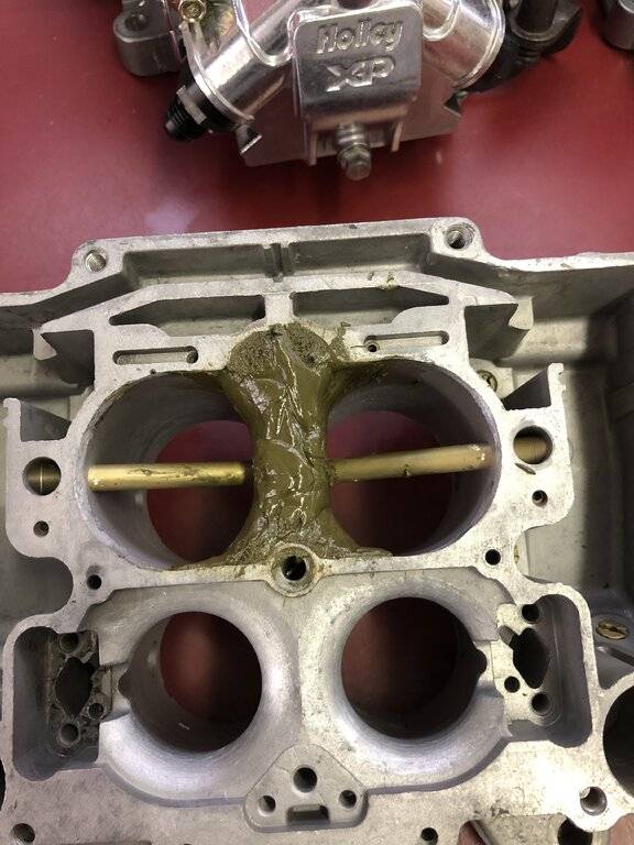

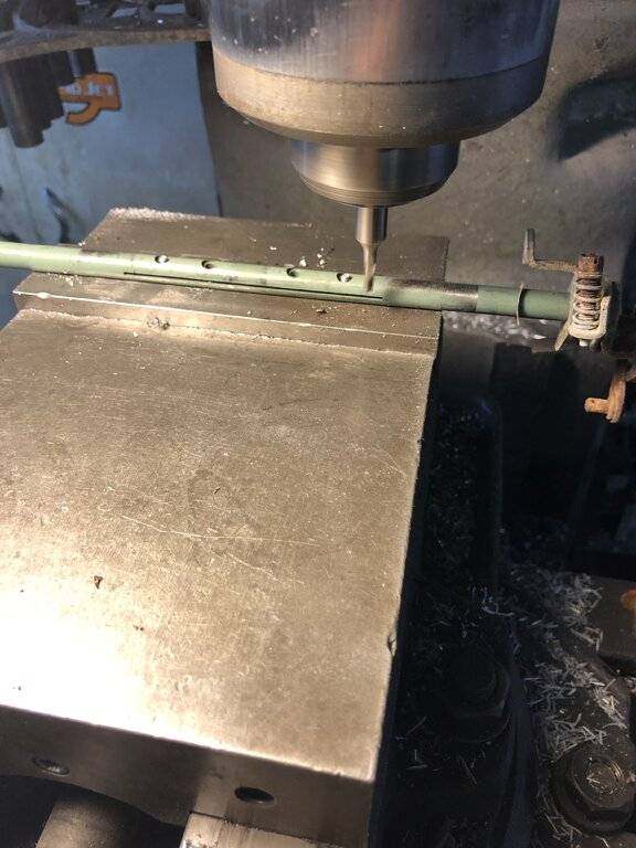

    Ok, back to Wyatt’s project. Milled off half of the throttle shafts, removed casting flash from the Venturis, and massaged them, molded some epoxy in the main body to kill a dead spot between the rear throttle bores, and we will do a little epoxy and blending on the air horn in the rear. Next I’ll thin the primary boosters and polish. 18EDC205-9F2D-4862-8FC8-1B83840BBFD0.jpeg 80C7086F-EF48-4D47-B06B-6DB6E73B350E.jpeg 7AC8F1A5-D48E-4078-B105-8E65DE305CB4.jpeg F2B229B2-8416-42ED-A025-1CD942899EA5.jpeg F78EFBCC-15F4-41CC-A261-A4E6402DB309.jpeg

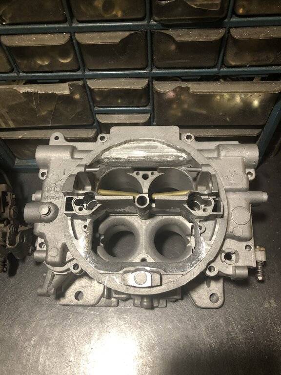

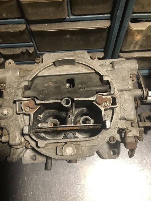

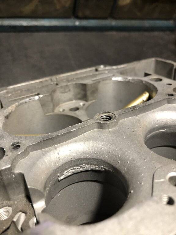

    Nothing crazy here, just a good cleanup. 0A53C230-EB40-4B76-8934-101FD9356C20.jpeg A51F79A4-F362-42C3-B05E-5F5A96ABE5BD.jpeg
