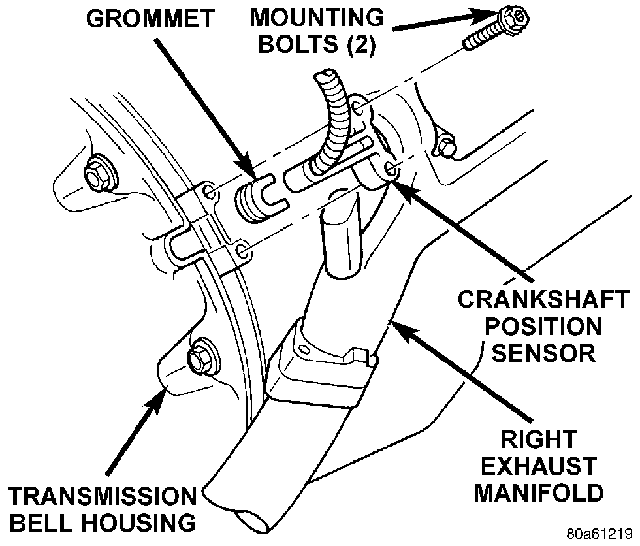

Are we talking 98 1500 with a 5.2L?
CRANKSHAFT POSITION SENSOR - 3.9L/5.2L/5.9L ENGINES
REMOVAL
The sensor is bolted to the top of the cylinder block near the rear of right cylinder head Crankshaft Position Sensor
  1. Remove the air cleaner intake tube.
  2. Disconnect crankshaft position sensor pigtail harness from main wiring harness.
  3. Remove two sensor (recessed hex head) mounting bolts Crankshaft Position Sensor
  4. Remove sensor from engine.
INSTALLATION
  1. Position crankshaft position sensor to engine.
  2. Install mounting bolts and tighten to 8 N·m (70 in. lbs.) torque.
  3. Connect main harness electrical connector to sensor.
  4. Install air cleaner tube.
