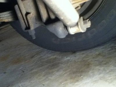

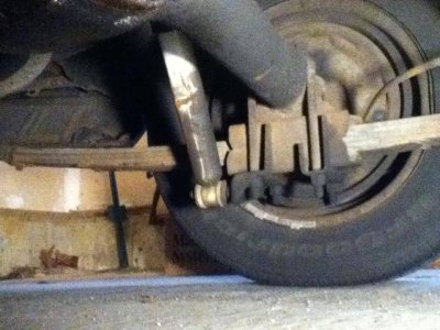

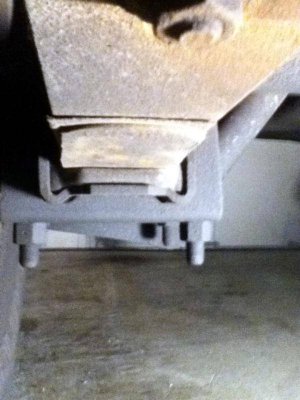

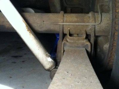

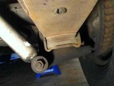

I am swapping out my rear springs for new ones myself. Speaking with Springs N Things vendor to secure new pieces (I think some here might have used them?). I am having problems getting the correct/proper parts as SNT says the brackets holding the springs are not "scalloped". Whaaa? Anybody else with Chrysler fuselage car run into this? SNT says this is particular to the Chrysler bodies as apposed to the Dodge/Plymouth fuselage models of the same year. Mistaken thought that small detail would be the same between Dodge Chrysler Plymouth. IMG_5655.jpgIMG_5657.jpgIMG_5658.jpgIMG_5659.jpgIMG_5660.jpgIMG_5661.jpg

I'm not sure what Scalloped part you're looking at.

Is the "scalloped" piece right where the isolator is? Unless yours is broken or damaged you will not need to replace any of that, you'll even use the same isolator.
The convertible doesn't have the isolator....and has a different size center pin
Yes, apparently part of that torsion quiet system.

Me neither. I've never seen what they are describing (scalloped bracket).
Do you know who does make the correct shackles? Laura is very nice , spent a bunch of time talking with her last week about this. She thought they has my springs, but this little issue apparently changes all that. They are saying this scalloped bracket doohiky came out on full size mopars (C bodies) in 1972. I have no idea what the hell that is, never seen a "scalloped" bracket holding the springs in place.

Looking at FirmFeel's website I noticed that their spring eye bushings are wavy or scalloped.
I also found Isolators from various vendors that have wavy or scalloped sides. this would not be clearly visible until they were removed.
One of you have a stand alone picture of this scalloped part you are talking about?
Gary, your springs and brackets look like what is under my 71...

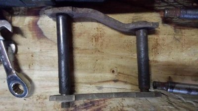

And to my research there is no reproduction shackles for our cars, unless I missed something . Laura was also surprised to see the shackles that we have. She has been selling people straight shackles without the offset and no one has said anything. My bolts snapped and I had to source used.

Just wondering if you could use 1/2 of the 2" offset shackles that Mopar offers?
