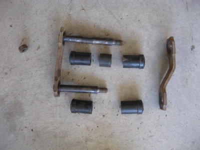

Why didn't you just take the nut off the top pin on the shackle? You wouldn't have had to cut it apart. It's a stud because it has a shoulder that the shackle bottoms out on to keep the spacing right for the rubber bushings.
One interesting thing I notice. The nuts are on the bent side of Gary's shackle and they are on the straight side of Dave's. Hmmmmm....
