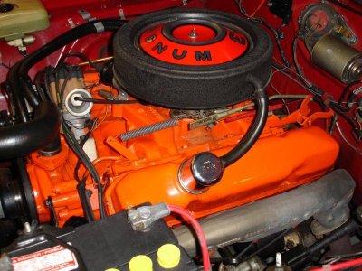

I did this mod on my 69 Super Bee...Under the battery tray and run the wires along the negative battery cable and tape or mini zip tie them to the cable . it was pretty stealth! DSC00311.jpgDSC00312.jpg

Love the picture of the Bee!!! Can we see a picture of the whole car? LOL!
