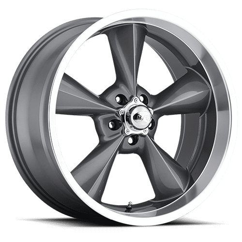

So, still looking for another set of wheels to ship over to Norway with the car to have a different look from the Magnum 500s that's on it now.
Have found a wheel we like but not sure about fitments. My buddy is concerned with the lack of space behind the fender skirts.
They come in 15, 17, 18 and 20 inches but we are only considering 15 or 17.
Will 17x7 fronts and 17x8 rears be a problem you think? They can be had with either 0 mm or +6 mm offsets it seems.
15s in 7/8 with is of course also an option but 17s will offer a different look. Might get beefier tires on 15s tho.
All tips and input is appreciated here since we should decide pretty soon due to shipping deadlines on the containers.

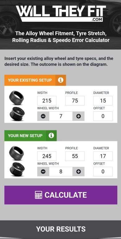

Can this list of alternative wheel sizes be trusted to be accurate?
Offhand, I'd say no. Most internet sources like that have errors. I think Tire Rack will have more accurate tire dimensions, but even that may have errors.
Realistically, the best way to figure out what would work is with something like this. https://www.amazon.com/BuliBoao-Sim...327&sprefix=wheel+fitment+tool,aps,126&sr=8-6

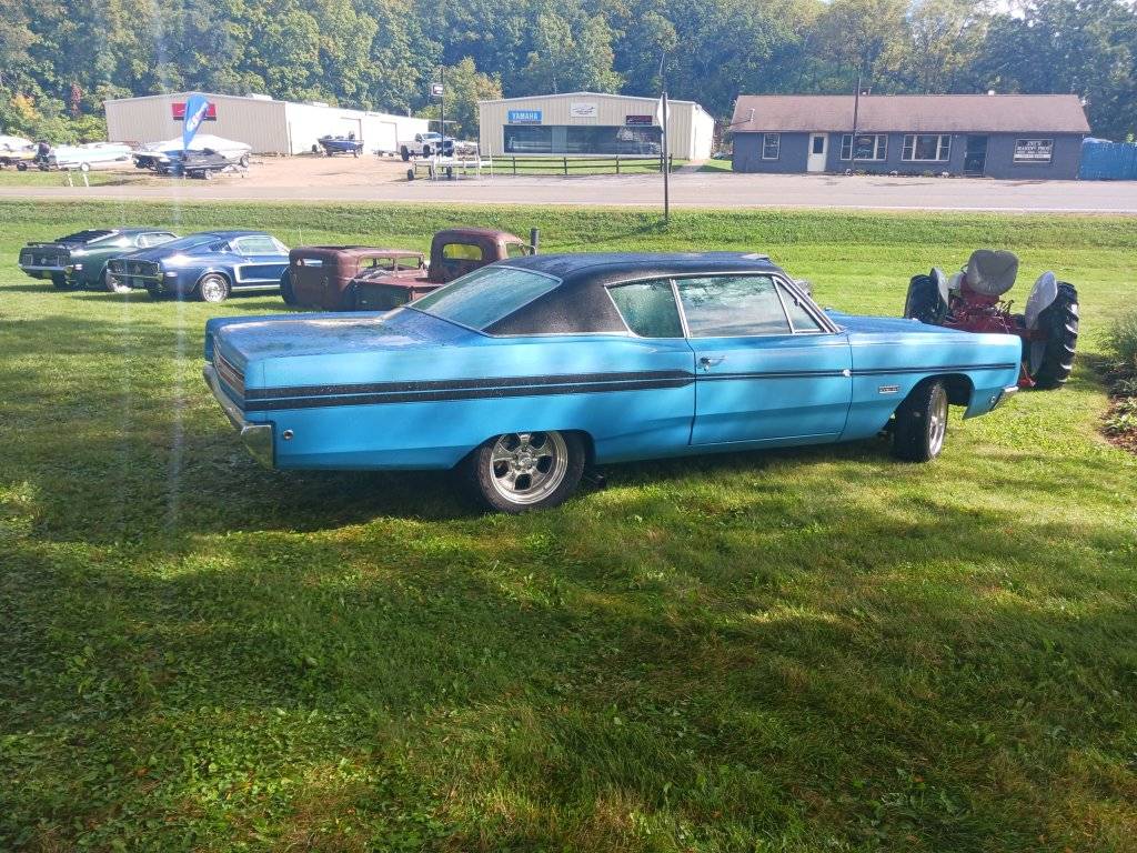

I currently have 275/50/17 on the rear with room to spare. Might go a bit wider when these need to be replaced.

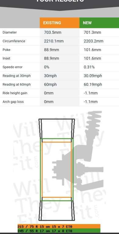

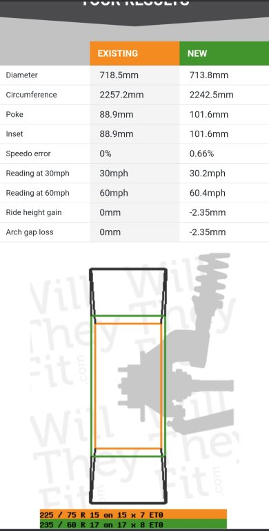

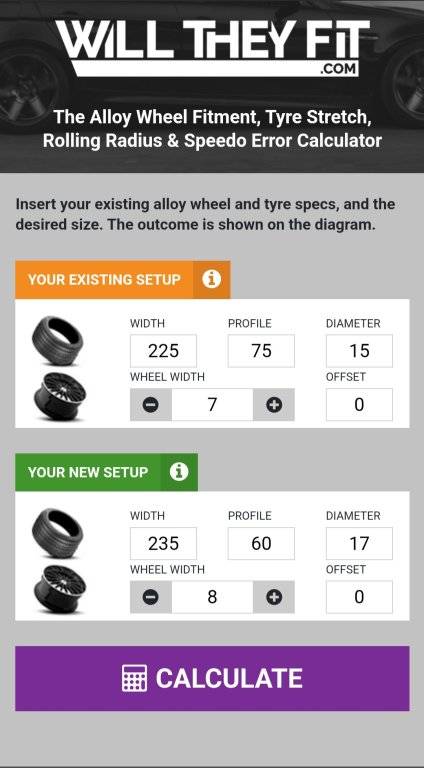

Did some size comparing and got these results.

It's just a list of tire sizes that all give the same tire diameter. It doesn't mention rim width.

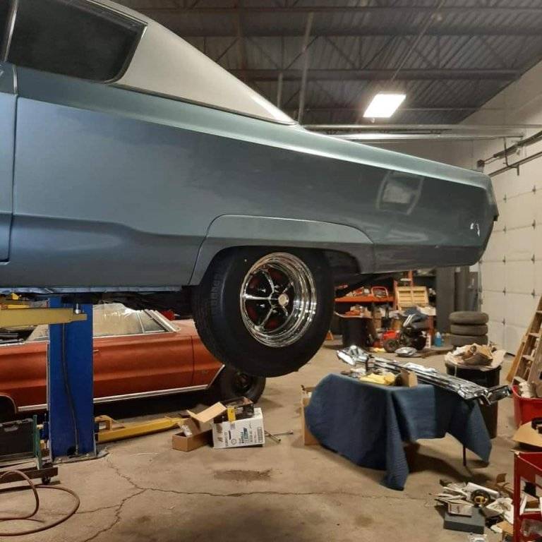

What I put on my '67 Newport was the 14x6.5" station wagon wheels with P245-70R-14 BFG Advantage T/As. They are tight in the back. Pretty much a 9" wide tire on the 6.5" rims. With the car on rocker panel area jack stands and the rear extension fully-extended on the shock absorbers, I had to wiggle the tire past the rear brake drums. Once there, no real issues. To me, anything wider would require the shocks to be unhooked and things gangle on the rear leaf springs. Just my experiences.

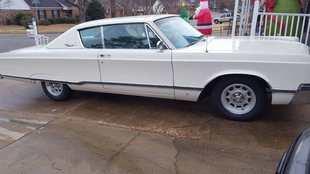

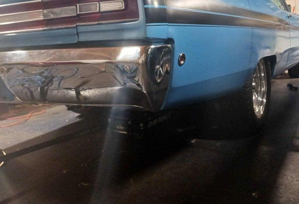

If I can find mine I'll check. I'm pretty confident they would fit.
Couldn't find the skirts. Sorry for the crappy picture, but I think it would be too close for my liking. I can fit more rubber under there though, once these wear out.
