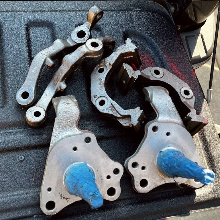

What you’re looking for is a 1976-1989 F,M,J body setup. The spindles are bolt on requiring very little modifications.
I scored this set for about $100, spent about $70 to have them sand blasted and now I have them painted satin canyon black. They look beautiful!! Waiting to get a 62 Chrysler to put them on…
I scored this set for about $100, spent about $70 to have them sand blasted and now I have them painted satin canyon black. They look beautiful!! Waiting to get a 62 Chrysler to put them on… View attachment 593043
Did you have to source backing plates also? I’m going to start my search locally after I figure out what car models go with these dang Chrysler letters F M and J.
Found a local J body 78 cordoba! That’s basically a bolt on setup for my 61? I mean the spindle should fit my upper and lower ball joints and tie rod ends without too much fuss?
That’s a B body but I believe those spindles are also the same actually. If the setup is complete, get it. The tie rods need to be shortened a little bit. I may have to end up writing a post both for my and other people’s future reference.
While you’re at it, get the proportioning valve too. You’ll need this for your brakes to work properly
Okay excellent, I’ll be going out to check out the car this week and see what’s left on it. And according to a site called Vans on the Google machine the 77 cordoba is a B body, another site calls it a J body. I’m confused, I just know it’s a full size in 77
73 and later B Body spindles are the same as the F,M,J body spindles. The setup will work for your 61.
You’ve got a Full Size Mopar. Not a C body, which started in 65. Yes, the setup will work but it is not a bolt on affair. There’s minimal modification to be made for steering clearance.

AAJ brake up in the northwest. Uses Cordoba rotor and Monte Carlo calipers. Work fine on my 61 300G and my 57 300C.
