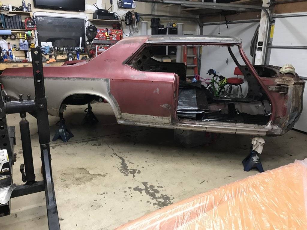

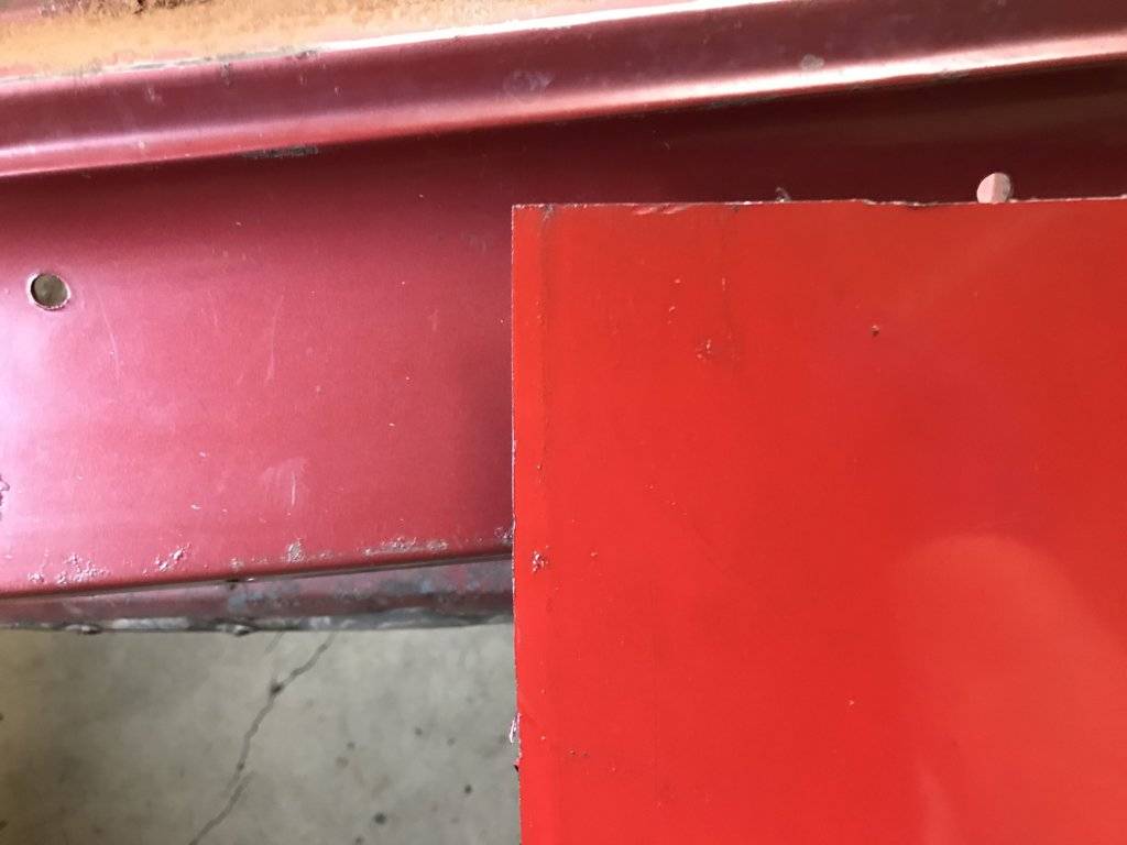

    I need some help guys, I am trying to track down a paint color for my Canadian 64 New Yorker. I had a paint code match on PP and PP-1 from a dodge book from 1965, and it was a "Ruby Red" - it's not the color. At this point, I believe that there are specific Canadian Paint codes for Chrysler for, at least, 1964. I believe some "Foward Look" guys have been through this as I found some content on someone going through this same search in 2006 but the forum looks to be incomplete and now archived. I'd like to go back to the shop who mixed the color with the right code when I take the paint back. I believe someone on here has to have a lead on this. Any help will be very much appreciated.

    PP is definitely ruby, but your car looks like its closer to TT which 1 name for it is roman red poly ( poly means metallic).
    get a paint shop to scan your car's paint and they will come up with the formula.
    it will take less than a minute.

    Any chance they can come to me? JK. I have a place chasing down the formula for the "T" AKA "Dark Roman Red" as after a lot of research that seems to be the color. If it's close I'll use it on the firewall and keep the search going before I paint the rest of the car. getting a part scanned is always an option - but I'd also like to solve this mystery. The only other 64 New Yorker 2-door body plate I've seen had a paint code of "GG" - G being another color missing from the '64 Chrysler paint ref. Maybe it has something to do with metallics, being Canadian only models. There have to be some Canucks on here that have been through this. This can't be the first time this has come up. Thanks for the reply marko.

    t roman red irid (met) for 64 chry , that panel you had in the pic looks like 63 chry p festival red . there is no p code in my rm paint book in 64 chry it has t roman red irid and r royal ruby irid . both colors were used on imp's n chry's .

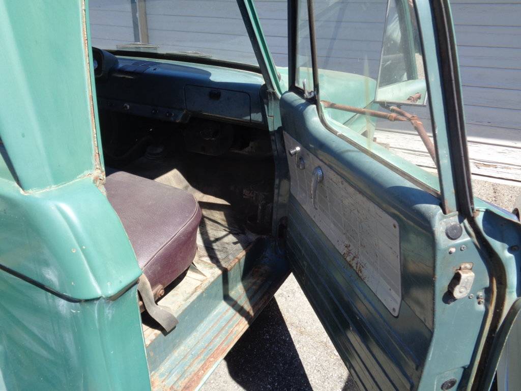

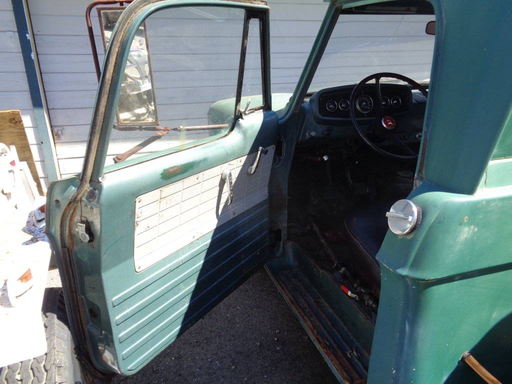

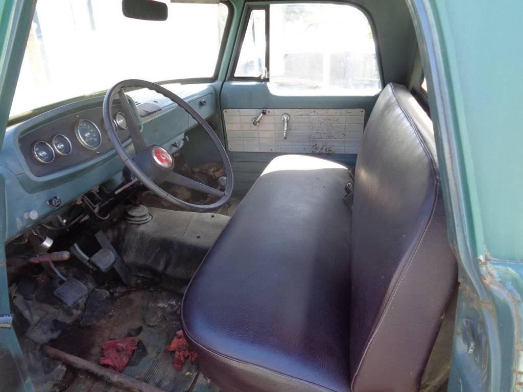

    bill watson , do you have paint chips on the pickups as well ? in that i just purchased a 61 d series pickup , and there are no paint codes on the pickup it self that i can find . but its a solid green on the interior still , and i was just wounding if you had the info to help me dial it in . its not bell green my color chip book only goes back to 64 on the dodge line of trucks . as you can see its got a repaint on the exterior . maybe a polish area and a better pic too . you can pm if you like . DSC01121.JPG

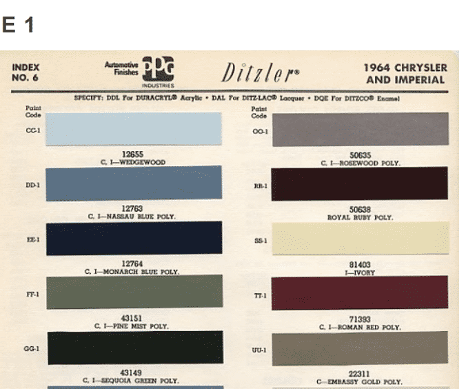

    see below, Dodge has 2 variations of TT

    thanks very much , it looks like turf green . inside factory colored . thanks again . DSC01120.JPG DSC01129.JPG

    The 1961 colour codes are :
    A - Black
    B - Marlin Blue
    D - Pine Green
    E - Nile Green
    F - Mustang Green
    H - Omaha Orange
    K - Sand Dune White
    R - Cuban Red
    S - Desert Turquoise
    T - Buckskin Tan
    If you check your 1964 book you should find all the above colours included for 1964. They were all used 1961 to 1965, with some colours added over the years.
    Any problems let me know.
    By the way, what years does you book cover and what paint company printed it?

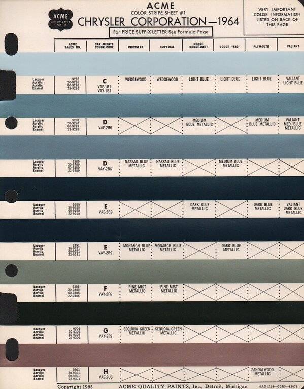

    Huron Blue Metallic (CIL - 2352-2283) was used by Chrysler of Canada, code EE, in 1965 and also in 1964, code EE. The colour was called Nassau Blue Metallic 1964.
    The Ditzler code for this colour was DQE-12656. As the Ditzler code has five digits, the colour is actually an American code. Plymouth, Dodge, Valiant, and Dart, but not 880, used this colour under the name of Medium Blue Poly, code DD. The Chrysler corporate code was VAE-286.
    Enamel codes used by paint companies for this shade -
    Acme - 22-9288
    Canadian Industries Limited (CIL) - 2352-2283
    Ditzler / Canadian Pittsburgh Industries - DQE-12656
    DuPont - Dulux - 181-96943
    DuPont (Canada) - DUM-979
    Rinshed Mason - A-1669
    Sherwin-Williams - Opex JO-JA-8665
    Hope this helps.

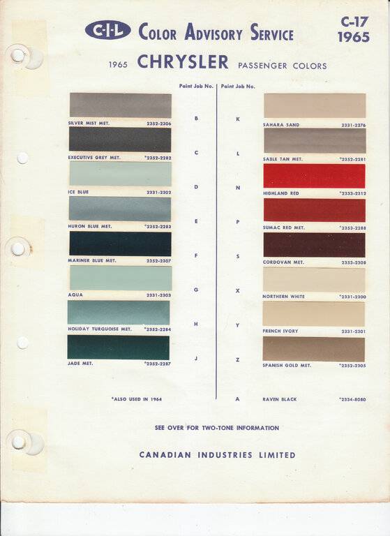

    This is the CIL sheet for 1965

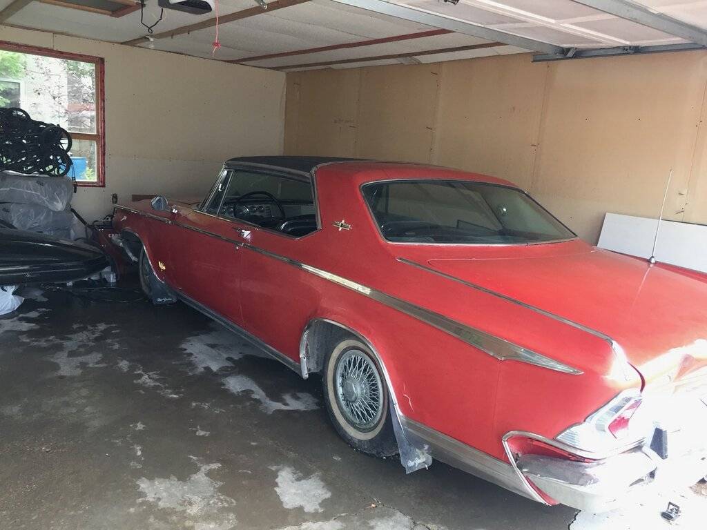

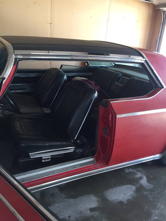

    IMG_0073.JPG IMG_0014.JPG Thanks for getting this topic rolling Angus, my '64's paint code is NN. The car is a Canadian build and a possible repaint, it looks suspiciously like the N code from the 1965 CIL chart that Bill Watson has posted. Bill can you shed any light on my '64 NN paint code? Also wondering if Chrysler had a build plant in Vancouver, for some reason I believe that where this New Yorker was produced.....thanks for any and all help : )
