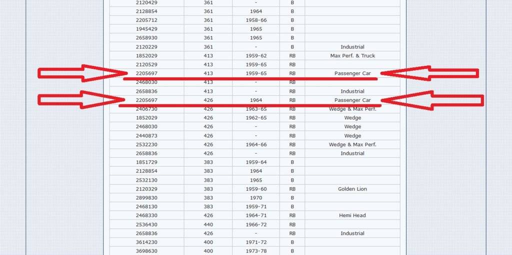

The # is 2205697-1 , so it SHOULD be a 65 block, correct?
That casting number was used for several years, look just below the casting number, there should be a casting date.
Dave
From what I see on the chart, it is a '64 426 , or a '59 - '65 413 block.
Look 4 spaces above also used for 413. Could be either since they both used that casting number in '64. Early production 426 engine were bored out 413's after the got better control over bore migration.
Dave
